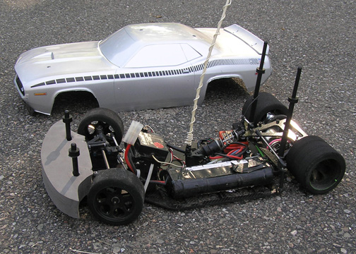

bearrickster was kind to hook me up with a roller so here it is at the beginning stages 8)
The body isn't really done yet and I still need to source a few items, but I got it running at this point with the spares I had laying around. More to come :mrgreen:

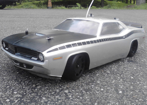

by teman

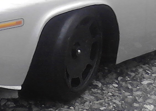

Finally finished the body. It's a combo of back-sprayed silver metalflake with 1st surface window-hood-spoiler vinyls and the stock decals all around. :mrgreen:

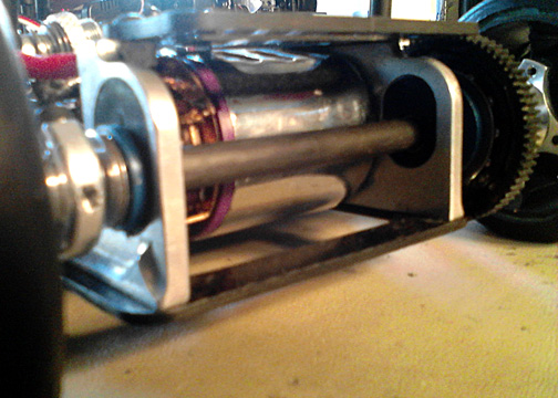

I received the checkpoint $ and it's in as of today - running pretty good. No clue what the gearing/rollout is or should be, but I'm working on it.
VCS micros are on order, but I rigged up some custom ball-end/threaded rod swaybars back there for now. Any further purchases are going on hold until I find out what the track classes are going to be :wink: Overall, I'm pretty happy with it so far 8)
Re: My new to me rc10 L3
Posted: Sun May 29, 2011 9:06 pm
by bearrickster
teman wrote: :wink: Overall, I'm pretty happy with it so far 8)
I am glad to hear that, it sure looks good. if I would have known the HPI bodies would fit it I would have kept it and sold one of my other ones. :lol:
but I am glad your happy with it.

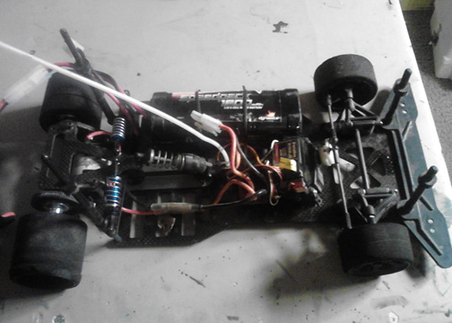

by teman

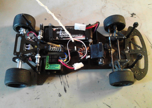

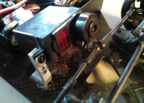

I received the team stand-offs, vcs micros of which are installed now and I swapped the new electronics from the rc12 into this car so it's running waaay better now. I'm only missing 1 other part - the right side nerf bar. Hopefully I'll find that some where and get it on :wink:
It seems pretty quick to me with the tazer 12t esc/checkpoint $ 19t combo. It might be geared a bit high for a track, but I think I could mellow it out a bit with a different spur/pinion combo.
I'm planning to do cups for the battery and they're on order, the zip ties aren't cutting the mustard :roll: I did upgrade to nimh for the time being. I may consider 2s lipo, but that will be down the road some since I want to work on the gold pan also.

I slung alot of stick packs out due to worn zip ties. I added one battery tray to the front end, zip tie on the back and have not lost another. Add a nylon nut to the screw for the nerf bar to create a side stop.

by teman
I was trying to save weight, but the battery cups are working good :mrgreen: I changed gearing from a 78/20 to a 75/23 and it smoothed it out some without loosing too much off the line - sooo fast waaay cool :twisted:

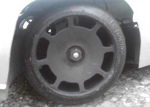

Scored a BSR capped tire lot - super stoked haha :twisted:
