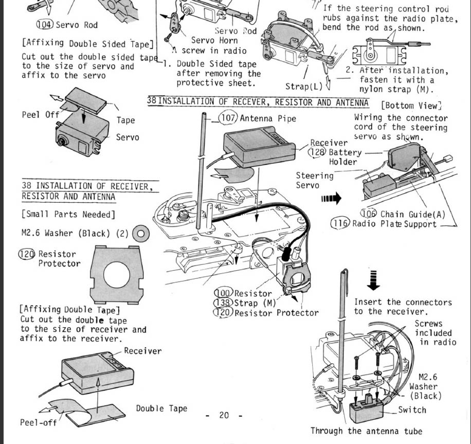

Per the original Optima and Javelin manuals, the resistor gets mounted on the left side of the chassis. See attached pic from the Optima manual. The Turbo Optima started the trend of mounting the resistor above the motor, which involved cutting an ugly hole in the Turbo Optima body (yes, I did it back in the day and it was a pain to "fix" when I switched to an ESC :x ).
slowboy: the resistor mounting point in the Optima and Javelin may have changed as production went on, or the original owner of your car saw the "Turbo way" of mounting it and decided to do it that way, which (cutting the body aside) is a better location as it probably gets much better airflow. I don't think you have a fake car. Although, can you posts some pics?

yeh, in that pic above that is how mine looks, it is one piece with a circle cut in it. the resistor protector mounts on the side in front of the left rear wheel.....the other optima i have mounts in the back above the motor but the resistor protector is a totally different design...it has alot of smaller holes and it is two pieces that sandwich the two resistors inbetween. the body wont sit right unless it is cut out for this. that is why i want to know if it is a stock piece before i cut the body or is it from another type of kit. i have not seen the piece in my original kit, only in turbo optima and ultima kits....any one know for sure or have a regular optima kit (NOT TURBO OPTIMA) that came with this piece in a later production????
