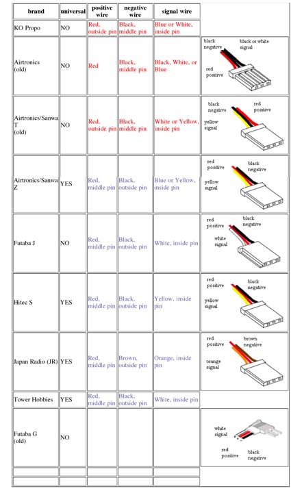

It will work, you may have to swap the connector pins so + > + and - > - etc. Here's a servo pin-out chart I found for reference.
