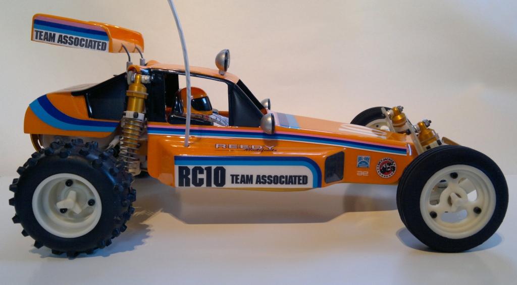

I'd go for vinyl cut out to correct width with scalpel / metal ruler and applied to the reverse everytime...
Trick is to rub it down really hard and leave 2 hours to prevent bleed-under (adhesive takes atleast a few hours to cure) before applying your paint...
pics of my gold pan showing the results, vinyl outside & inside the body..
