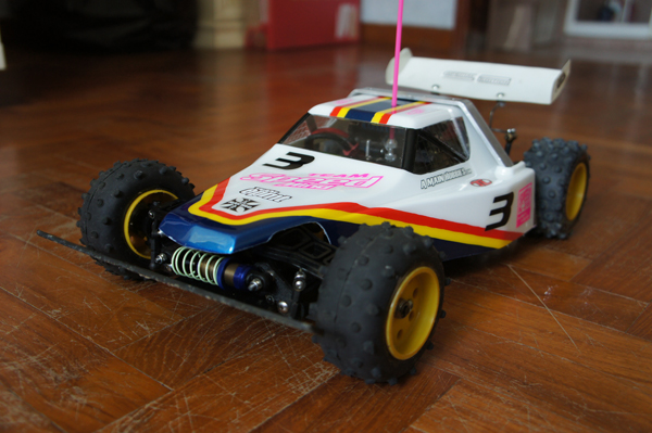

Wondering if there is anything similar in tread design to the Proline Road Hawg's that will fit an 834B wheel? Something besides off road spikes or foams.
Any suggestions you guys can offer? This would be for a shelfer, but I'm hoping to find something that isn't so rare it takes me 3 years of ebay searches before one appears.

Did I stump everyone? Maybe a picture of the style I am looking for will help (picture shamelessly borrowed from sho-dog's gallery thread).

Proline made a road hawg in a 2.0 size but they are long disco'd. Here they are on my 834 with 2.0 wheels.

Wow, that´s a sweet thing.shodog wrote:Proline made a road hawg in a 2.0 size but they are long disco'd. Here they are on my 834 with 2.0 wheels.

Original 834b yellow wheel size is 1.70" and the Mini-Mags have a 1.75" and a 2" that is in the 2 bolt Yok pattern, I'm not sure if they made a bigger wheel but you start to get a wheel that's slightly out of scale if you go too big.

Thanks, yes, I didn't know the diameter if I'm being quite honest. I have the yellow Yokomo wheels pictured here but I didn't know the sizes. So based on that, will the tires others have suggested (Brat tires) not work on these smaller wheels? The 2.0" Road Hawg's won't, but I guess I was hoping there was a smaller/similar tire that would fit these.a01butal wrote:Original 834b yellow wheel size is 1.70" and the Mini-Mags have a 1.75" and a 2" that is in the 2 bolt Yok pattern, I'm not sure if they made a bigger wheel but you start to get a wheel that's slightly out of scale if you go too big.
Sorry for the confusion, but thanks for the help guys!

The Yellow wheels are at about 1.75", actually pretty much the same as RC10 jelly beans without a beadlock.
So 1.75" Tamiyas (Rough Rider/Brat/F150 srb/Holiday Buggy) will work with the beadlock cut out. Anything intedended for RC10 Jelly Beans will also fit.
You will also be able to stretch 1.5" wheels (Tamiya Sand Scorcher, Super Champ, older Kyosho wheels etc). There are foams out there at 1.5" too.
In each case, those Yellow Yoke's are wide, so there will be a strip of yellow plastic visible unless you force most tires to be wider with the glue (or actually trim the yellow plastic narrower - more appropriate for a runner). Here's a good illustration...
And I just checked. All the Mini-T and 18T tires designed to fit stock wheels are 1.45", so they would stretch 1/4" but sorta fit. Depending on the particular tire shape/design, and with foams to keep them from going concave, they might actually look ok on a shelf.
