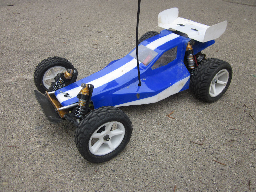

Below is a build of my gold pan with homemade rear bulkhead, and B4/SC10 transmission. The B4 transmsissions are much cheaper and easier to find, and the bulkhead wasn't too bad to fabricate!

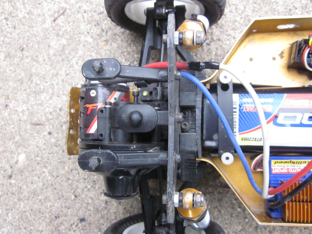

The core of the installation is a carbon plate that the trans is mounted to. I cut out the square hole in the carbon plate, and mounting screw holes for the rear of the trans. Added more holes to clamp the plate between the chassis and rear arm mounts. This also accomodates the slight height difference of the outdrives between the stealth and B4 trans.

View of attachment method of trans to gold pan.  Trans is screwed to carbon plate.  Carbon plate is held down by rear arm mounts.  NO HOLES IN GOLD PAN!

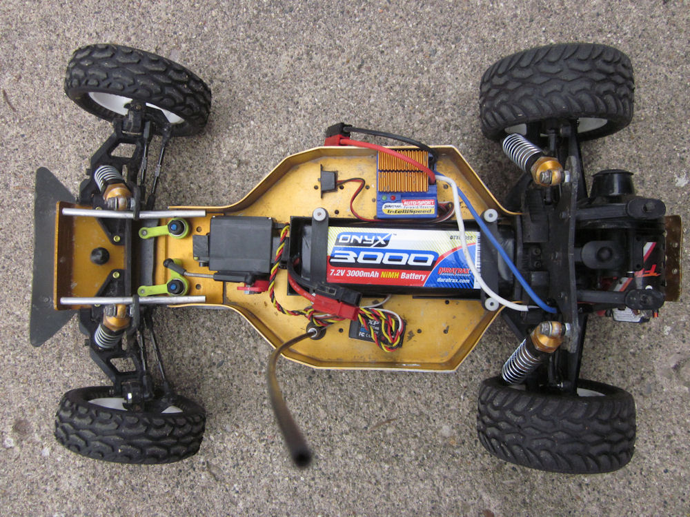

Top view - axial layout of bulkhead.  Bulkhead was made from 3/8 nylon strip.  Shock tower ended up on back for proper alignment with rear arms.  I think I will mill the next rev.  RC8 Body Mount

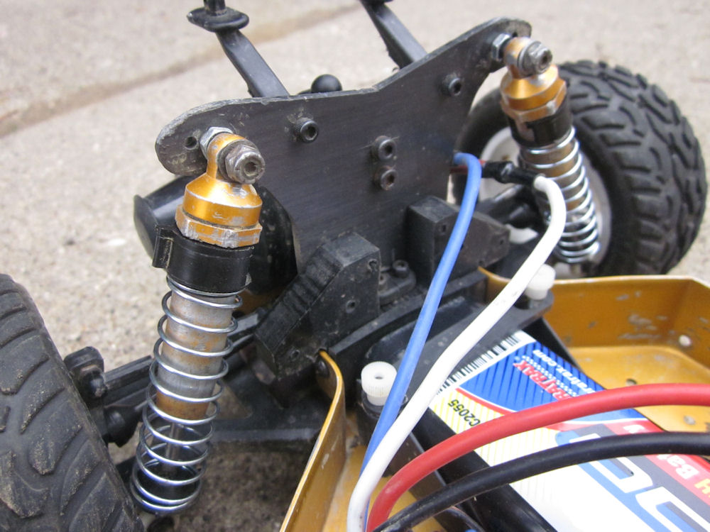

2nd view of trans attachment to bulkhead.  Top shocktower screws are slightly widened to accomodate trans mount screws

As sc8p mentions, bulkhead is where everthing attaches. It's the black piece with the rough edges The rear bulkhead is significant in this case for two reasons:
1. No longer available from AE or aftermarket
2. A modified/machined stock rear bulkhead probably wouldn't line up with the holes required for the front of the B4 trans.
As mentioned in the original post, the rear bulkhead wasn't too bad to make. I purchased nylon from McMaster-Carr, then cut it out with a wood band saw.
Only catch (you can see it in the pictures - top view), is the 3/8" nylon does not quite reach the chassis screw location. I tried to bridge it with an additional plate, but it didn't work. Next rev will either start with thicker nylon, then mill down. Or, start thinner with thick interface blocks (trans and front chassis screws).
