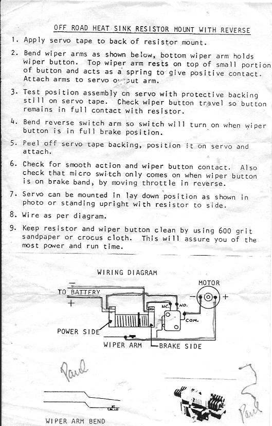

gomachv wrote:....It will be even more fun to wire it working off memory and principals! Lol!
In case your memory and principals fail you, I have a couple Parma's myself, and one even has the instruction sheet:
Re: Early racer build; could use some recommendations
Posted: Wed Apr 10, 2013 2:45 am
by GoMachV
O, that's much easier! Thank you!
Posted: Wed Apr 10, 2013 2:51 am
by Y'ernat Al
gomachv wrote:O, that's much easier! Thank you!
No problem. I suppose I should put it over into the scans too. I have no idea who Paul is btw. - Brian
