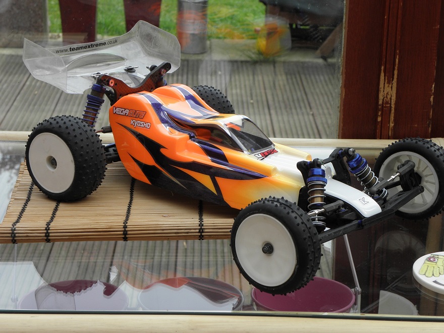

Team Xtreme Vega Elite
Posted: Tue Aug 30, 2016 5:16 pm
by LurkingCAT
Team Xtremes “Vega Elite” 2WD race conversions were made for several of the top-end race buggies (AE B4.1, Kyosho RB5/6, Tamiya TRF201, TLR 22). Featuring a CNC machined 7075 alloy tub chassis & gearbox, motor plate heat sink, rear shock tower, bodyshell and more. Team Xtreme claimed better cornering, increased in-air control, more level jumping, quicker landings and “a new more positive feel to the car, allowing for a more aggressive driving style”.
GEN 1, introduced Jan/Feb 2011, standard wheelbase. (RB5, B4.1, TRF201)
GEN 1 Body
GEN 1 AE B4.1
GEN 1 Kit (This one for the RB5)

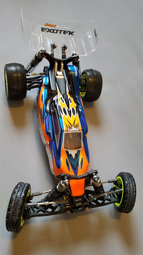

My Vega Elite GEN 3 for TLR 22.
Initially I started out using this as my modern 2WD runner. As things are with Team Xtreme nowadays (no parts available) I've rebuilt it to freeze it as a document of this platform.
I really love this car, the finish and design of these parts are very good! Everything bolts in perfectly - if you've tried out a Vega Elite kit you'll know what I mean.

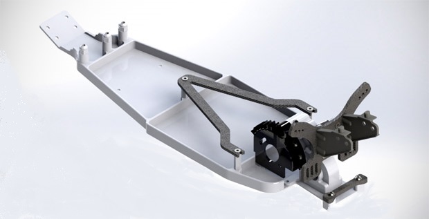

The start - Vega GEN 3 chassis
Chassis with optional weight kit. This I think is a piece of art :-)
Hot Racing alu servo Mounts
Team Losi Racing 25° front brass pivot (50g)
Exotek steering VER.2
Rear end. For this mid motor conversion you need to use the plastic insert from the rear motor layout to bolt the front hanger and anti squat shim to the chassis, as the block is not sandwiched between the gearbox and chassis plate as usual on the standard mid motor 22
When driving this car I used gear diffs, both AE and the losi one, not being happy with any of them. For the shelf now rebuilt with ball diff - at least I know it's in there...;-). Gear box built to standard specs with HDS slipper clutch and grooved slipper plates
Vega Elite machined gear box. As you can see the motor to axle position is tighter than standard so that the diff sits far back in the wishbone.
To get the motor back and maintain a sensible amount of driveshaft sweep the rear wishbones need to be flipped (left to right/right to left) to make room for the motor further back. Both the washers/spacers are put at the front of the wishbone so they are spaced back as far as posssible. The ball stud on the hub should be placed in rear row to achive a straight line. Also fitted with 4⁰ low roll center toe plate, Hot Racing aluminum rear hub carrier and aluminum wheel hex +0.75
Front end with Hot Racing aluminum front bulkhead and camber block. Exotek 5mm carbon front tower. Trail = 4mm offset, Caster angle = 5⁰, Kick angle 25⁰
