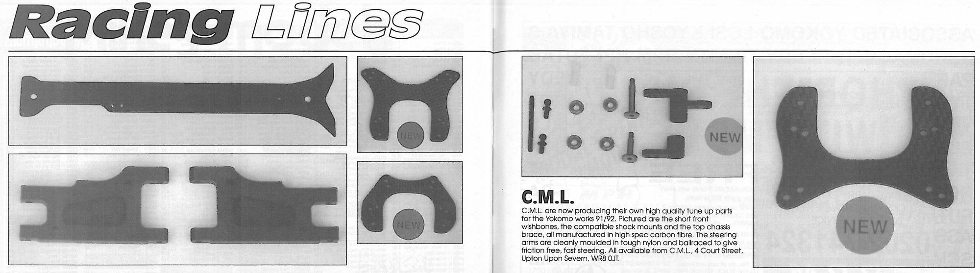

I have listed below the Drescher Edition modifications and also some Team parts that came on this 'Drescher Edition'-
CML11: Yokomo Short Front Wishbones. Uses Kyosho OT55, Kyosho OT16 and CML02s Short Tower for improved steering.
CML02s: Yokomo Short Front Shock Tower
FAST27: Machined Nylon Left Side Steering Bellcrank. One piece design eliminating the servo saver spring system of the stock bellcrank. Fully ballraced.
CML15: Yokomo Rear Stock Wishbones. Manufactured from high grade nylon for no flex and improved performance.
MMS Y1: Machined Nylon Front Bulkhead. A popular option part used on many Yokomo's not only in England but throughout Europe.
Heatsink Motor Mount (possibly MMS Y3): A lovely item especially for the time. A popular part in the European racing scene. A true functioning heatsink.
MMS Machined Nylon Rear Bulkhead: This car originally came with an aluminium rear bulkhead but I swapped it out for the machined nylon version. I have had this part for a while and thought this was the perfect car to use it on.
Custom Chassis and Top Deck: I do not know the origin of the chassis and top deck. The design and geometry of the chassis is identical to the Works '91 chassis with the obvious exception being the cell layout/configuration. I vaguely remember reading a Hansell Composites advertisement in a Radio Race Car magazine about a Phil Booth designed chassis for the Yokomo with a revised cell layout and custom top deck. Maybe someone here on 10Talk has seen this chassis and top deck configuration before?
It was a real pleasure assembling this car This was essentially CML's and Craig Dreschers answer to the stock Works '91. As you can see, there are not too many parts from the original Works '91 left on this car. Thank you Slow Jun for helping me load the photos correctly. I Hope you enjoy them.
