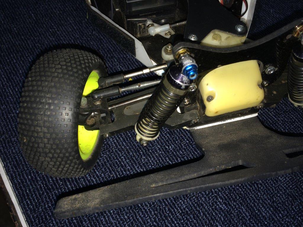

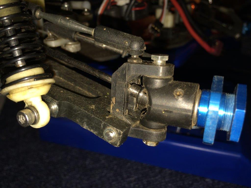

So after getting my old Yokomo out of storage and giving it a light dustoff, I though hmmm these cars are fairly rare so maybe I should try and find some parts or a whole 2nd spare car for replacement bits...great idea...as I still really had not much of an idea of the timeline of these cars and the different mods etc I found a car in the UK that was listed as YZ10/91 so I had a look and won the bid...from the untrained eye it looked like it would be fine for parts...ANyway over came the car and I was excited and when I opened up the box I thought cool...problem was, I got a exactly what was listed, part yz10 part 91 and part 92..! so some of the parts would fir and a lot wouldn't ...anyway I gave it a quick clean up..put some lipos and a brushless engine in and away it went...seemed to run fine until until I stripped the spur on the TCS..yes it actually came with a TCS (I didn't know what that was back then) the spur was fairly worn anyway...little did I know what a bugger it would be to try and find a replacement! anyway that's when the 'other' cars came into the picture (see yokomo no 3 and 4..!..yes I had been sucked into the Yokomo trap and didn't even know it yet...!)
Anyway this is what I ended up with, as you can see...its a bit of everything...which was good I guess in the end..gave me an excuse to convince myself to 'get more'! You can see some of the good stuff it came with...drescher front arms,91 top deck, 92 shock towers (1 in carbon fibre) TCS and the rest was mostly YZ10 and a YR4 front bulkhead...
I had put the Suzuki hubs and JC wheels on as they cam with an older white set of JC wheels and standard 91 hubs

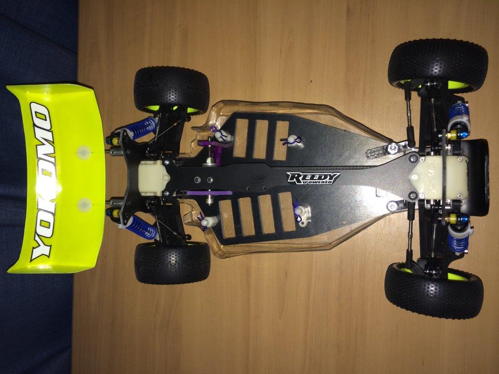

so the transformation ..... turned out something like....

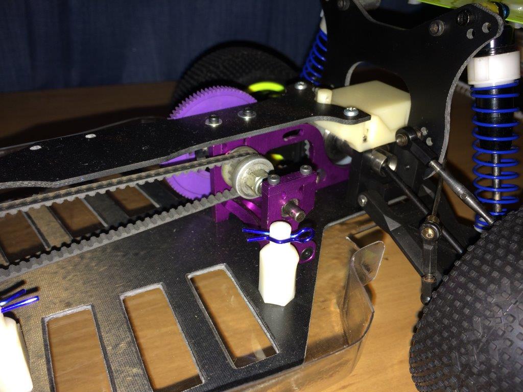

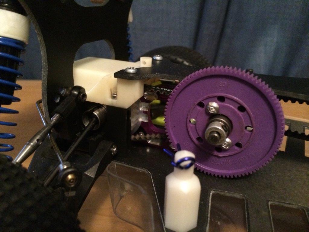

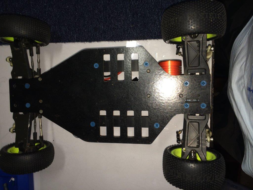

this....not 100% but a lot better then it was I think....only had YR4 bulkheads and all black ball cap ends, steering setup etc but I still think it came out ok. very solid in the front end now which is great. Enjoy and please feel free to tell me what is not standard 91..besides the shock towers, bulkheads, c hubs (93'), turnbuckles, (I do like these one though..heli ones I think?)
Sorry not the best pics...still gota sort that out...

It would appear that you have at least upgraded this one to a '92 Works spec, by which I mean the upper deck, lower deck, and shock towers (you already have the rear hubs). The upper and lower deck are the same between the 91 and 92, from what I've been able to tell, so it's really just a matter of the towers, rear hubs, and belt pitch. You clearly have other goodies on here, so it is of course not a stock '92 Works, but you do have all of the correct geometries for it.
Very nice work, btw. Nice and clean. I presume you got that purple motor mount from Hong Kong off of eBay? I just ordered two of those. They are exactly the same as the Suzuki motor mount, with the exception of the color (the Suzuki mount is blue). I am guessing that somebody decided to make a repro version of the Suzuki mount and anodize it in a different color. I plan on taking at least one of them and removing the anodizing to bring back the aluminum in its original color. I'll put that into my '91 Works. I have not started a thread on that one yet, as I am waiting on a response from Fibre-Lyte. They do not have any '91 Works parts in their catalog, but I offered to loan them mine to map them out...

Great looking car Flu. Not sure about the purple mount though, screams 'HPI' to me!!! Although it complements your pink spur.....
