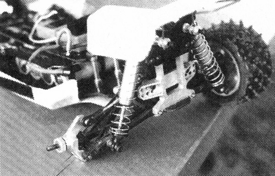

I don't recall ever seeing one as the bulkhead and suspension bracket need to stay in place for toe and anti-squat purposes.
I did a mid motor oval version with a direct drive a while back by cutting and modifying the rear suspension

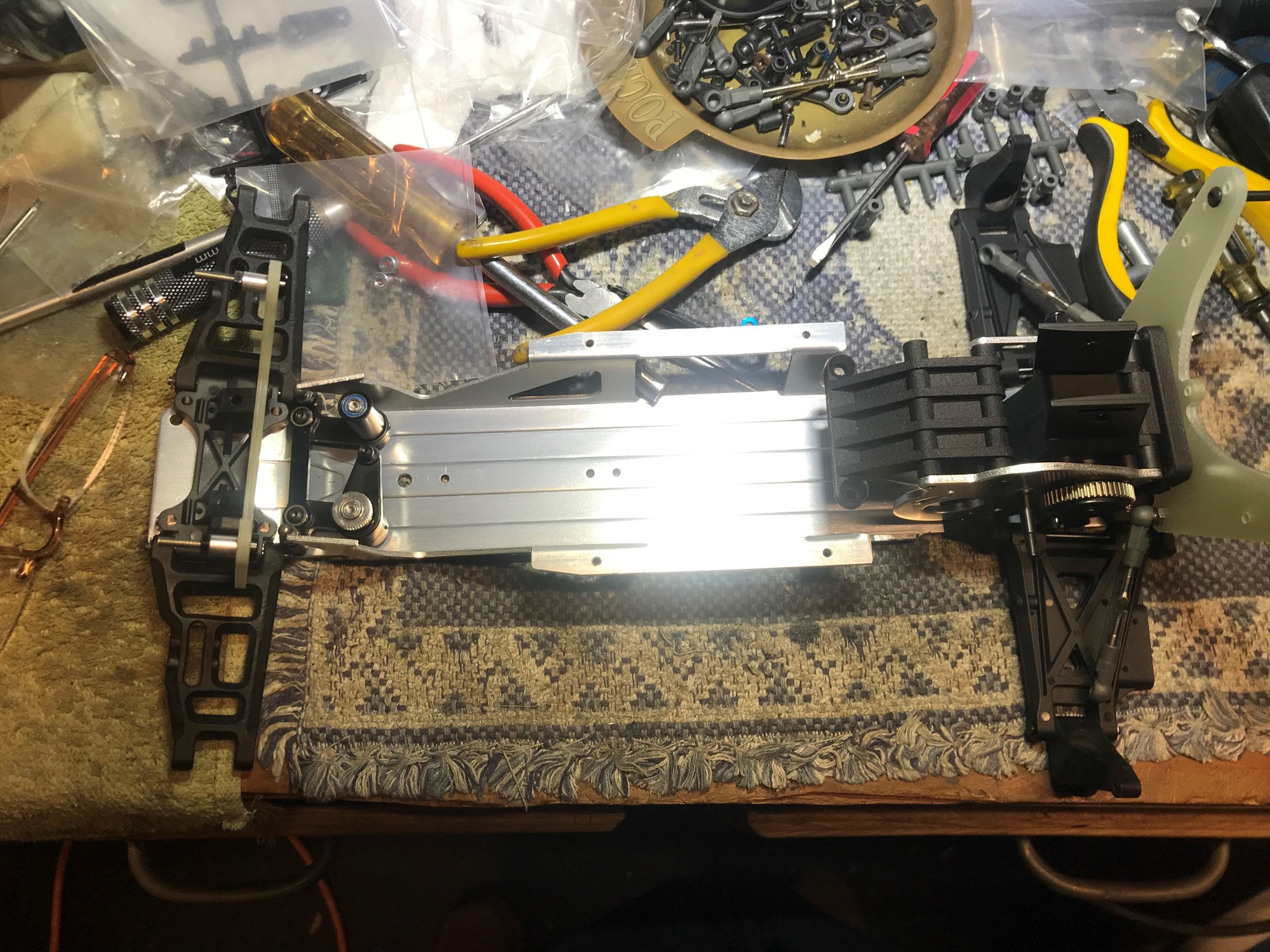

That's a good mod; or you can convert an Optima Mid quite easily to RWD and make-your-own mid-motor RWD car:

good call aaron! that reminds me....Bo Wallen's custom off road mid motor Ultima...
http://www.rc10talk.com/viewtopic.php?f=30&t=27785
