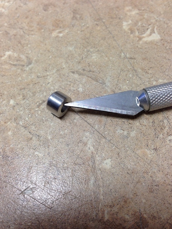

I just need to split it in half now. The shaft should begin this weekend- out of aluminum. Once I can mock it up, I will try it in steel. The cross drilling and flats will be the next big challenge, as I need to make fixtures. The schumacher slipper shaft will take a bit longer yet as it's more complex than the associated.

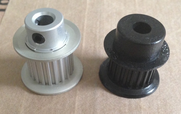

Well...that took a while! Finally got my pulleys. Plastic for the center roller and two aluminum for the rear drives. Now I have to do some measuring and get them to fit between the plates. The end on the plastic will be cut off, and I may have to knock down the pulley flanges as well. These have a 3/16 bore so the slipper shaft will be easier. Bearings will ride on the pulley where the setscrews are, after they are turned down to 8mm
