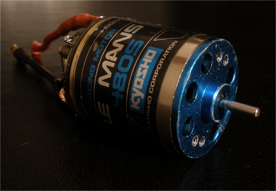

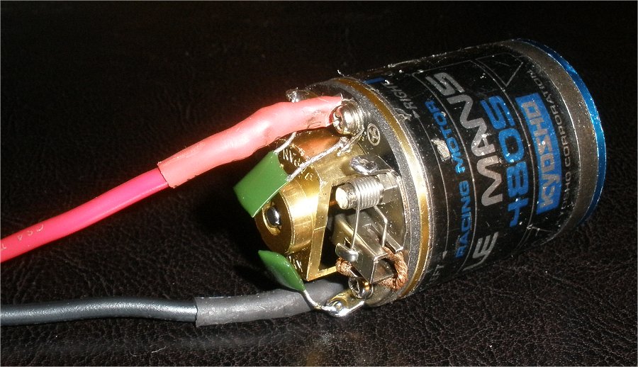

Here is how it turned out...480S can, brand new 240SB comm inside, and gold end-bell, from either a 360 or 480 Gold. New wires, 3.5mm gold bullet connectors and condensors soldered on. I'll call it a Kyosho Le Thing.
Should be interesting to see how it runs in a 1:12 onroad chassis with a 3.7V LiPo (half of a saddle-pack)...
