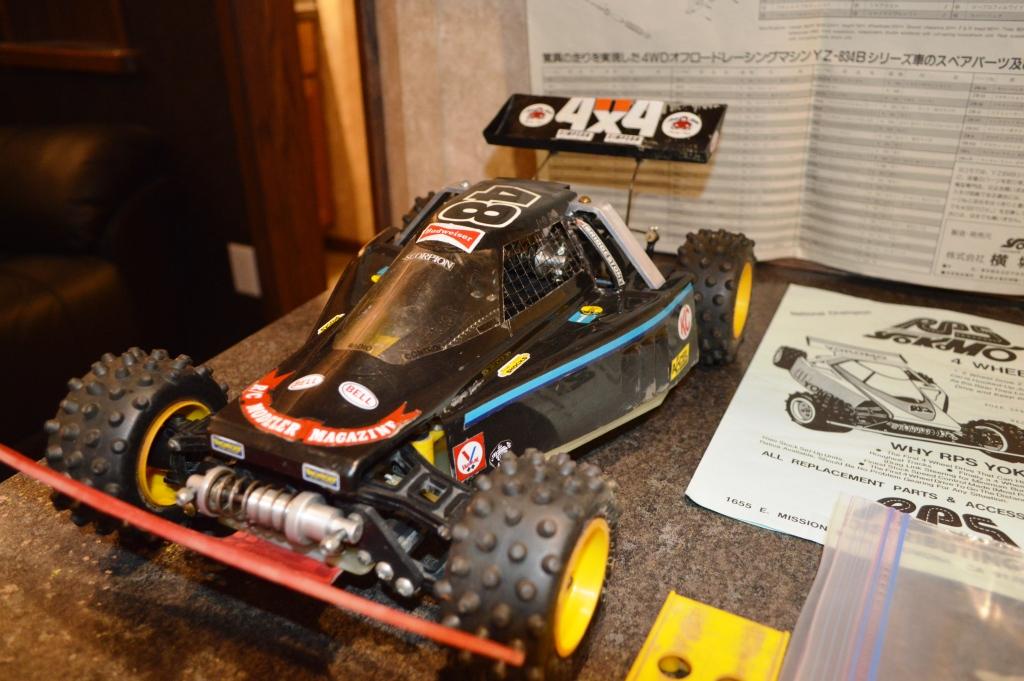

Time for a winter project..., wait, just because it snowed all day here doesn't make it winter yet. Autumn, project should be more appropriate.
Rod have be a bag with a bag in it and I think there's a car in there too. I just threw everything I think I needed for a restoration into a tote with the buggy and hit the road. When I say hit the road, I mean to work in the field. I usually have periods of down time where I like working on RC related stuff, usually painting bodies.
If anyone has any tips, I'm all eyes. I will do the normal, tear down, clean, sand, polish, and reassemble as per instructions.
Here's what I pulled out of the bag of goodies.

Looks fairly tidy already. What are your plans? Mod or stock?

shodog wrote:Looks fairly tidy already. What are your plans? Mod or stock?
I'm going to use as many NIP parts as I can, polish and rebuild the shocks, rebuild the trans, etc. The goal is to make is completely stock, but fresh, newish out of the box stock. I didn't bring the unpainted wing and body with me this time, but those will be painted in the yellow box art scheme. Oh, and that chassis needs loving too, sanding and polishing that too.

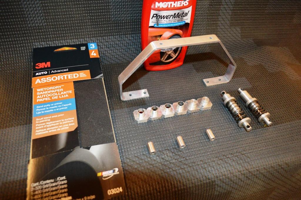

Step 2: I almost forgot to snap a shot of the product/tools used on the aluminum parts. I got the wing mounts polished up, the roll bar half sanded and the rest is untouched. What I'm using is Mothers Aluminum polish after using 3M stage 3 to 4 sandpaper (400, 600 and then 800 grit). I use a dremel where I can when polishing.

These are looking good! You may notice I am restoring any extra parts as well. I figured I might as well while I'm at it.

Thanks, I'm trying not to over do it with the bling and keep the original look as much as I can, but showcase quality.
I just got done sanding and polishing the chassis. It appears as though I need something more coarse than 320 grit to get rid of the gouges on the bottom. As for the top, I did 400, 600, 800 grit and then aluminum polish
- Top chassis
This is after 320 grit, no point in going any further. I hope to make it into town in the next few days to get more sandpaper.

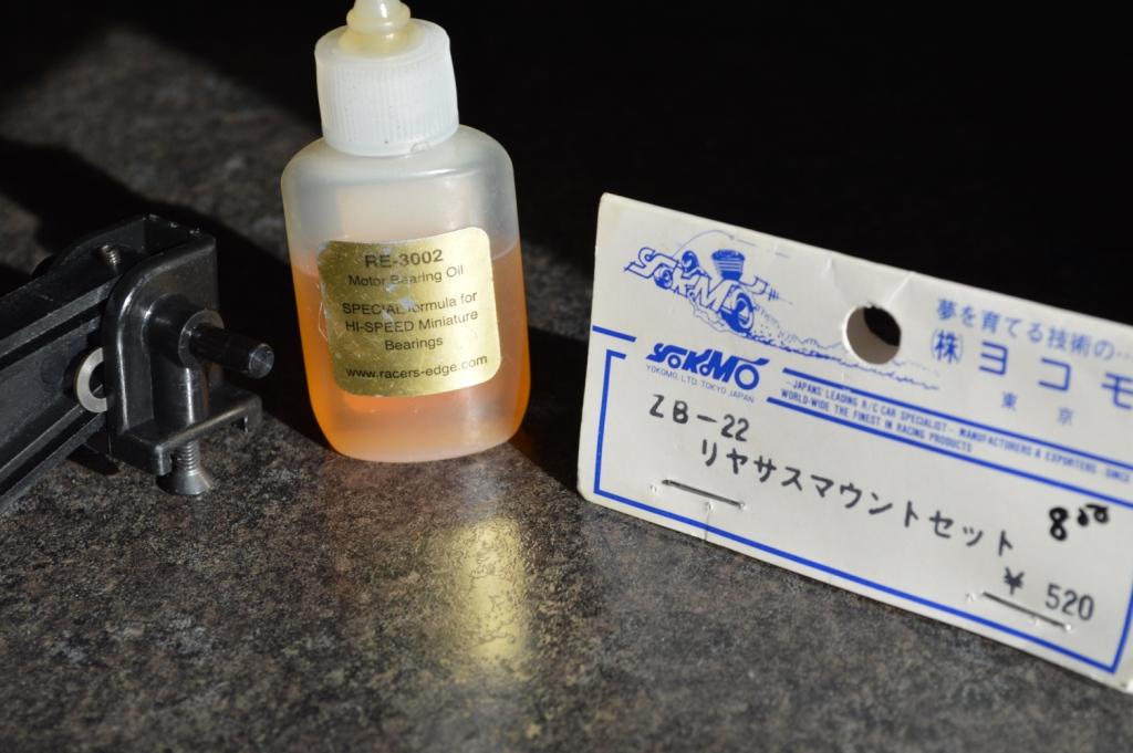

While waiting for another break in work to get sandpaper, I decided to get cleaning and lubing my shaft(s) and bearings.
I ended up picking Spray Nine multi purpose cleaner to clean the parts. It's my first time using it, and it's working quite well.
I highly recommend soaking the hardware and bearings in Goo Gone to loosen the grime and lube bearings at the same time.
I'm starting with the rear arms and axle shafts.
First opened bag, ZB-22 (rear arm mounts)... the cool thing is that it comes with new screws
. I used bearing oil on the shim and pins.
Next bags opened are ZB-24 & 25 (rear axles and rear dog bones respectively). I again used bearing oil on all bearings and a little on my shafts.
