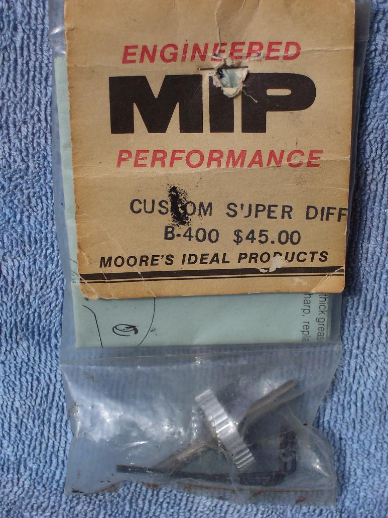

I picked this up recently. It's meant to be used in Tamiya's SRB gearboxes. You can tell by the length of the output shafts.

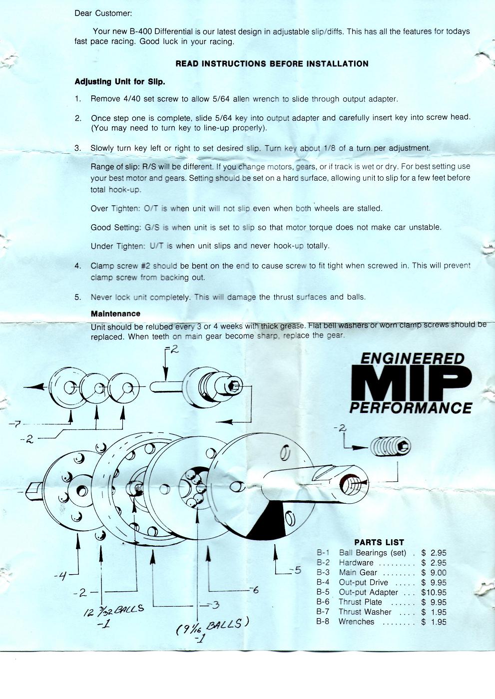

Instructions.
