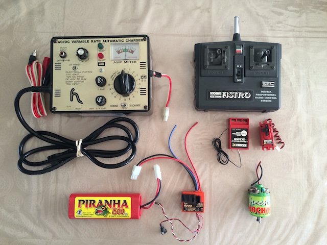

Out with the old electronics:
- Kyosho Astro GXT202 75AM
- Team Novak 410-M5
- Trinity Green Machine Motor (no idea what turn it is)

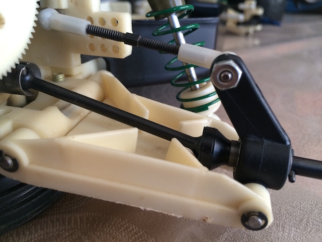

After installing the CVA, as others have already indicated, the Team Car's universal joint axles seem to be longer than the CVA axles. Requiring a lot of shims to make sure that the dog-bone end fits deep enough in the out-drive. Is that because the rear A-arm on the Team Car is different than older or newer versions of the RC10? I would prefer to use the recommended number of shims (and the wheel spacer, which I've ordered). I looked at the RPM rear A-arms, but they have a note that says it will not fit the Team Car. Is there a way to get the B4 rear A-arms on this car?
- Team Novak 410-M5
