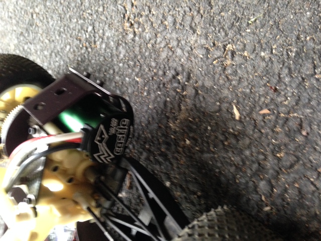

All new electronics
All new electronics
New addition 5700kv
New addition 5700kv

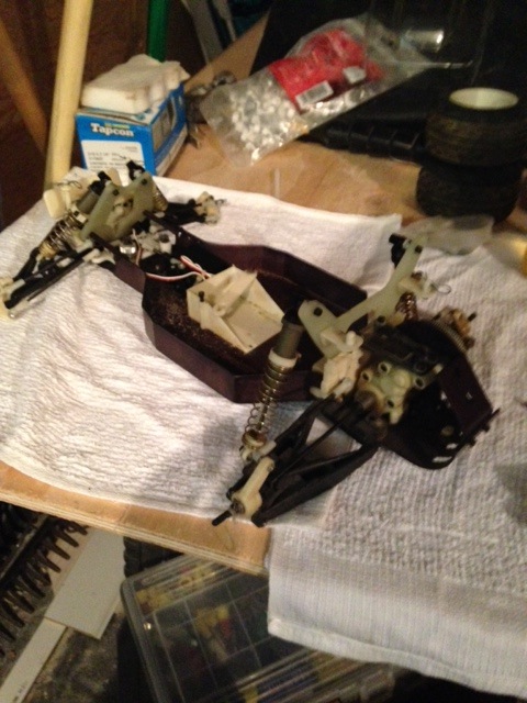

as found in attic.  Shocks seemed good, just changed shock oil with 45weight

That is a potent setup. I have that same motor in me and my sons T4's. Plenty of power, the biggest problem is getting it all hooked up. Wheelies like crazy.
