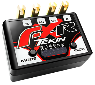

I need a brushed ESC and am interested in FX-R ESC because it is compact.
wonder if it is suitable for a 1/10 EP buggy or not.
Anybody has experience with it?

That looks like a nice brushed ESC, works down to a 12T motor, which is pretty powerful for brushed. But at nearly $100, it's way more expensive than I figured.
I'm not sure how much bigger it is, but a Hobbywing 60A brushed ESC has similar specs, for a whopping $21.00:
http://www.rcmart.com/quicrun-brushed-electronic-speed-controller-p-38913.html?cPath=1560_51
EDIT: Here's a comparison of physical specs:
FX-R: 28 x 20 x 10mm / 18g
Hobbywing: 36.5 x 32 x 18 / 39g
Looks like you'll pay quite the premium for just over 1/3 smaller size.

I'd go hobbywing, if it was my money.
I have a similar esc (Tekin) in my rock crawler, came as a set with a 30T motor. Works good, reverse is kinda wonky though. Kind of an all-or-nothing deal. In my experience Hobbywings have been good to me. I have at least 4 of them.

Easy response to that is don't use a "powerful" brushless setup.
Most any of these vintage ride can handle a mild 17.5 and I know surely they can all handle a 21.5 or 25.5 setup.
I have Hobbywing Justocks and eco power 17.5's in most of my cars. Blinky is the key cause I do feel the boosted ESC's could cook a vintage gearbox

Given the Tekin is made for rock crawlers, I'd doubt it could handle a faster buggy motor. They're designed for 30-35T motors, you're likely running half that, meaning much more power. The Tekin doesn't even have a heat sink. You'll likely pay the extra money, and blow the esc.

The FX-R is a great buggy ESC. It was never designed for crawlers, it's just useful for them due to its small size. It is a lower budget version of the FX-R Pro which has an unlimited rating, the FX-R uses the same control board, but less FETs. The FX-R will handle brushed motors down to 12 turns,
It has only become a crawler ESC as that is currently the only market for high end brushed ESCs today.
I run the FX-R, both in crawlers and buggies, and they work fine in both types of cars. If you need a small brushed ESC there's nothing else that is so small. Although if you can fit the Hobbywing 1060 into the buggy that would be my recommendation.
