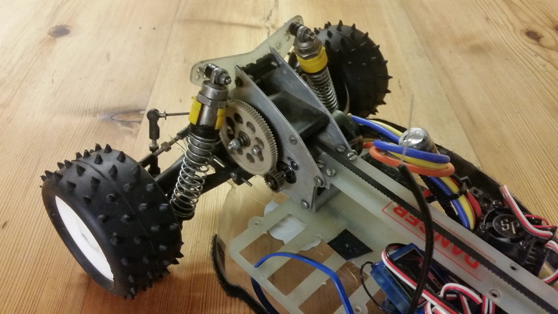

This is my ProCat. It was my third RC car and my favorite by miles, I was 13 when I bought it second hand from my LHS(sadly closed now) I have never raced I just ran it around my back garden and local parks. I hung up my RC hat at 14 after my King Cab went out of range and drove itself full speed into the lake and my local park frying my first and newly acquired ESC in the process :( . I couldn't afford a new ESC and the thought of going back to using a mechanical speed controller was too much too bare so my cars were packed away and forgotten.
Fast Forward 24 years. While moving house I rediscovered my ProCat and a passion for RC cars, over the last two months my collection has expanded to 6 vintage Schumachers a collection of brushed motors and a comm lathe to keep them going and lots of ESCs :mrgreen:
The reason for this post is to show you my restoration and hopefully get a few answers along the way I'm racing the ProCat and a Club 10 at The Brett Davis Vintage GP in January so have two months to get them ready and learn how to race. This forum has been an inspiration to me, a big thanks to everyone who has posted their projects here, they are a great source of information and inspiration.
My ProCat one week ago, looking a bit worse for wear.
