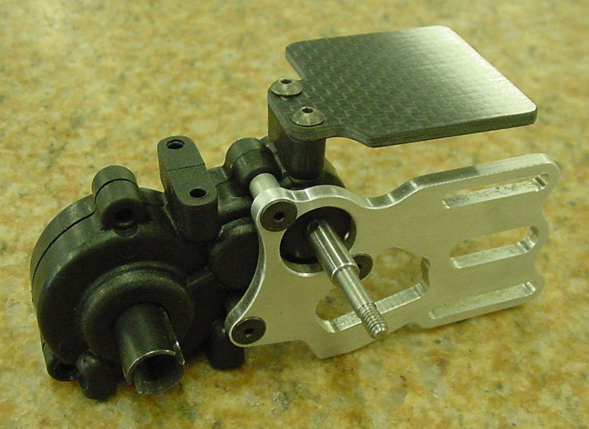

Dynotech Motor Mount and ESC Shelf
I found these on eBay. The motor mount is used in numerous other GTe builds. You can read about its strengths and weaknesses in this recent build by RC10th.
[UPDATE 1/22] I doubt the ESC shelf will be used. When I purchased it, it didn't occur to me the implications this would have on COG (center-of-gravity). For the indoor clay tracks I'll be running on, I'm going to want the COG to be fairly low and I don't imagine an extra 50g mounted this high is a good thing! We'll see - something I learned early on in my career as a software developer... TEST. TEST. TEST.
