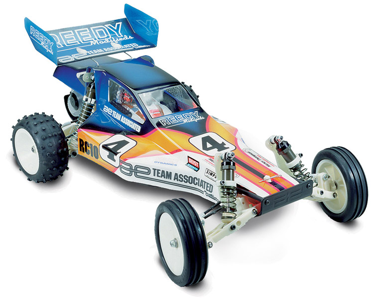

Most of you know this car, this is what we are painting today. The pin stripe makes it really easy to do, you'll see.
I use vinyl pin stripping masking tape that you can get at the local auto body supply shop. I've got 1/16 and 1/8" tape that works great for RC bodies.
