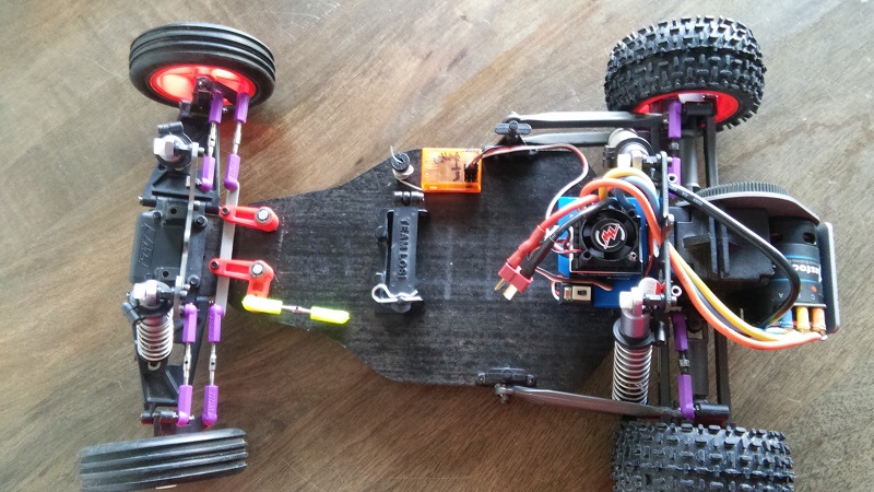

Congrats! Good to see the JRX getting some action. I am actually building an X2 right now to race on indoor carpet offroad. I am keeping it 5 link for fun. At club level my experience is same as yours, these old buggies can hang just fine. I've had a few different racer builds over the years.
Are you running a slipper, what was your gearing set up, any other set up tips. Plenty of RC10 info but we don't get as much JRX info so it is all helpful. I don't have a slipper on this one. On the carpet there is so much traction.

Im geared 20/86 with a lipo, and ran with the arms level. The rest was setup as per manual build. No slipper. I think I found the diff sweet spot! With no brakes I would scrub speed off into corners and roll power on coming out, low traction dirt. For carpet you will want to run a little lower, and a tighter diff. Be carefull with power, especially if your running b/l, I dont think the ball diff will be very strong on carpet. Youll want stiffer springs and heavier shock oil. Good luck

I've raced a few JRX's over the years but great to see your set up. I've never hurt a LRM transmission in one of these. I never race a track that has required more than 13.5T Brushless and never had a transmission issue. I've run the slipper set up and always end up running it so tight it probably is of little value. This carpet is new to me but I have my rere RC10 worlds dialed to competitive A main times when I can turn clean laps unfortunately I am a b main guy as I am not consistent but fact is car is fast enough I am not.
If you can find one there is a dual ball bearing differential that will hold up to anything but it is not necessary. You can usually find the gear but the odd size specialty bearings appear to be used in nothing else and you need to find old Losi stock.
I have a built metal thorp also in my pitbox but have never needed it. I think the ability to adjust the diff from the outside with no disassembly remains one of the best features ever. I build mine with ceramic balls and never had an issue.
Modern power and Lipos help hide a lot of sins for sure. This one is only going in 17.5T class. Honestly the 5 link is probably a terrible idea for the carpet but I am not there to win anyways, so if it holds its own I am happy.
