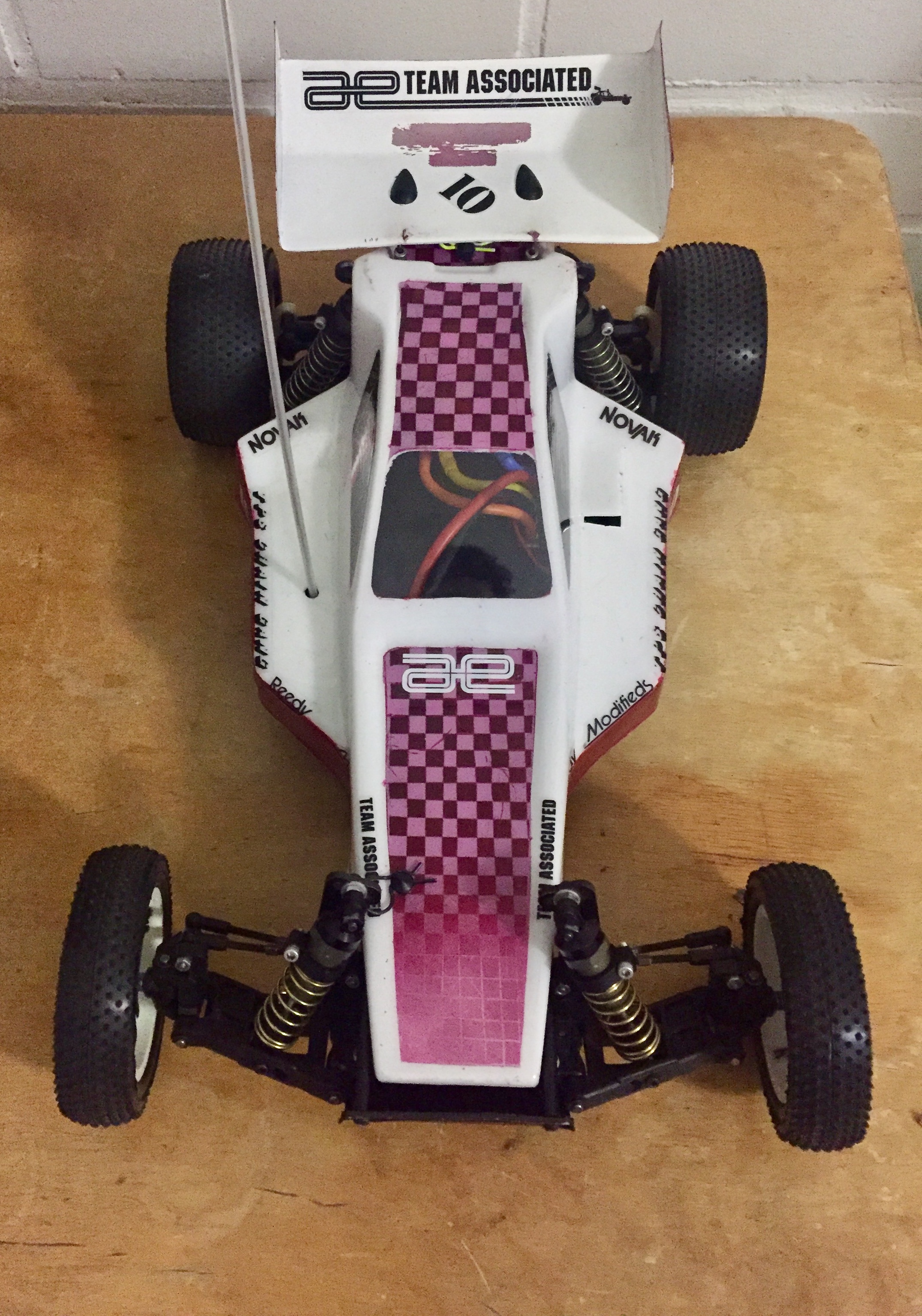

OK, here's my first attempt on painting with rattle can. It's OK from 10ft but in reality quite bad. I have to invest on airbrush as I will paint more for sure.
Everything was OK up to this point.
ImageRC10 World's Car by Tomi Seppälä, on Flickr
But then I messed up with masking tape and paint got sucked under the tape and messed all the lines. I tried to hide the worst spots with decals and now it is good enough for a runner.
ImageRC10 Worlds by Tomi Seppälä, on Flickr

I went for a drive today with the car and I still can’t drive. But the car is starting to feel good so I think I will learn some day. 13.5 motor seems OK, maybe a bit on the slow side but I will start playing with gearing and timing when I get more confident at driving.
I broke another servo though. I have now used all my old servos so I will have to look into modern stuff. If I get strong enough metal gear servo should I still use servo saver? What would be the most cost efficient servo to use?
And looks like I will get to paint another body soon if I keep rolling the car like I do now.
