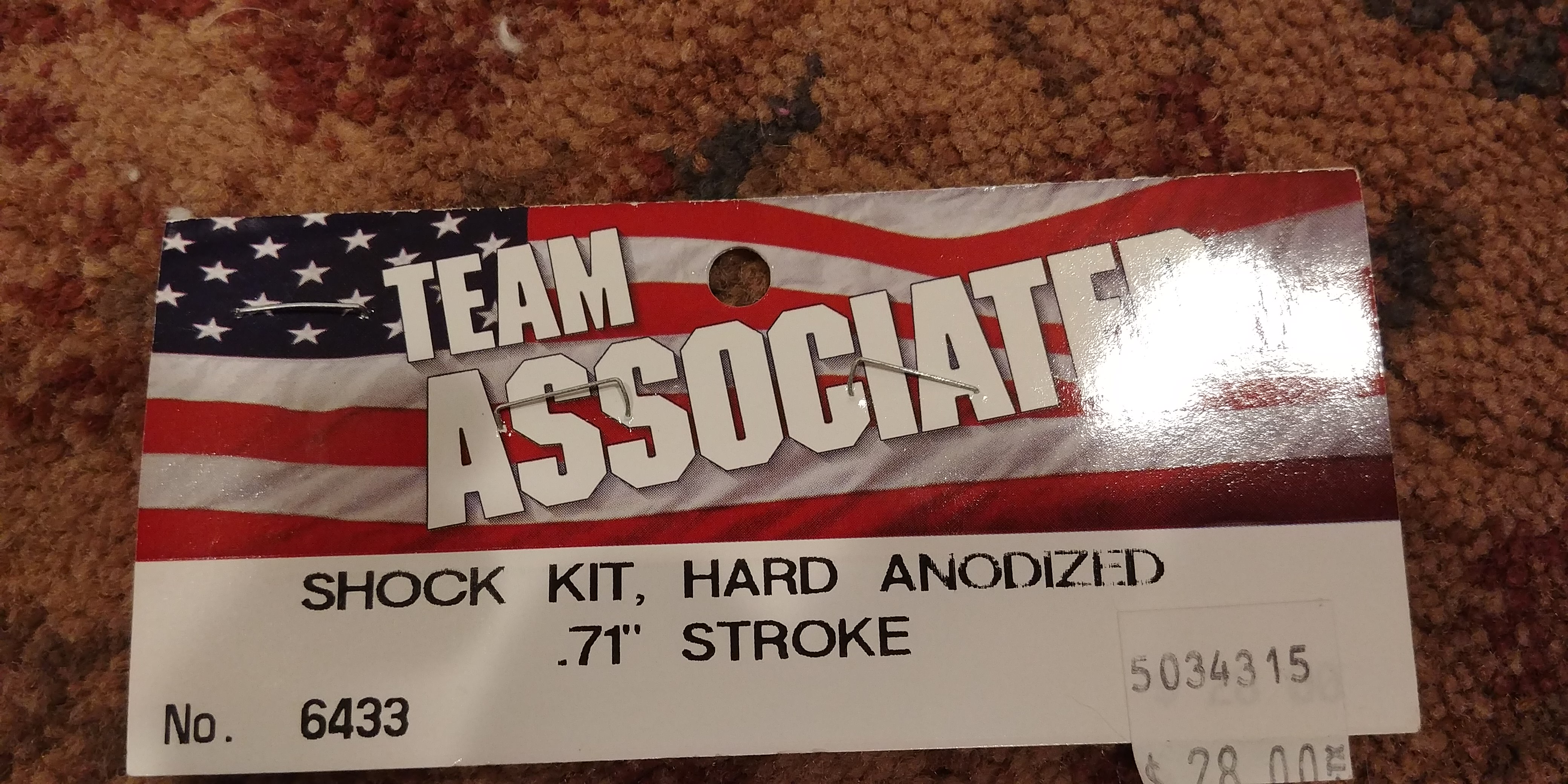

Thank you. Do the grey shocks look like the RC10 Worlds shocks?

Posted: Thu Feb 15, 2018 9:20 pm
by jwscab
The shocks are hard anodized associated team shocks. You should be able to getting all of your replacement parts from Associated directly, start with the 'classic' manual for trans rebuilding. Steering bellcranks are rps/losi

Posted: Thu Feb 15, 2018 10:00 pm
by Phin
Shocks look like they may have been a later addition. Did you add them when you added the motor and electronics?
I'd date most of the car at 1988/89 but the shocks with the plastic caps would be from '94/95.
Re: Help Me ID this old RC10
Posted: Thu Feb 15, 2018 11:22 pm
by jwscab
The plastic caps and black clips looks like a set of b3 shocks maybe.

Posted: Fri Feb 16, 2018 8:30 am
by Phin
jwscab wrote: ↑Thu Feb 15, 2018 11:22 pm
I think you're right about the age...those do look like the B3 plastic caps...but I think the fronts look like .71 length shocks.
Bottom load golds would be the
"right" shocks for that car. Or Kyosho Golds.

Posted: Fri Feb 16, 2018 10:28 am
by Merc1973
Phin wrote: ↑Fri Feb 16, 2018 8:30 am
Thanks for the clarification one terminology.
You're right, they are .71 hard anodized! I found the box of my old stuff last night. Cheap shocks at $28 when I bought them. I did replace them, it had been so long I forgot... I found the old gold tubes in a plastic bag along with other goodies I will post pictures of here. Are the plastic cap shocks better than the Gold tubes? Should I rebuild the golds and install them?
Rebuild kit
