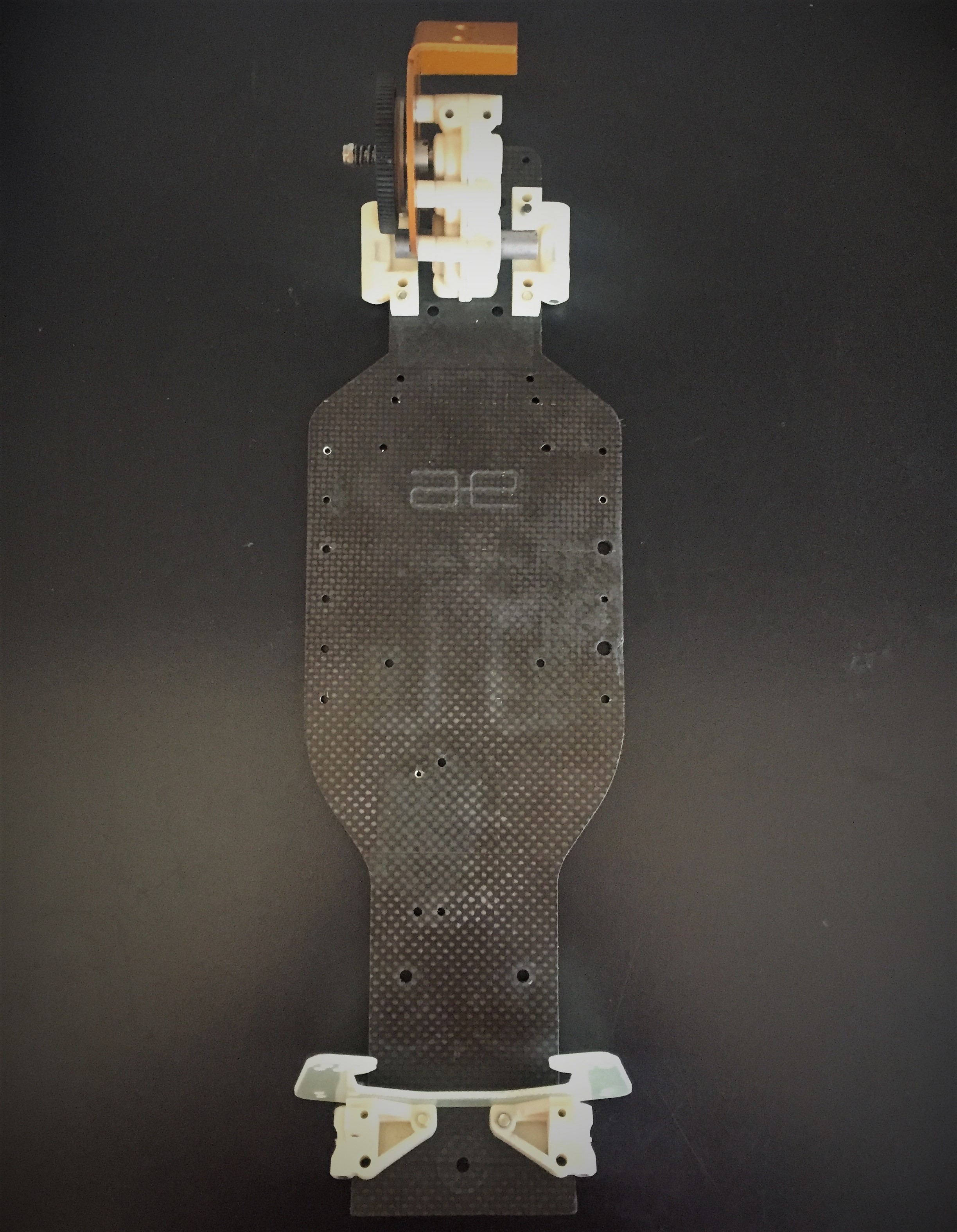

Lately I've been driving Niki-built NIX10M and like it a lot. Now as they are closing the indoor tracks for summer I need another car for outdoor tracks. So I finally begun working on my summer car to be, which is RC10 Graphite team car. The car was quite rough and missing a lot of parts, so restoring it was not an option. I'd like to build it to look somewhat like Masami 1989 prototype, like this. Not exact copy of course but more modern runner for turf and clay.
This is the starting point:
If possible I will steal some ideas from 10M like battery tray from 44.2 and steering servo position(Masami's prototype has it the same way if I'm right). I'm not sure which shocks to use as original team car ones are missing. I like the look of golden shocks like the prototype car has and I already have a set of CE golden shocks. But if I decide to use big bores, are there anything golden bb's available that fits?
What is the reason for flipped rear bulkhead in the original prototype? Is it worth doing?
This is the NIX car:

This is where I'm at now and run out of parts. I'm using Nix steering as I like how it performs on my mid motor car. I will change all the ball cups to white shock rod ends and see how they work. Rear shock tower will change as well to be more like the prototype car's tower. I like to look of the golden shocks and will use those with bb springs(and golden caps and white parts at front as well). They are the top loading ones so hopefully will not leak like old style shocks. If I manage to find golden bb shocks I will have to reconsider.
I did cut the chassis nose a bit but not as much as Masami's car. I have to find or make a front bumper and drill the chassis for servo mounts and B44.2 battery trays.
I still don't know the idea of flipped rear bulkhead but it seems to work just fine as soon as I get the support done.

Hi Tomi :)
I think the idea of flipped bulkhead is to align shocks better with rear arms. Especially you have LWB-setup.

Hi Tomi
Nice build so far :)
Why did you flip the rear bulkhead? You are not going to use a transmission brace then or are you going to trim the rear tower to fit the brace?

by TomiS
Yes, I will have to make different shock tower and transmission brace. The reason, like Joksa said, is to get the shocks better aligned. I'm not sure if it really makes a difference or not but as it was done on the RC10GX prototype car I decided to copy it to this car. I did a little testing with the rear arm mounts on LWB setting and shock is at better angle when the tower is a little farther back.
And I'm quite sure I will have to use rere worlds arms at the front also as I'm running out of wide white arms. I don't want to break the last sets I have.
