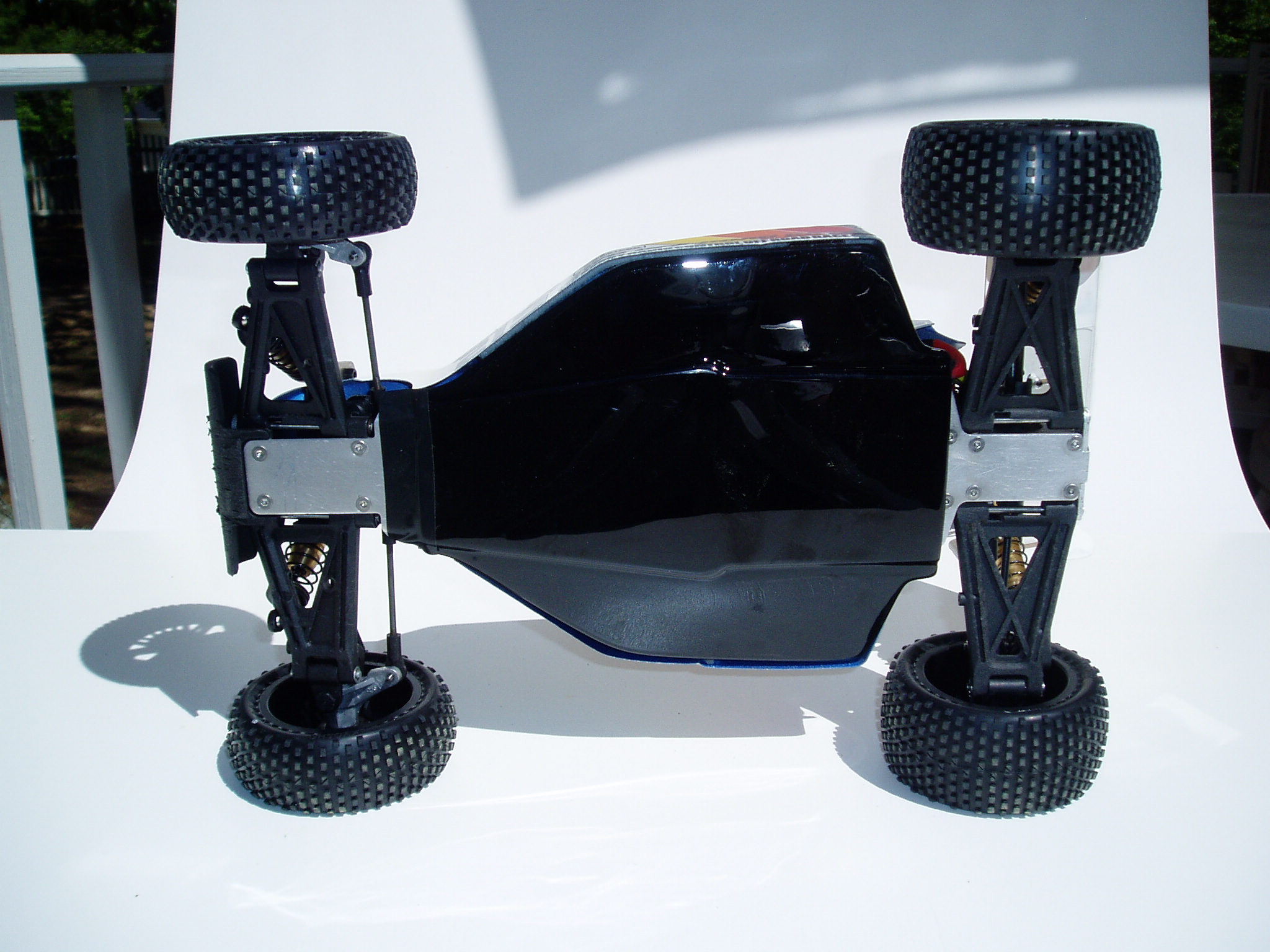

Just wrapped up this Optima Mid runner and thought I’d share some pics before getting it dirty at the track. I’ve spent the last few months collecting some OM parts cars and spares from ebay and I’ve nearly enough parts to build two SE’s (future shelfers) and this Mid runner (the runner used the most well-worn and ragged of all parts on hand). One of the SE’s are nearly completed, and I may post some pics of that car in the gallery when the body and decals arrive and the body is finished. Meanwhile, this one is ready to roll. The drive train includes an aftermarket steel idler gear (from ?) and an original diff gear, top drive gear and belt that were still in good shape (did belts ever actually wear, stretch or otherwise fail with these cars?). I replaced the original dog bones and axles with the Kyosho re-released versions (the new axles use pinned hexes rather than the tapered drive hexes) and the wheels and tires are also from Kyosho. The only Mid body I have was pretty badly scratched, beat-up was painted blue and the paint was heavily scratched as well. Initially, I’d planned to run it as-is but then decided to investigate the possibility of stripping the old paint to re-apply a little nicer vintage style paint job. Apparently, from what I've read, removing paint from lexan doesn’t always work well so I ultimately decided to just clean up the body, paint the outside and apply a box-art decal set from MCI. So, after thoroughly cleaning the lexan and trimming the ragged edges, a light coat of Pactra polycarbonate white paint was applied as a primer for the three coats of white gloss Krylon epoxy enamel. I’ve had good results in the past applying enamel over poly paint (enamel paint seems to adhere well to poly paint but not directly to lexan).
![P1010176.JPG (705.12 KiB) Viewed 2388 times P1010176.JPG](./download/file.php?id=121357&t=1&sid=fa3e4111108f502a63fb544209a415e8)
![P1010170.JPG (703.6 KiB) Viewed 2388 times P1010170.JPG](./download/file.php?id=121358&t=1&sid=fa3e4111108f502a63fb544209a415e8)
The rear suspension assembly is reversed, locating the shocks behind the arms, to ease access to the motor and spur gear. The wing mounts on this car had been broken-off the trans cases but I was able to mount the wing to the shock and camber plates using some good ole Yankee ingenuity; a piece of Kydex, some wing wire and scratch-made wing buttons. The Kydex plate seemed like a good place to mount the ESC’s switch.
The Belt and Gear covers and undertray are from Team Blue Groove. Most of the old Philips head screws were replaced with 3mm stainless hex machine screws that remained from some other projects. The chassis plate screw holes were countersunk to accept flat head screws so they wouldn’t interfere with the undertray.
The electronics are just some odds and ends scavenged from vehicles that I don’t run anymore. The motor is a Reedy 550-SL 3500kv, ESC is an Associated XP SC450-BL, servo is Hitec HS-645MG, and receiver is from Futaba. I’m a little worried about running that 550 motor with a light 45amp ESC but I will attach a fan to the ESC’s heat sink and hope for the best. I will run only 2s, the car is pretty light and gearing is very conservative so maybe it will be okay.
Anyway, I’m really looking forward to getting this car on the track. Should be good fun.

The weather here this week has been simply outstanding and I’ve finally been able to set aside some time to run the car. I’ve never actually driven a Kyosho Mid before, so this was a completely new experience for me.
My first impression was just how insanely quiet this car is; by far the quietest RC I’ve ever run. Squeeze the throttle and there’s a small whistle from the spur then, apart from slight tire noise, it’s dead quiet. I mention this because usually (not always) quiet equals efficient since, at least in theory, the system isn’t wasting energy to overcome some mechanical interference that's creating sound waves so more of the available energy can be used to propel the car. Also, since this car uses a metal idler gear, I’d expected it to be noisy, but it isn’t.
Second, as you’d expect from any car with a relatively high front weight bias, this car has a ton of steering response. I really needed to re-learn how to drive a 4WD RC after driving 2WD for so long now. I dialed back the steering Dual Rate to about 70%, disabled the drag break (I typically run 5% DB on 2WD because it seems to aid corner entry), and tried to re-trained my mind not to lift entirely off the throttle while entering the corner. So, took it slow initially and after a little fiddling with steering and throttle settings and about 10 minutes run time, I was able to hustle the car around the track pretty well. After 10 minutes, motor and ESC temps were good. The 550 motor seems to make a lot of torque and is a good fit for this car – acceleration is instant -- I like it.
Another thing I noticed was that the rear spring rate and damping still needs a little attention. The rear of the car tended to rebound far too much mostly over the smaller ripples in the track while the front remained planted.
It’ll require more suspension tuning to improve the handling but, so far, the car is a lot of fun to drive. Big smiles from me. I’m really looking forward to running the wheels off this summer.
