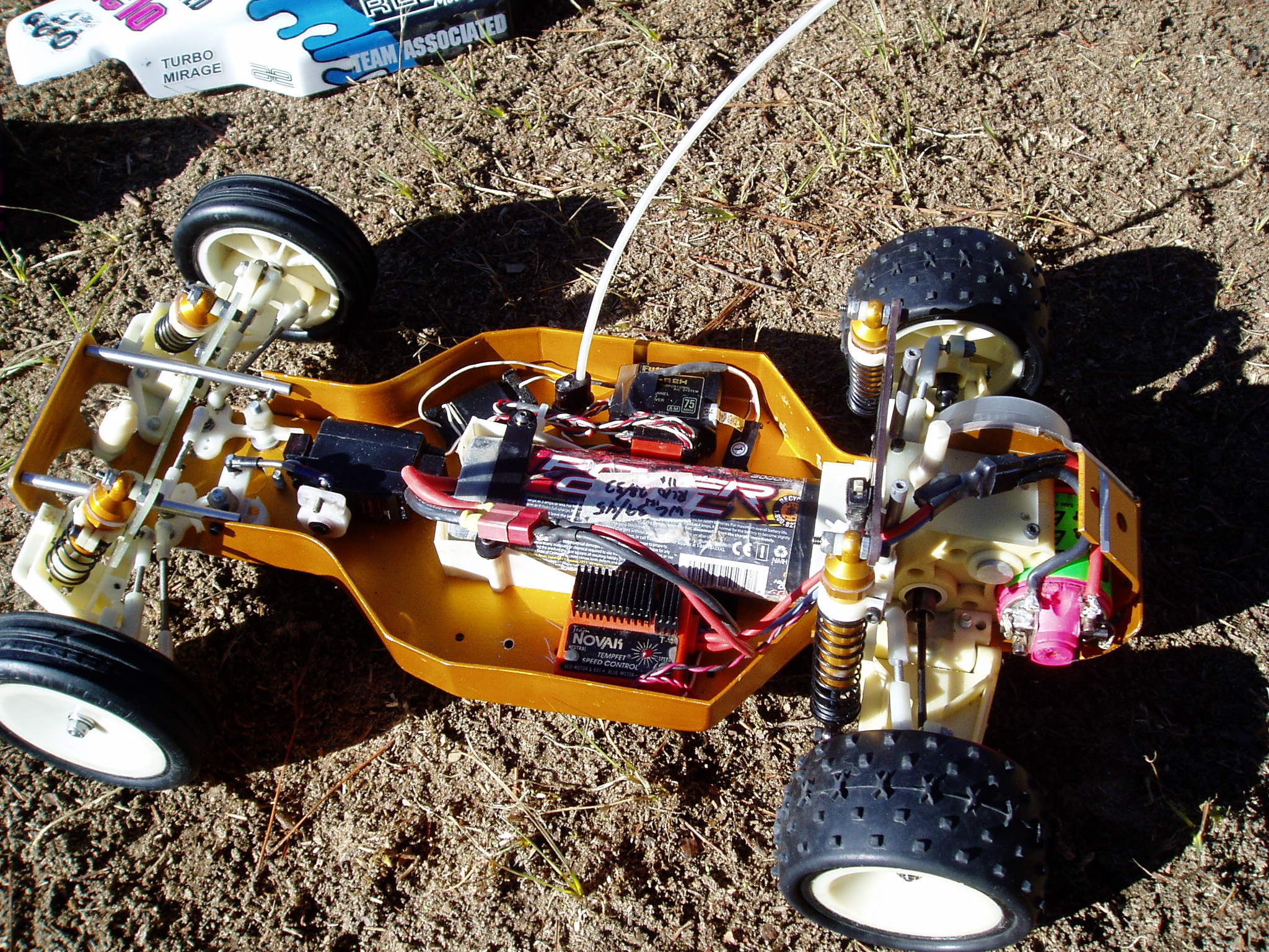

FWIW. Last summer I pieced together an old school 6-gear, short arm, back to basics RC10 to run on my little backyard dirt track. It even has dog bones and the super sloppy steering system. I did the outdrive bearing mod Basher mentioned and have a Reedy 3500kv in it right now. Tons of fun. Love it! :D
Here's an early photo with old school electronics.
