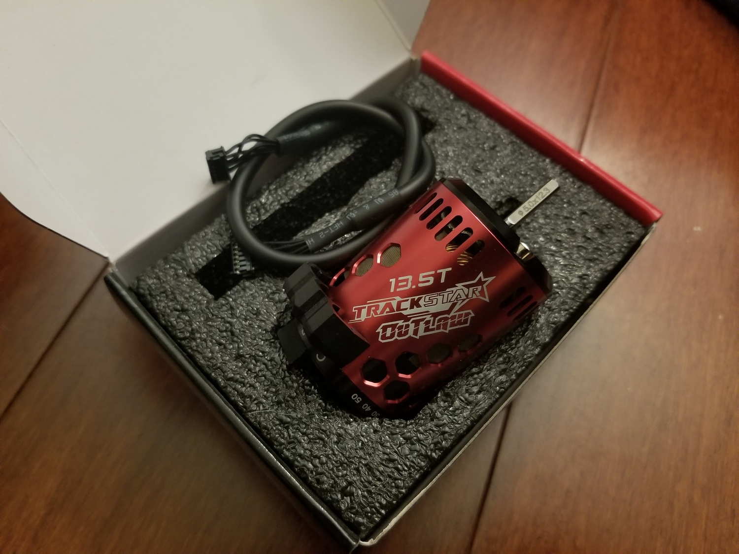

Posted: Tue Sep 25, 2018 9:42 pm
by BooGTS
Re: RC10 CE rebuild electronics
Posted: Wed Sep 26, 2018 11:43 am
by Basher67
That will be all kinds of fun.
