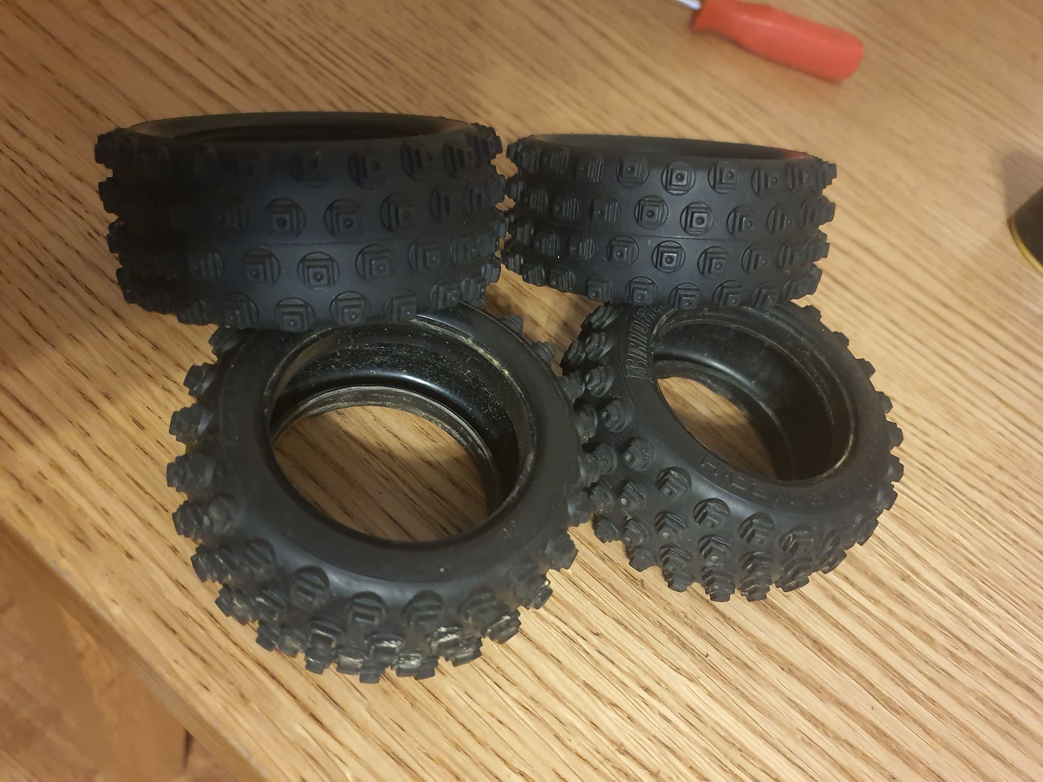

Well this has turned into a bit of a slow-burner of a project, but as and when the right parts pop up I am steadily squirreling them away.
I managed to pick up two pairs of rear Associated shocks for it - and they have been stripped to go off for re-anodizing as the ones in the picture look like very 'orange' examples. I have also bagged a set of CRP spring collars for those shocks.
The correct front shock tower is also now fitted.
I also managed to find a tidy looking Novak T1 esc and matching Novak receiver - I sent the T1 off for a refurb and a rewire and now that is back, having been fully tested.
Lastly, i managed to bag 2pairs of tyres it pretty good condition yesterday.... which came off a show car. It's definitely getting there now 8)

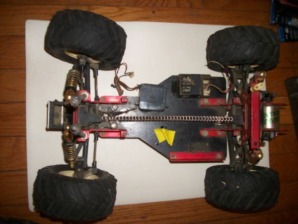

Hey guys- it's been a very long time since I've been on here but I spotted this listed locally and wondering if it's the Hot Trick Optima missing a top plate? Maybe with truck tires?
I was considering grabbing it. Thanks!
EDIT: missed it! Oh well... Still LMK if that's what it was. Thanks!

Yes, that looks to have the Hot Trick Optima parts, including the shock towers, along with the graphite Trinity lower chassis as well.
