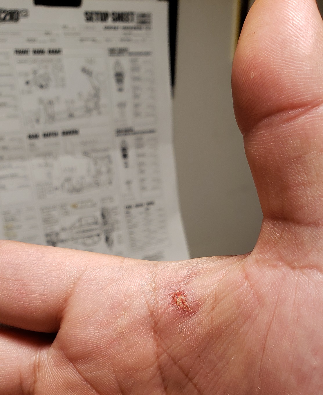

Did your kit come with a revised belt cover and the addendum sheet for the manual? Mine did, I compared the standard belt cover to the revised one and couldn't find a difference but I went ahead and installed the revise one anyway.
The body is tricky to trim around the shocks. I slipped with the xacto and stabbed myself in the thumb. :oops:
Looking forward to your next update. :D
It did come with the revised rail, and just like you I couldn't spot the difference. Thanks for the warning on the body trimming, I'll make sure to plan the cuts out and execute carefully.

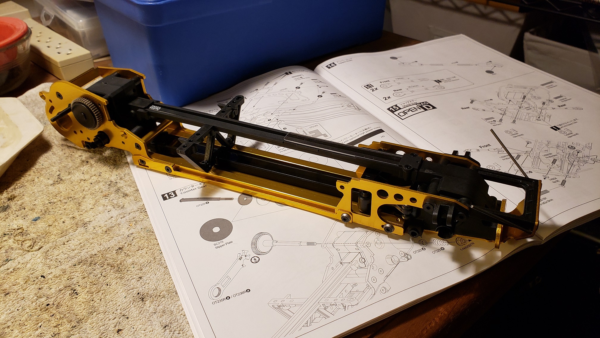

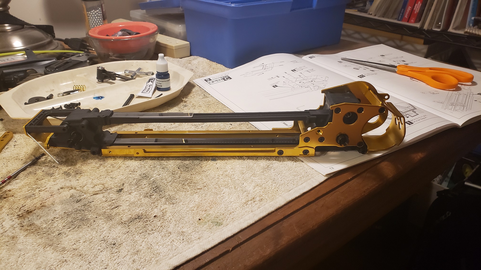

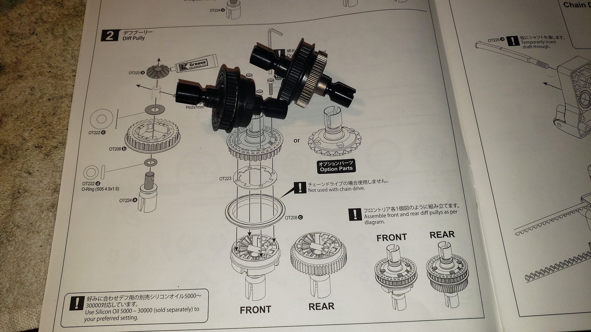

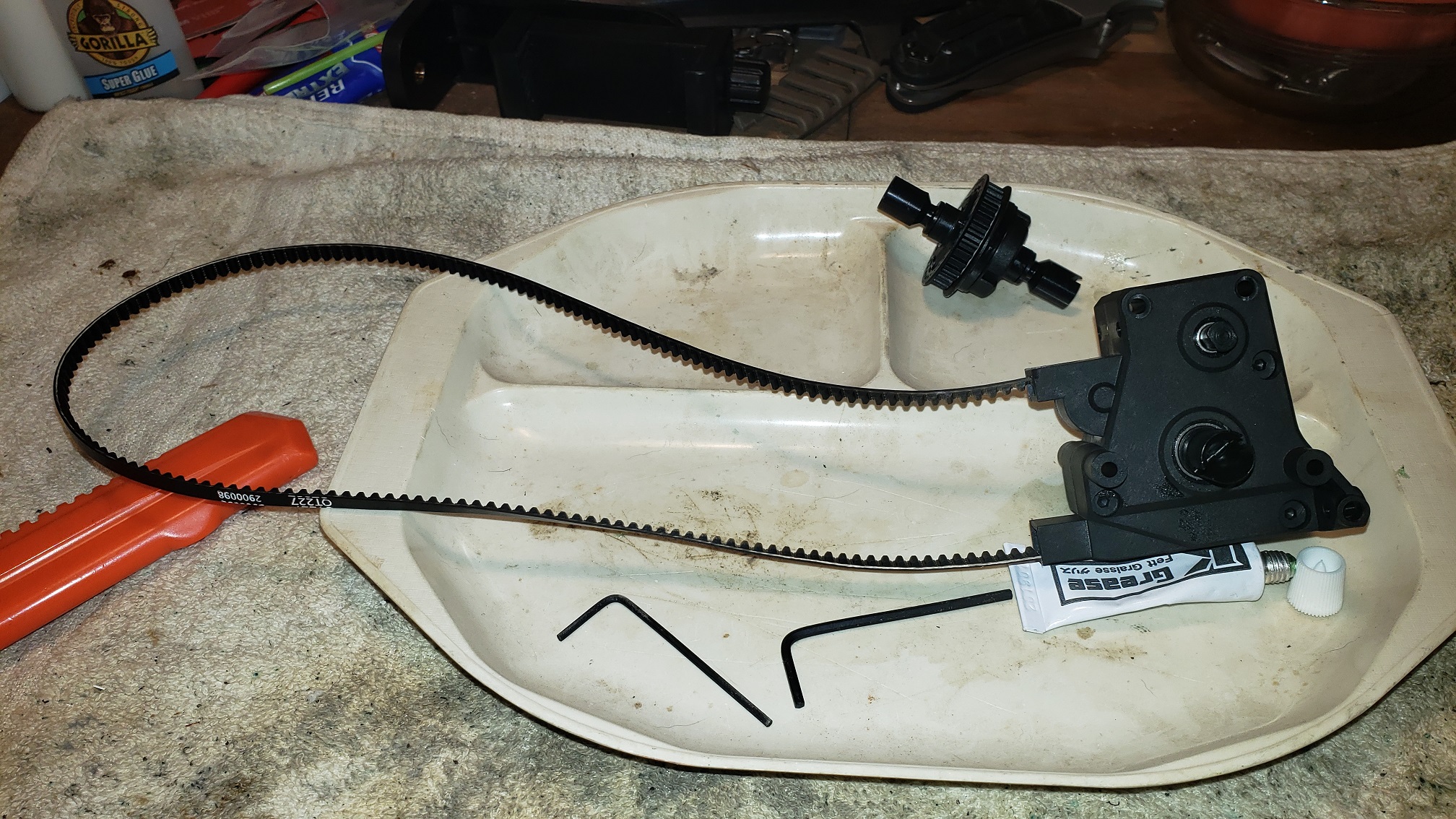

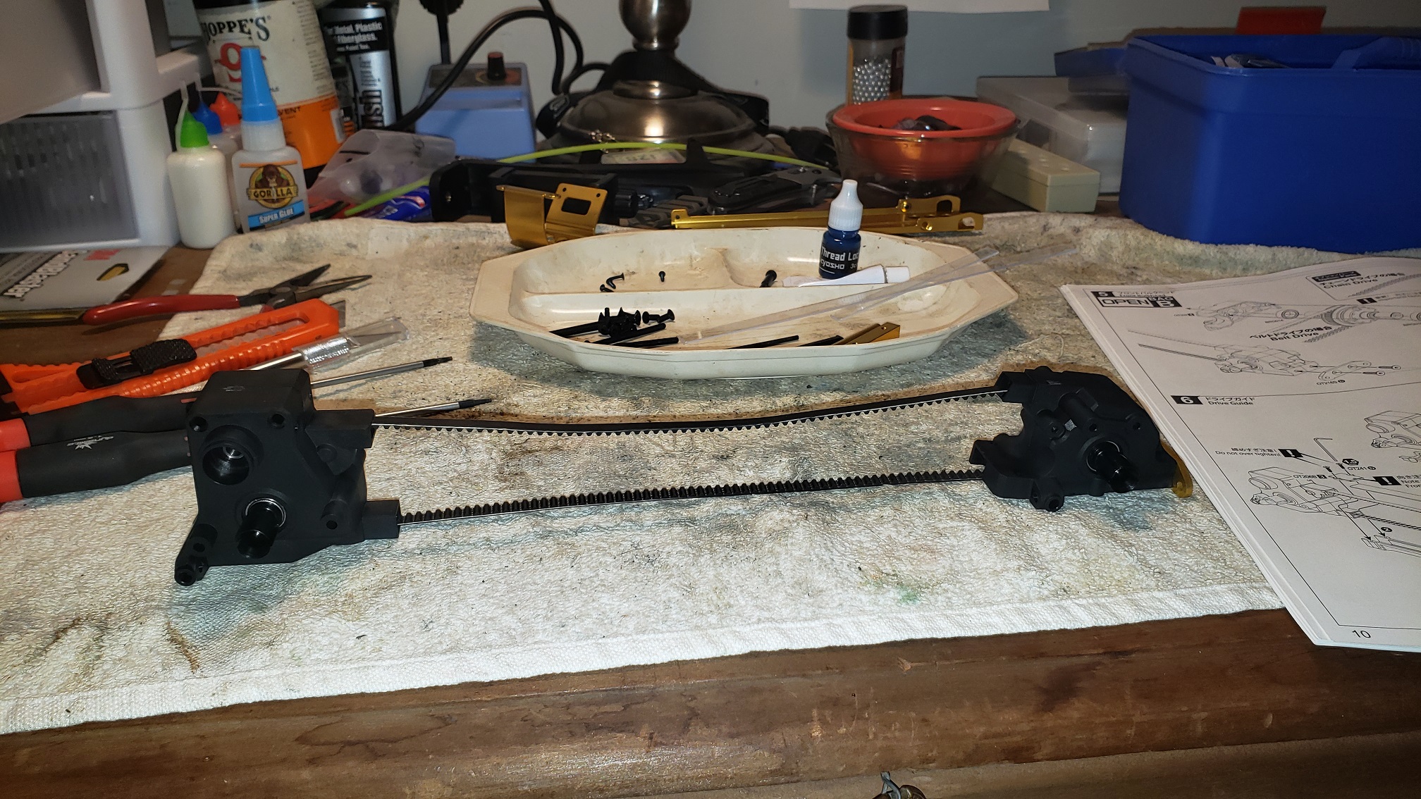

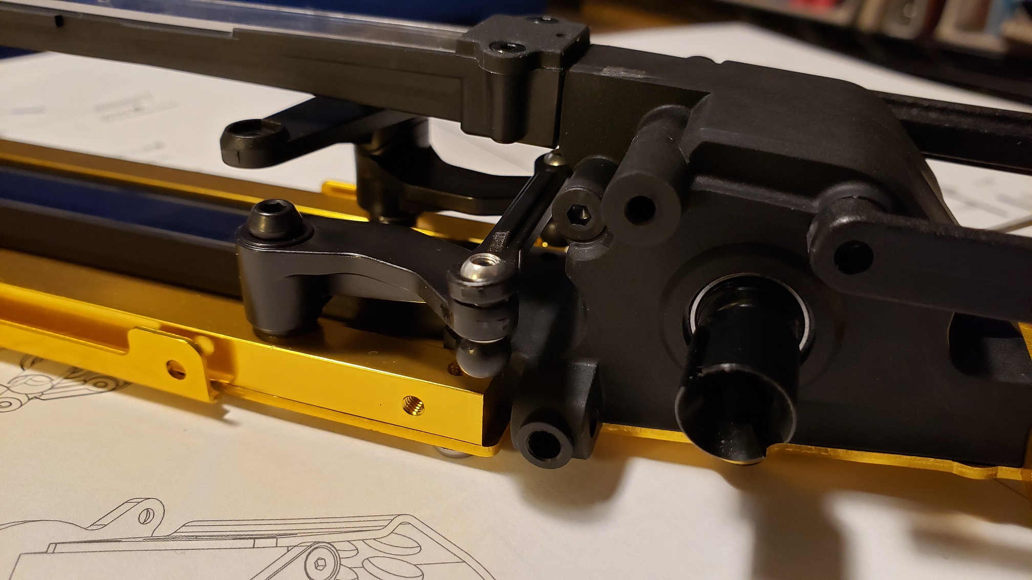

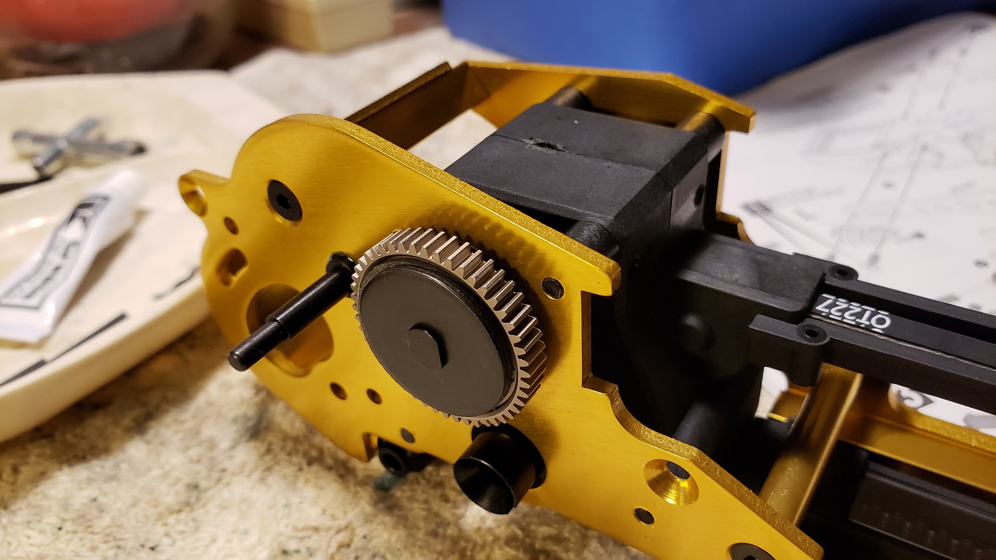

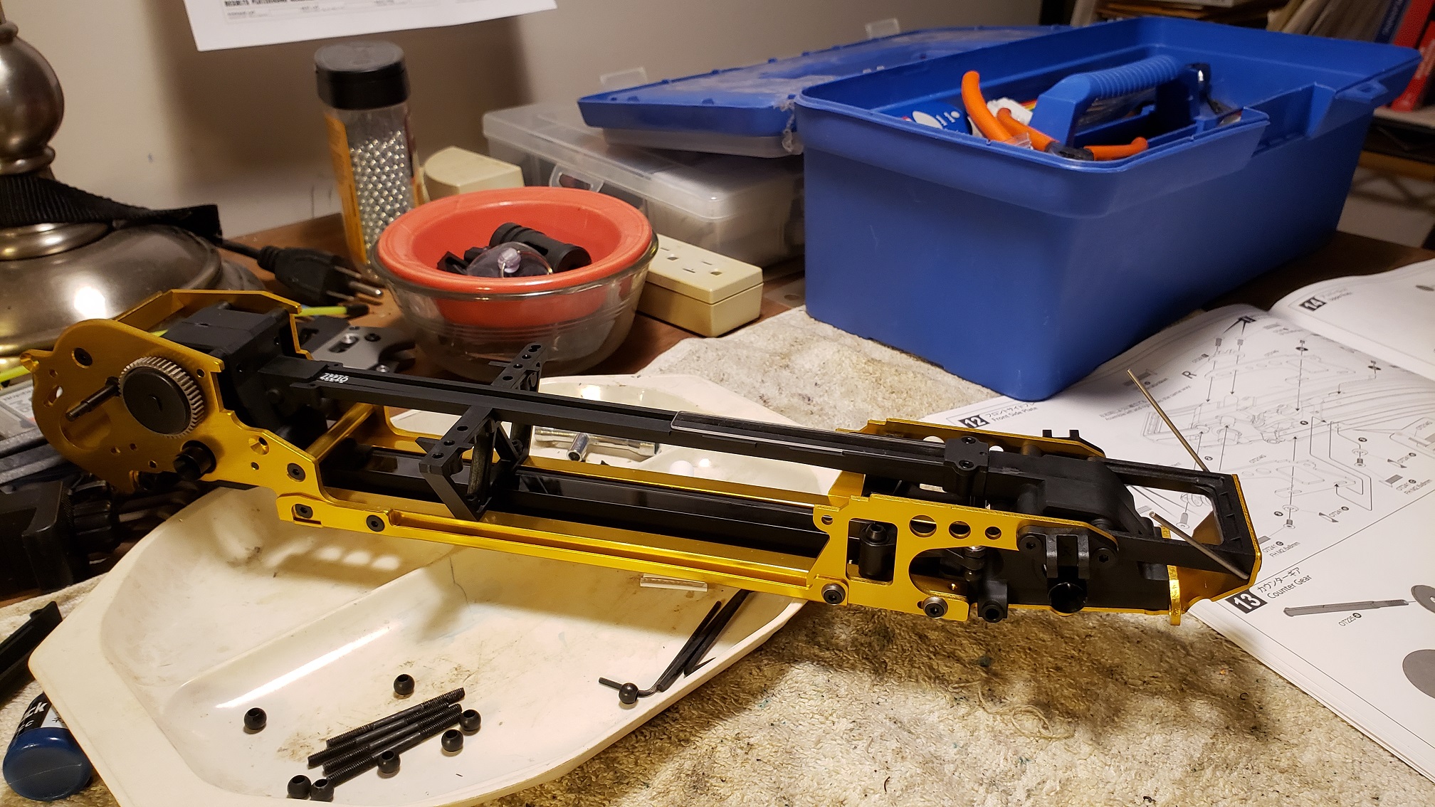

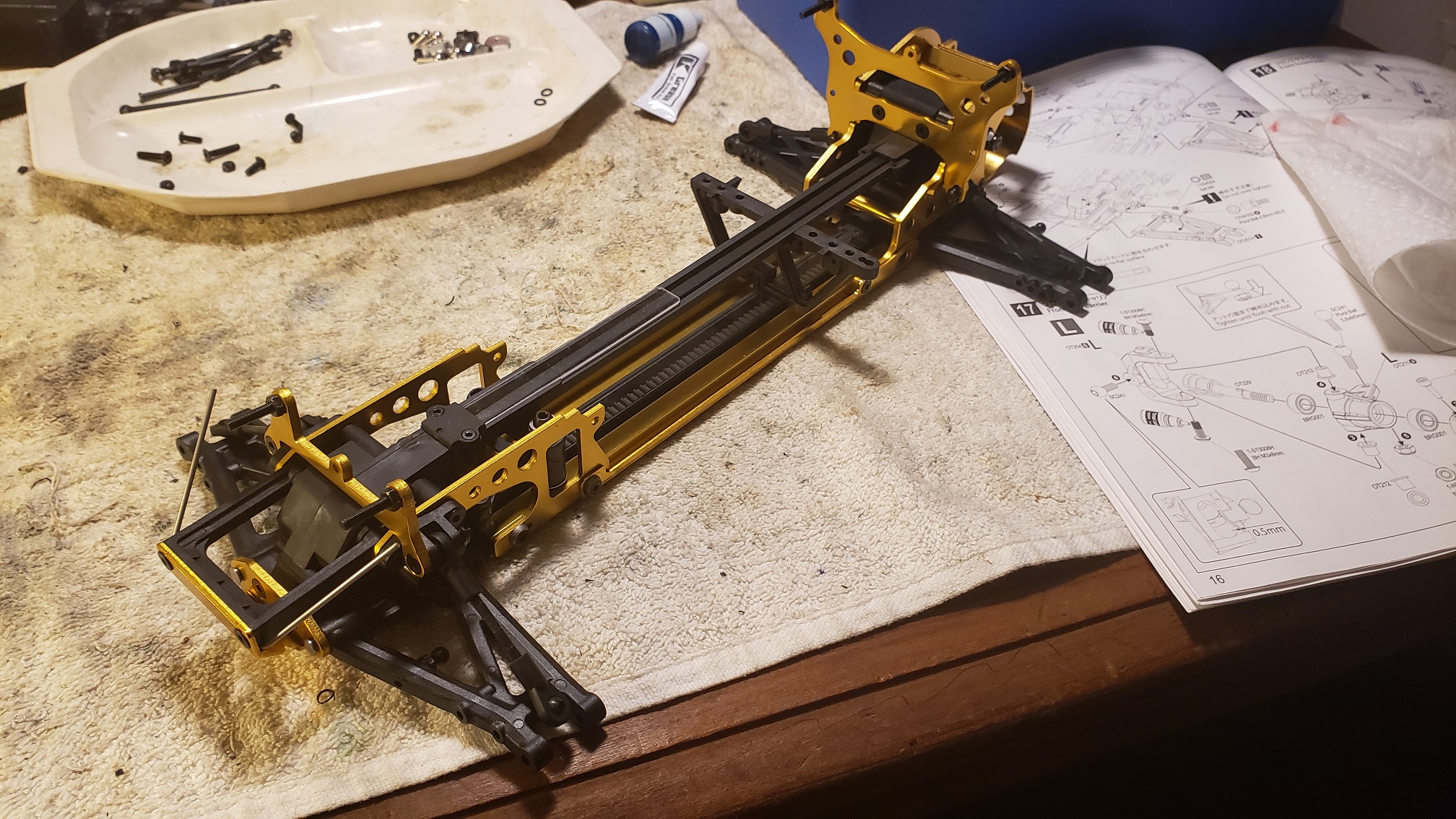

Some highlights from the second night. Starting to get some GOLD on 'dem parts. I only got to about Step 6 the first night.
Got the main chassis put together
Then the Servo Saver Link which was quite a pain to get in there with my fat fingers
Counter gear installed. When I was spinning the diffs before this went in, there was a "rough spot" in the rear diff. But after getting this in, sounds smooth as silk
Then back to the front end for the front side plates. Tonight got me to Step 13
Some wide shots of the progress at the end of night 2.

Looking good. 8)
One thing that struck me the first time I'd assembled one these early rear motor Optimas is just how incredibly complex the chassis is - with its side plates, rails, intricate belt covers and a multitude of fasteners and bits and bobs to hold everything together. It's like an exoskeleton. The later cars simply used flat plates for lower and upper chassis with turned stanchions to connect them. Oh well, it's an interesting design and it all makes for a fun build.

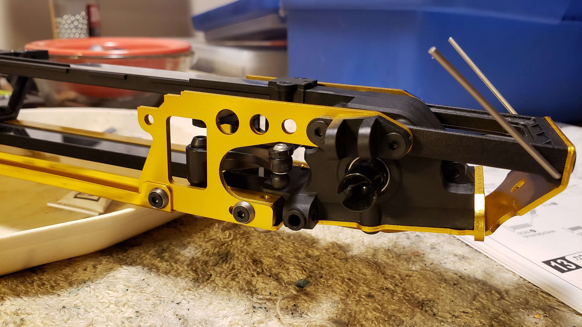

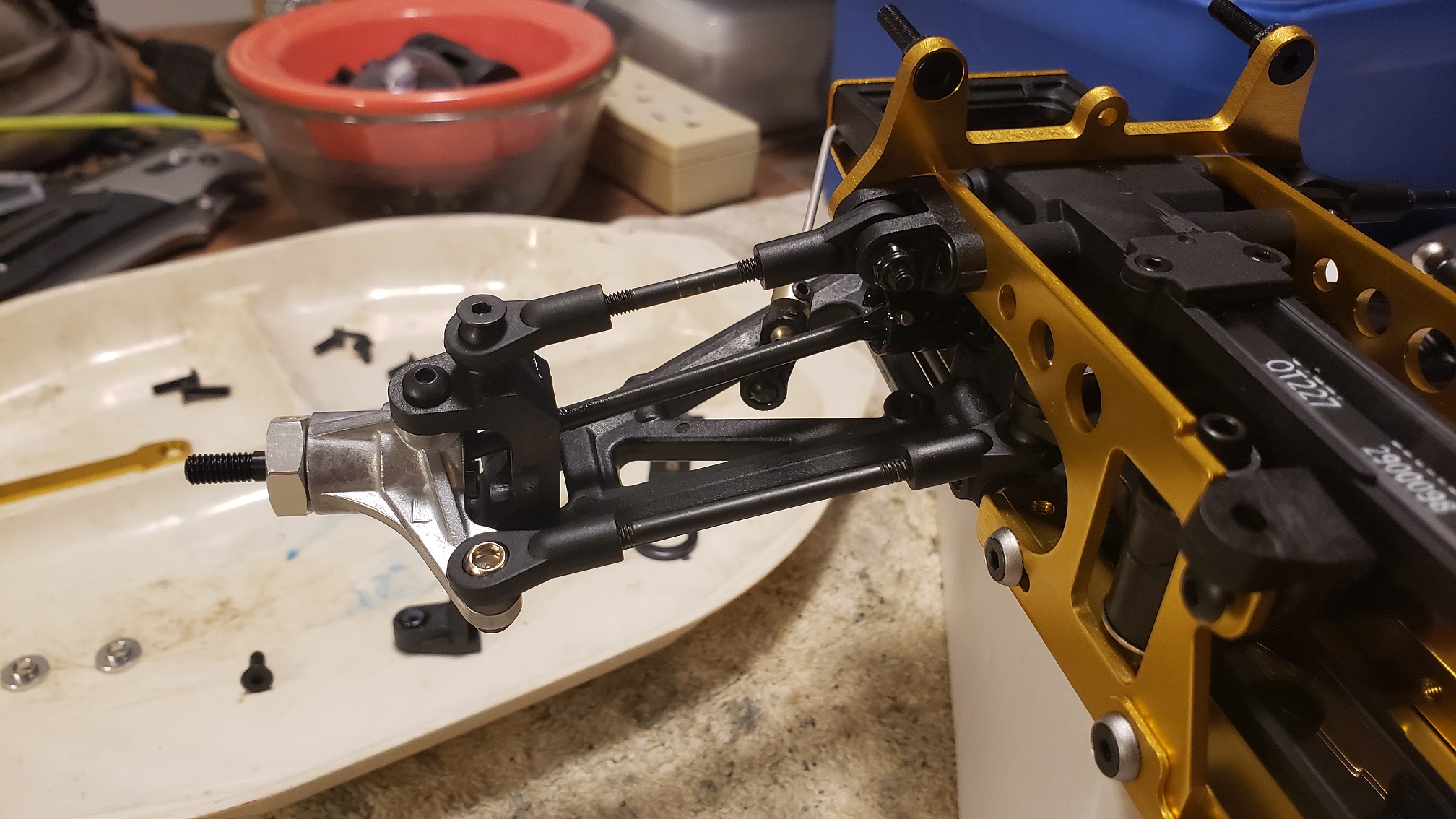

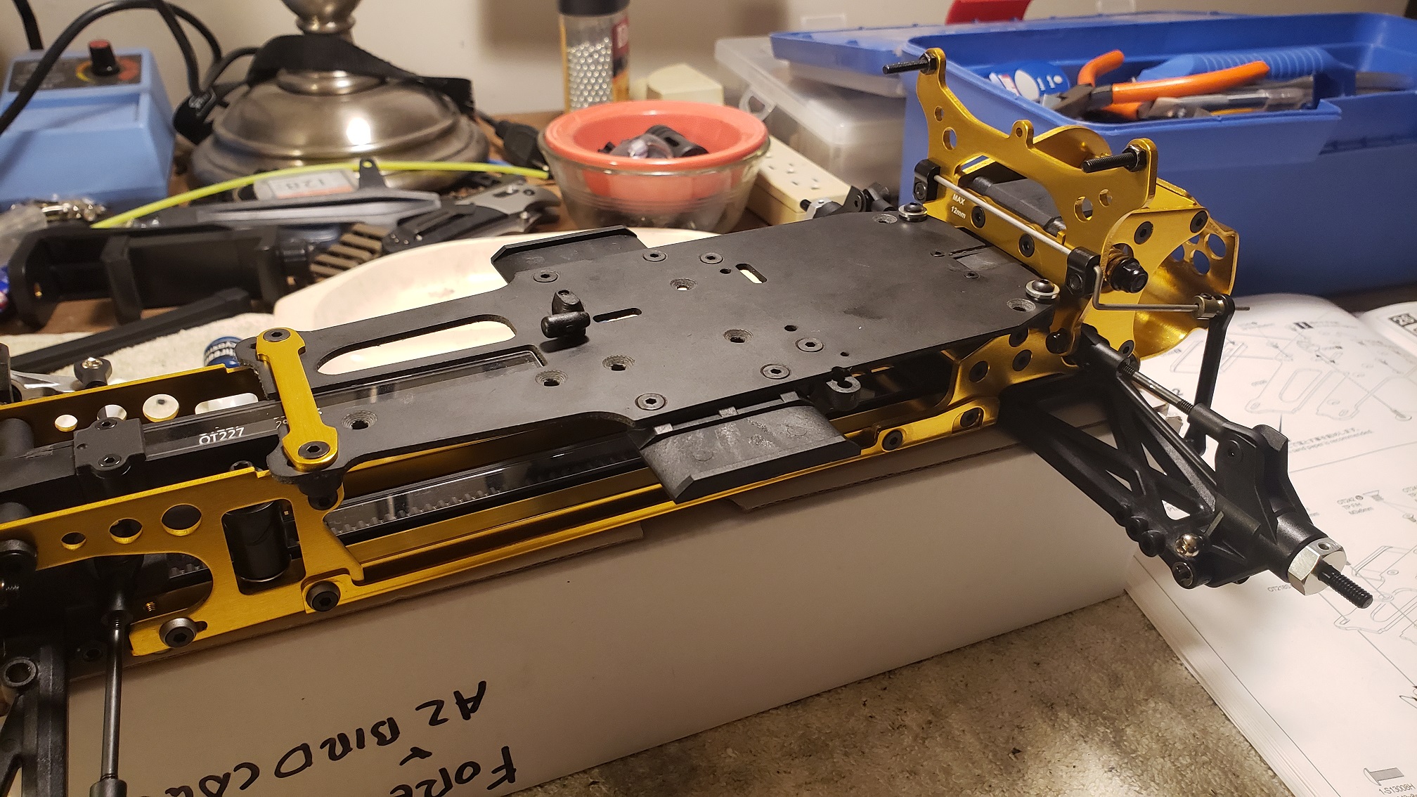

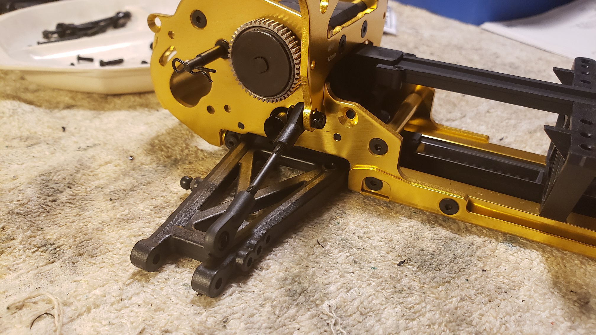

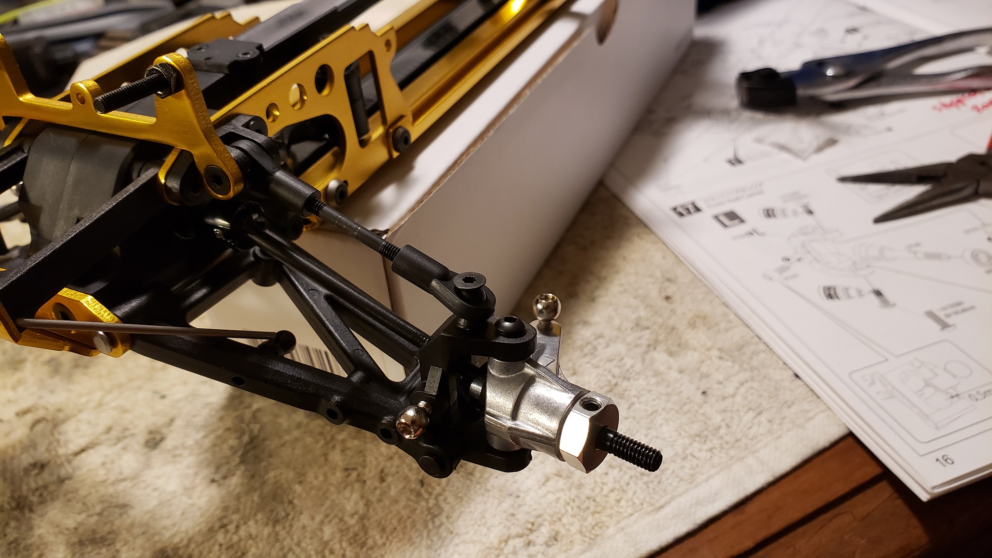

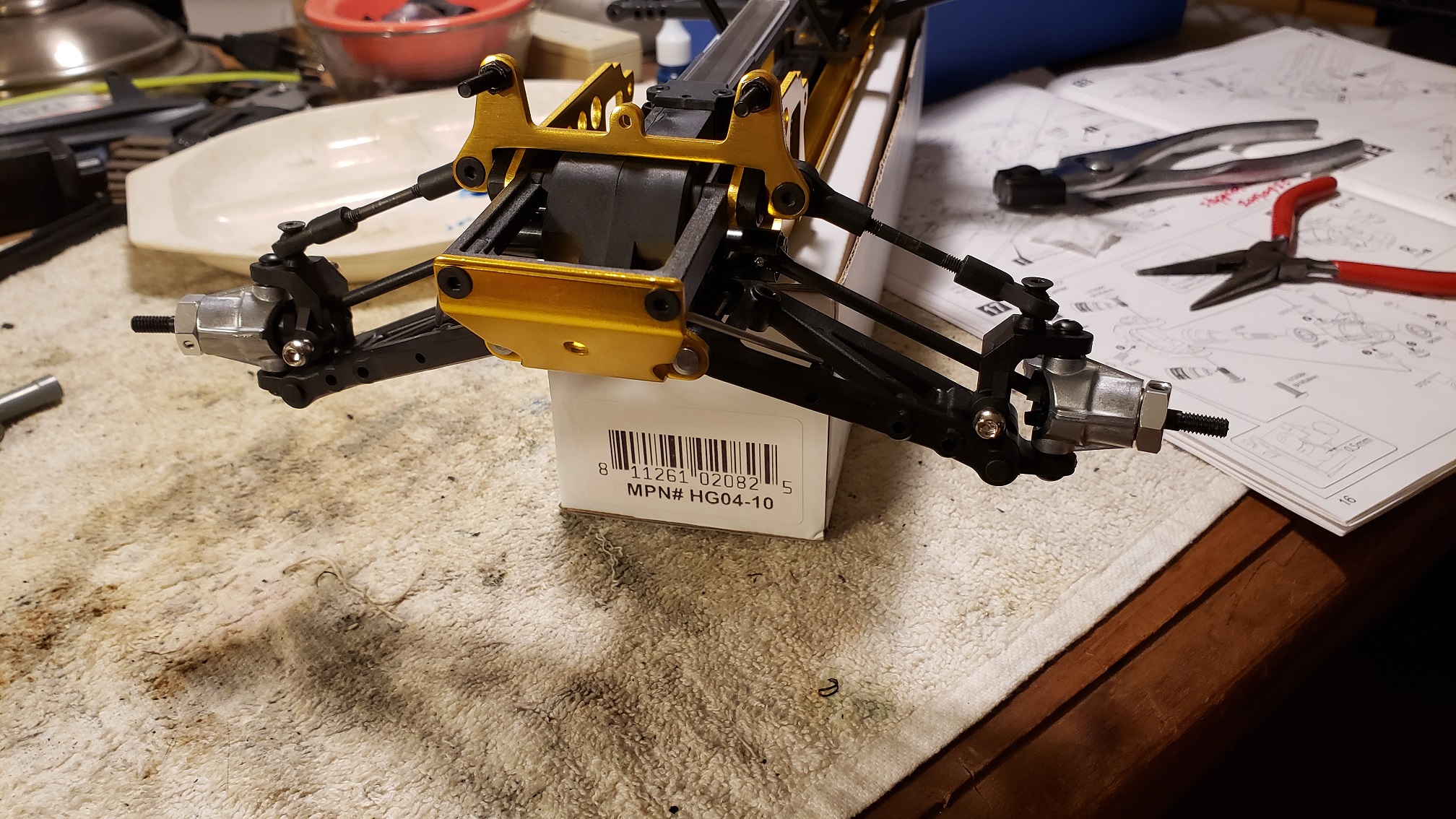

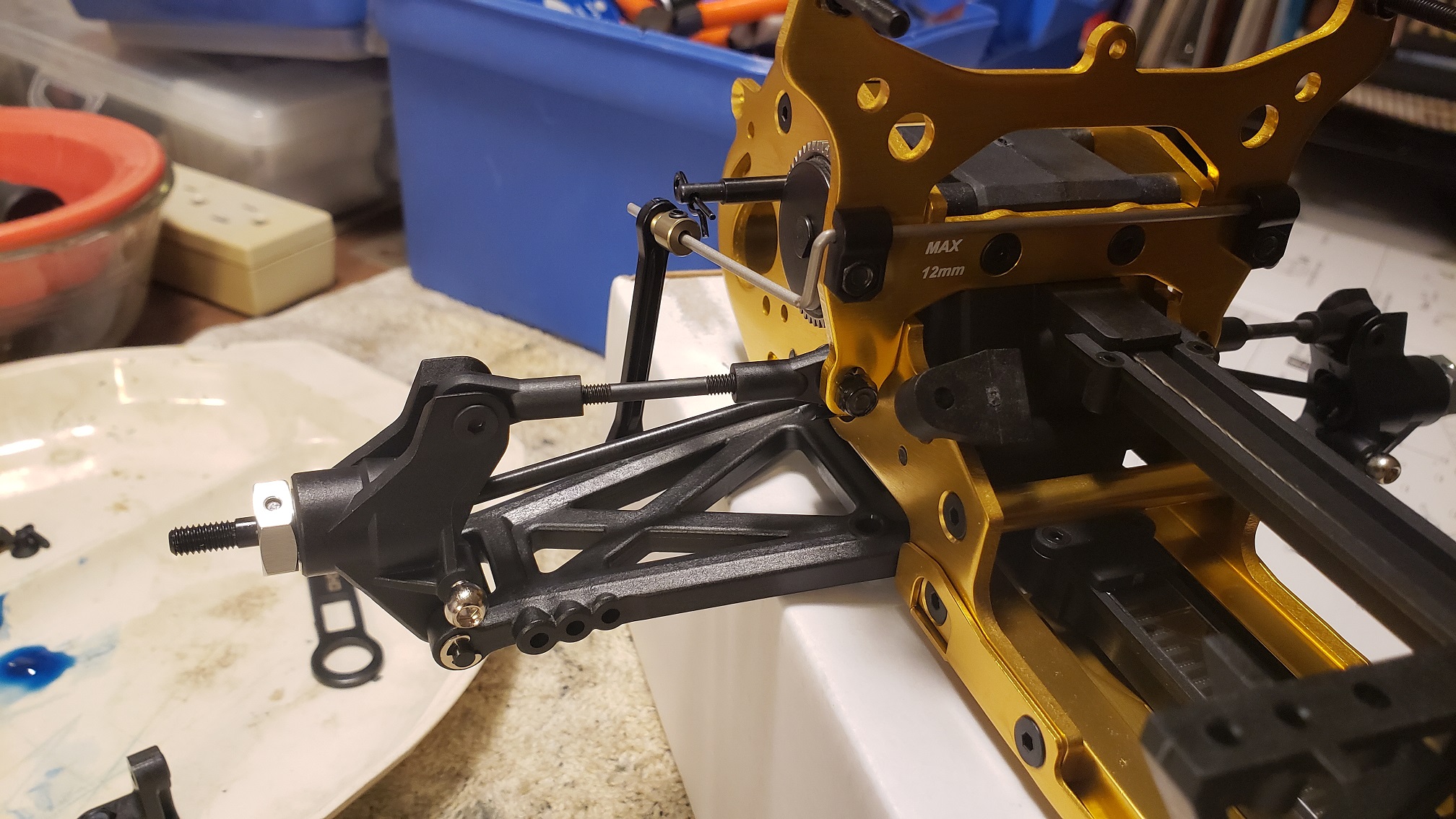

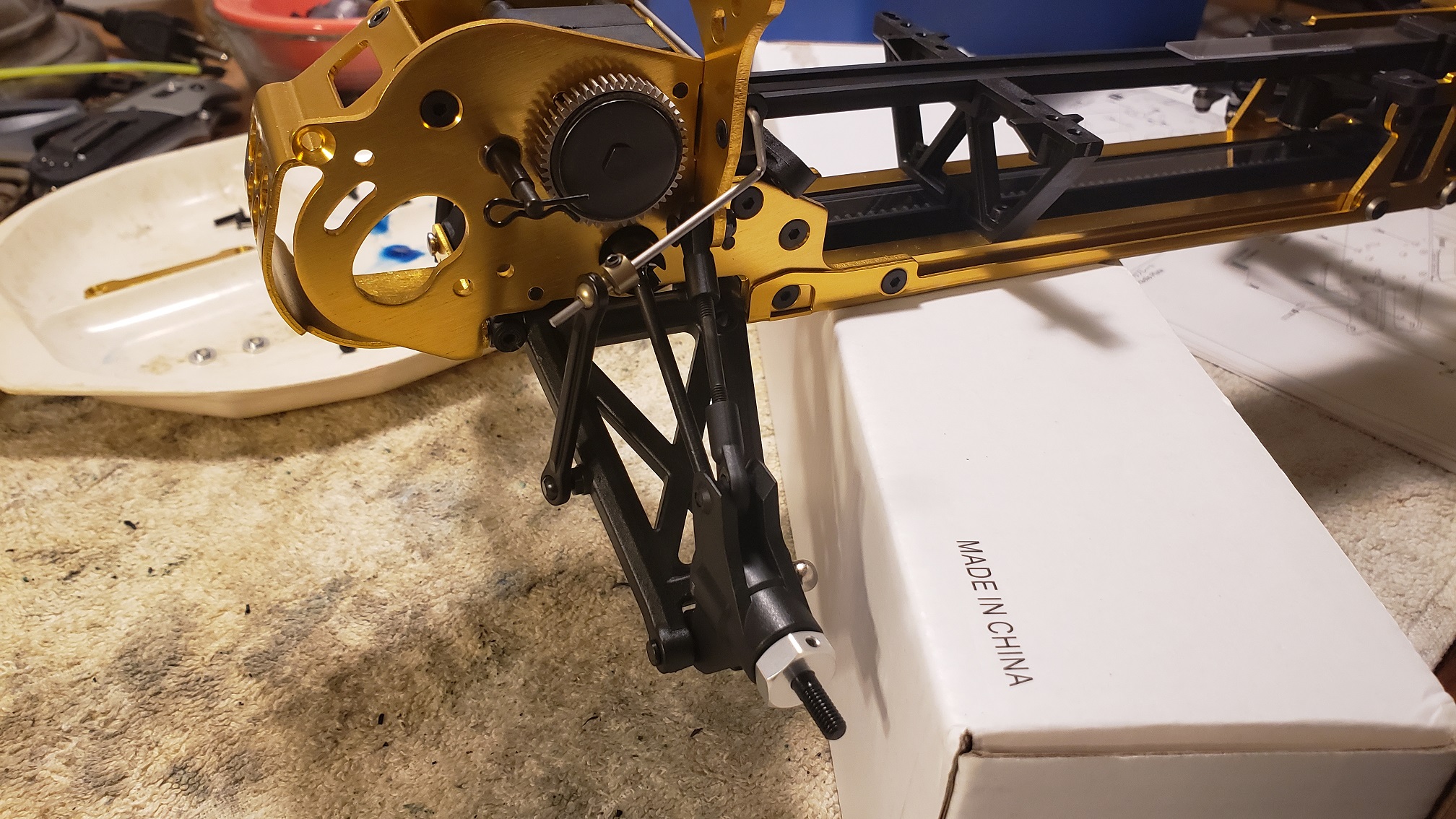

Night 3 progress. It always starts to look like an actual car when the control arms go on. I didn't take that many pictures tonight... quite honestly because I get so wrapped up in the fun of building that I forget to sit back and take some pics.
Plus tonight there was a bit of an "incident" so I just decided to call it quits after the last control arm was on. Tonight was Steps 14 - 16
Front control arms went on no problem.
Then this right rear control arm was the problem. Left one went on easy breezy. For this right one, the holes would not line up and the pin that hooked the control arm to the chassis would not just slide. I tried to force it.... left hand pushing the pin with my hex driver while the right hand held the chassis... pushing my hands toward each other. Hex driver slipped, aaaaaaand I jabbed myself. Lots of stinging, little bleeding, and somehow my left index finger got sandwiched somewhere and swelled a bit. OUCH!
I ended up loosening the screws for the rear motor guard. Once I did that the rear parts of the car moved around enough to line the holes up. Wish I'd thought of that in the first place.
So that's when I decided to cut the night short.
Wide angle of the night's work.

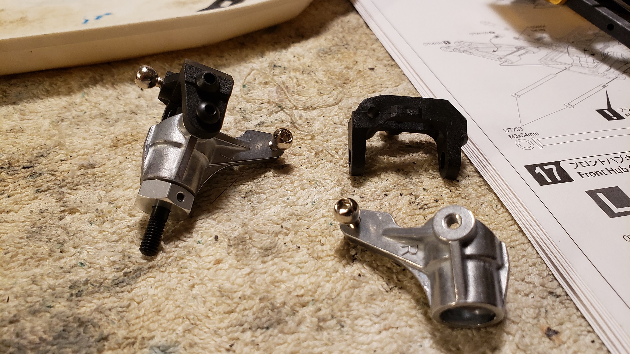

Night 4 progress. Steps 17 and 18. Short night. Didn't get a chance to start as early as I wanted to. Plus lining up steering knuckles is a time-consuming pain in the a$$.

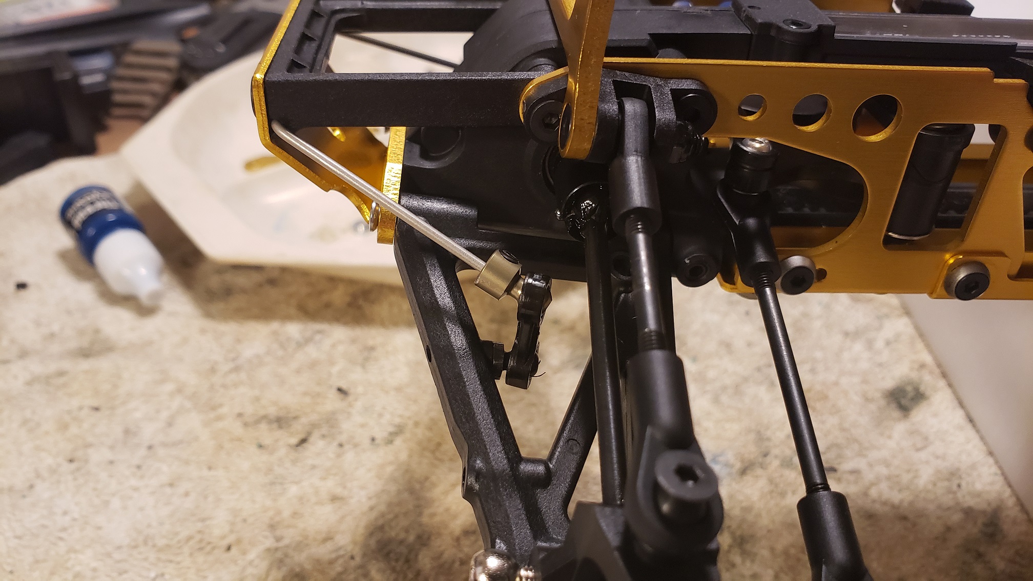

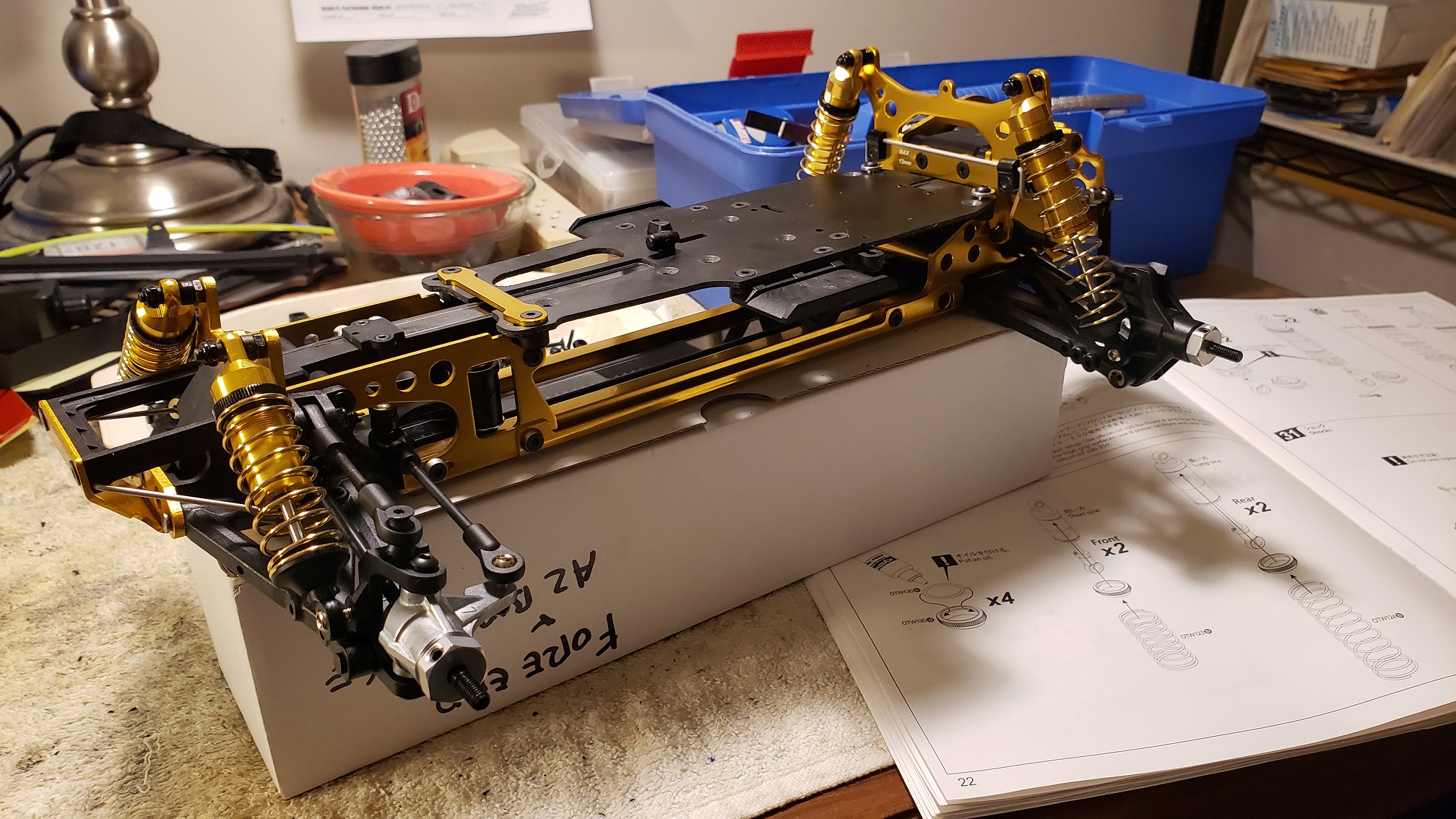

Nights 5 and 6 over the weekend. Steps 19-25, and Step 26 and on: building shocks.
Front end finally coming together to completion.... Installation of the steering rods and the front sway bar.

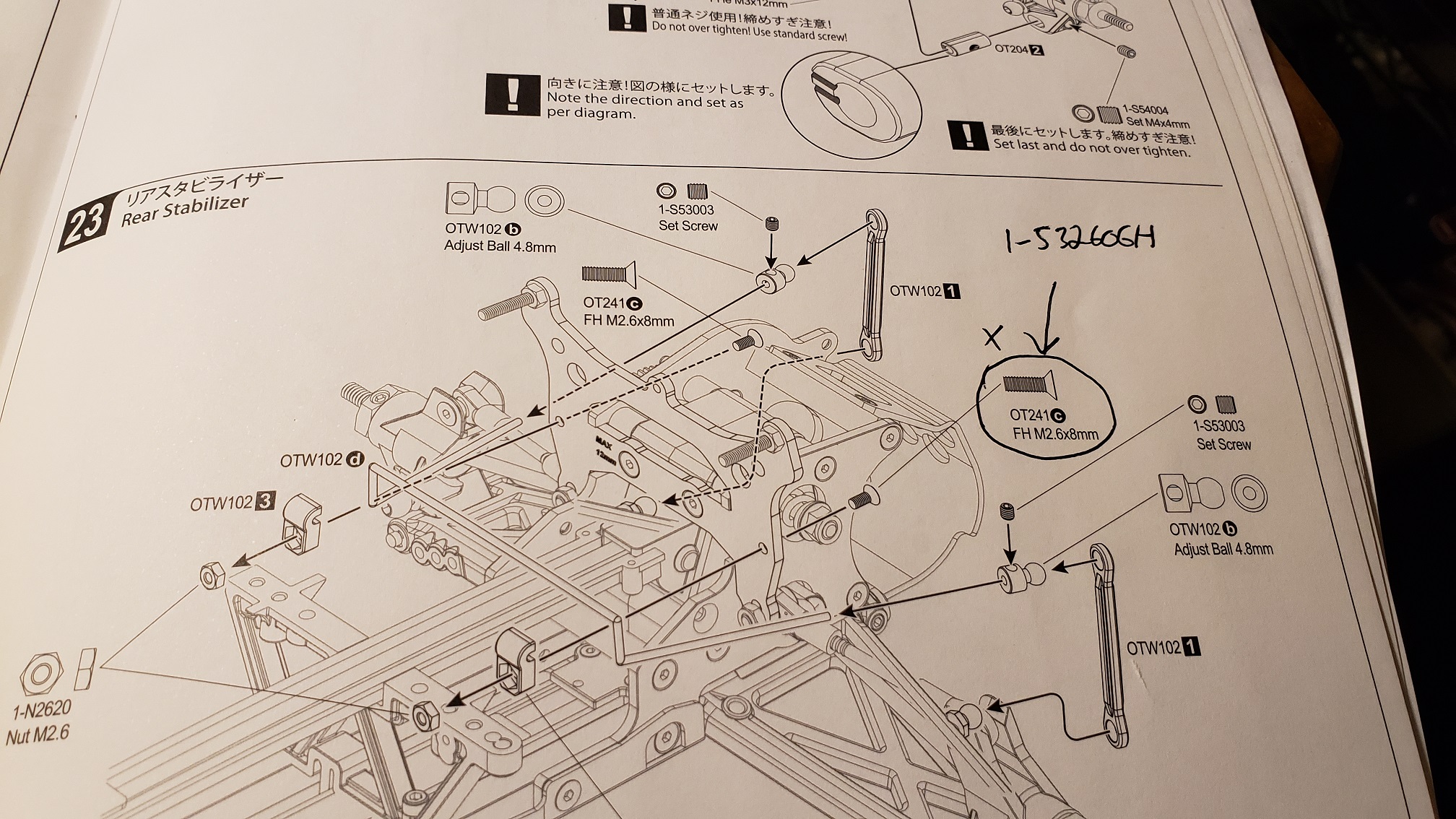

When it comes to the rear sway bar, there is a misprint in the instructions. It tells you to use OT241 allen screw to secure the rear sway bar clip to the shock tower. You actually need I-S32606H. Fortunately that screw is also in the bag so it'll already be in your parts tray when you get to Step 23.
Rear sway bars after finding the right screws.
After installation of the radio plate. Now it really resembles a complete car.....

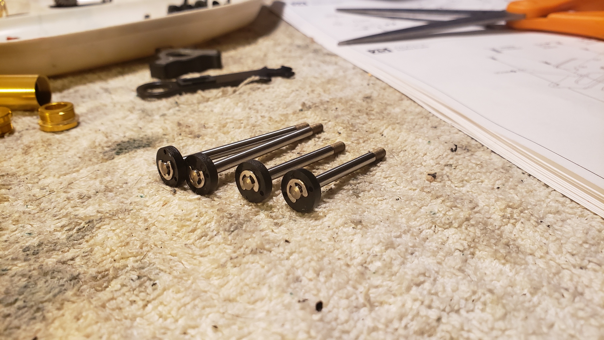

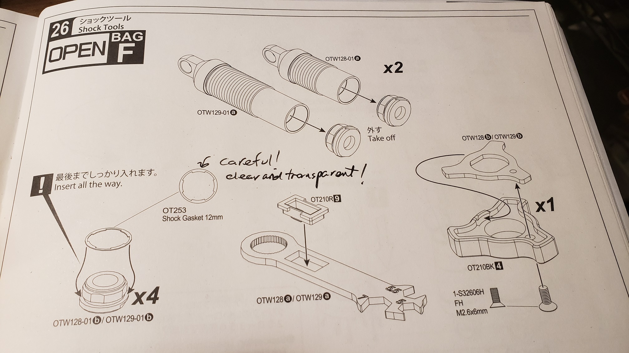

Now it's time to build some shocks!!!! Step 26, Open Bag F.
I want to give a word of advice here. The shock gaskets in Step 26 are SMALL and CLEAR, so they'll be easy to miss. I had to dig in my trash after I had opened all the mini bags in Bag F to find the little bag with the transparent gaskets.
I hate e-clips......
Once the e-clip part is done, building shocks is actually kinda therapeutic

Shocks are on the car, and I have to comment on how smooth they are. Really high quality pieces of technology. I have to say that they're smoother and quieter than my Durango. Amazing.
