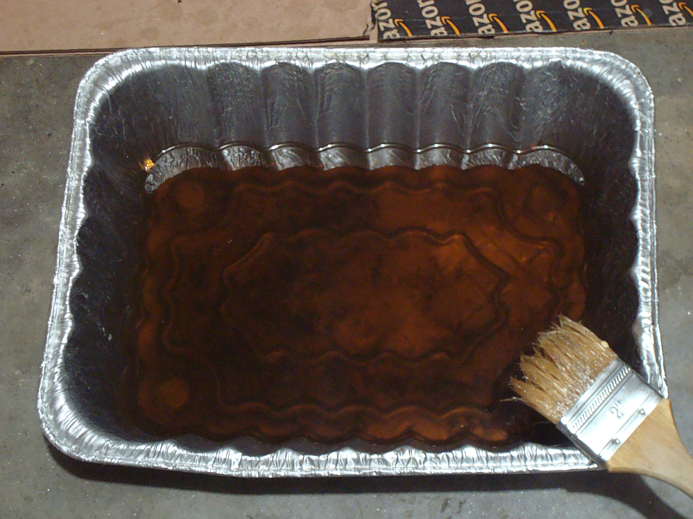

I had some alone time the last few days so I took advantage of two of them by degreasing almost all the parts in the garage.
Around 4-5 hours the first day.
An additional 4-5 hours the second day.
New batch of degreaser for the second day which started out clear.
