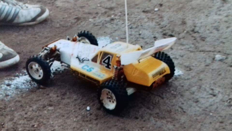

I've been wanting to do a replica of this car for a long time, probably since I was a kid and saw this car in Radio Race car UK.
This car was a classic underdog story 10th place at the Euro's the only 2WD car in the A final. (EFRA did not separate the categories until 1988).

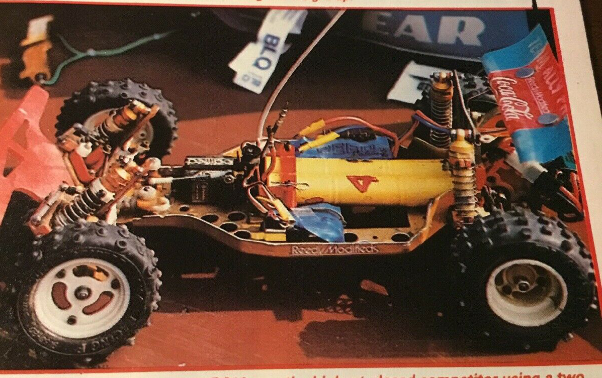

The kickup looks insane on that one!

GoMachV wrote: Mon Jan 13, 2020 12:09 pm The kickup looks insane on that one!
It does! Mine ended up like that because I hacked up my RC10 just like this back in 1987 and eh well I crashed allot. :?
I suspect Jamie did that on purpose since his brand new RC10 that he ran at the 1987 worlds also has that crazy kick up.

What's interesting is that the car is fitted with some very aggressive front tires (presumably to increase steering response) yet it also has increased kick-up angle (and caster angle??) and a front anti-roll bar - both of which can effectively reduce steering response.
Anyway, just an observation.
Regarding the body shell, maybe someone here can help you with that. Hope so.
This is going to be an interesting build. Thanks for posting it here. :D

Most of the racing in Europe at the time was on grass. Grass tracks often turned to dirt especially on the corners. the Tamiya supershot tyres worked very well until they became forgotten when Schunacher launched the CAT in late 1986, an it’s tyres.

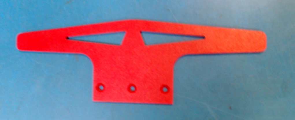

Here is the nose plate, cut up... :twisted:
A little extra kick up ~10 deg, making it 40!!!
The Chassis has already gone under the knife too !
1/2” shorter also.

Oh man, wouldn't wanna be the marshal to be hit in the shin with that...

nicholasdivitto wrote: Mon Jan 13, 2020 3:15 pm Oh man, wouldn't wanna be the marshal to be hit in the shin with that...
Big red bumper :D (same colour as the table) They where mandatory until 1989 i believe.

Would the increased caster angle / kick help the steering response coming back to straight line on acceleration out of the corners? Maybe part of reason? Dunno, just a thought. I guess it would also provide for exceptional straight line stability as well. With all that front bite it might offset the understeer a bit also.
My only experience on grass was with the old Blackfoot back in '88 or thereabouts.
