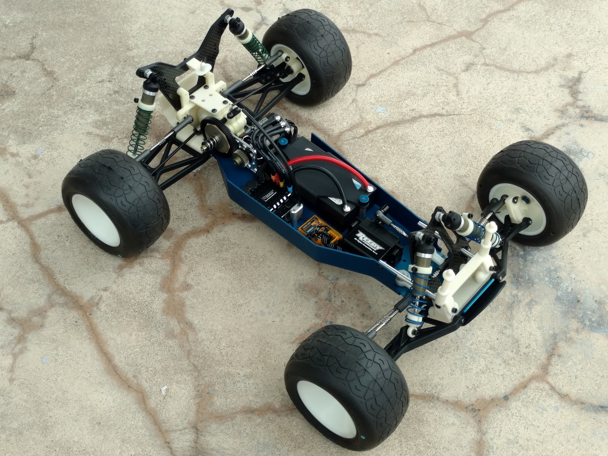

Black pan trucks tend to flex too much and require bracing of some sort. The truck Jason built is one of the nicest I've seen.
Lots of beautiful examples of converted GT's.....
Here's a blue pan that I converted and drilled for a short wheelbase to fit old bodies.
