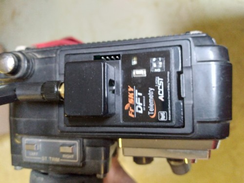

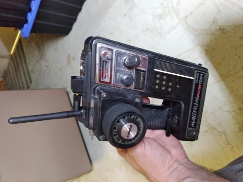

- RadioFlyer
- Regular Member
- Posts: 28
- Joined: Thu May 01, 2008 10:57 pm
- Location: The Valley
Re: Converting Futaba FP-T3PB to 2.4?
If you can still find one these work great.
https://www.getfpv.com/frsky-df-2-4ghz-combo-pack-for-futaba-w-module-rx.html
https://www.banggood.com/FrSky-XJT-2_4Ghz-Combo-Pack-for-JR-w-or-Telemetry-Module-With-X8R-Receiver-p-1060775.html?rmmds=buy&cur_warehouse=CN
I included the Banggood link because it's available but that's double the price of the one I got from HobbyKing about 7 years ago.
I still used this radio a few years ago for some indoor racing. I've since lost the battery cover.
Sean
I'm going to drive it 'til the wheels fall off and burn.
