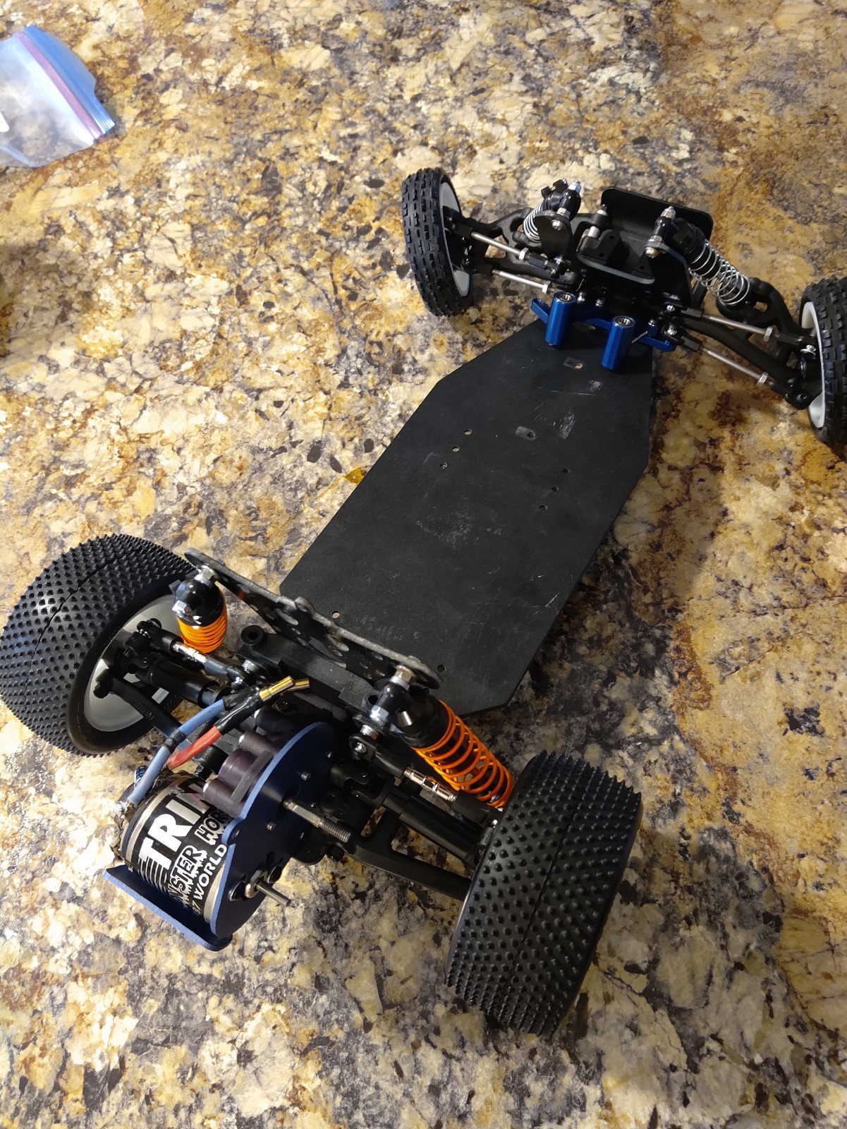

The chassis needed a little love... there was a pretty hefty ding in the CF that I filled with a mix of epoxy and CF dust from sanding another old CF piece I had. Got it straight and tidy... then modified some Slash front caster blocks, and put some Bandit spindles and axles so i can use old "pin-style" wheels or put a hex in and use modern 12mm hex wheels. The aluminum steering rack is for a Bandit/Slash, and is still not mounted... trying to figure out a way to mount it on long screws, but with something like a brass/steel/aluminum sleeve so the bearings will ride on it smoothly. The old TRX1 is coming along with it's body and wing done... just a few more random items and it'll be ready for electronics. Otherwise... this is where we're at now!
Thanks for looking!
