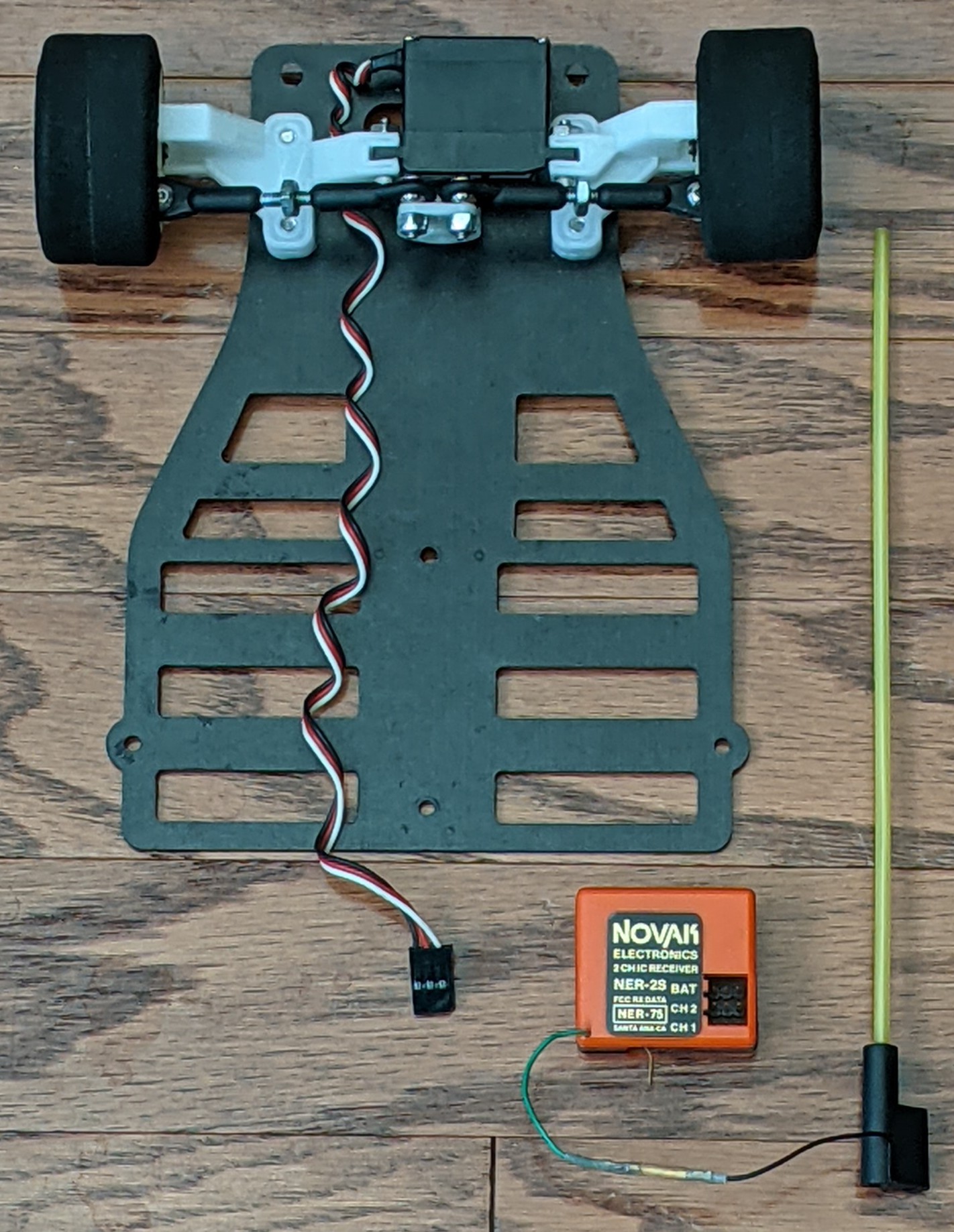

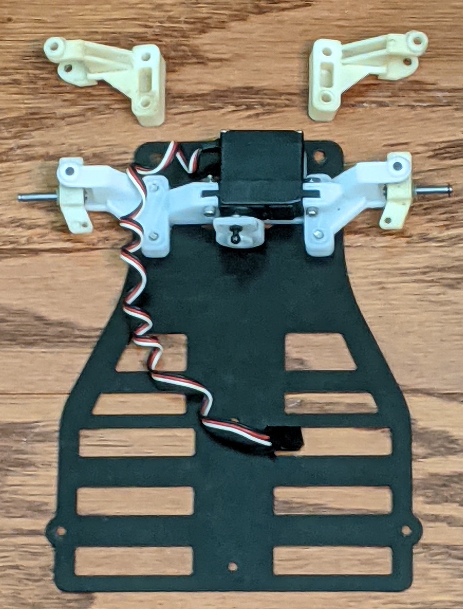

How much can a RC12L really be changed from stock? It's like 2 front suspension arms with a motor pod on a pan chassis.
Well, I guess step 1 is change out the front suspension arms. 😁 I already had this mini servo that just seems right for a 12L. So why not 'stick it where the servo don't go' and free up some space for receiver and ESC? I'll have to iterate one time on my front suspension to add in a servo wire tunnel under it. Oops.

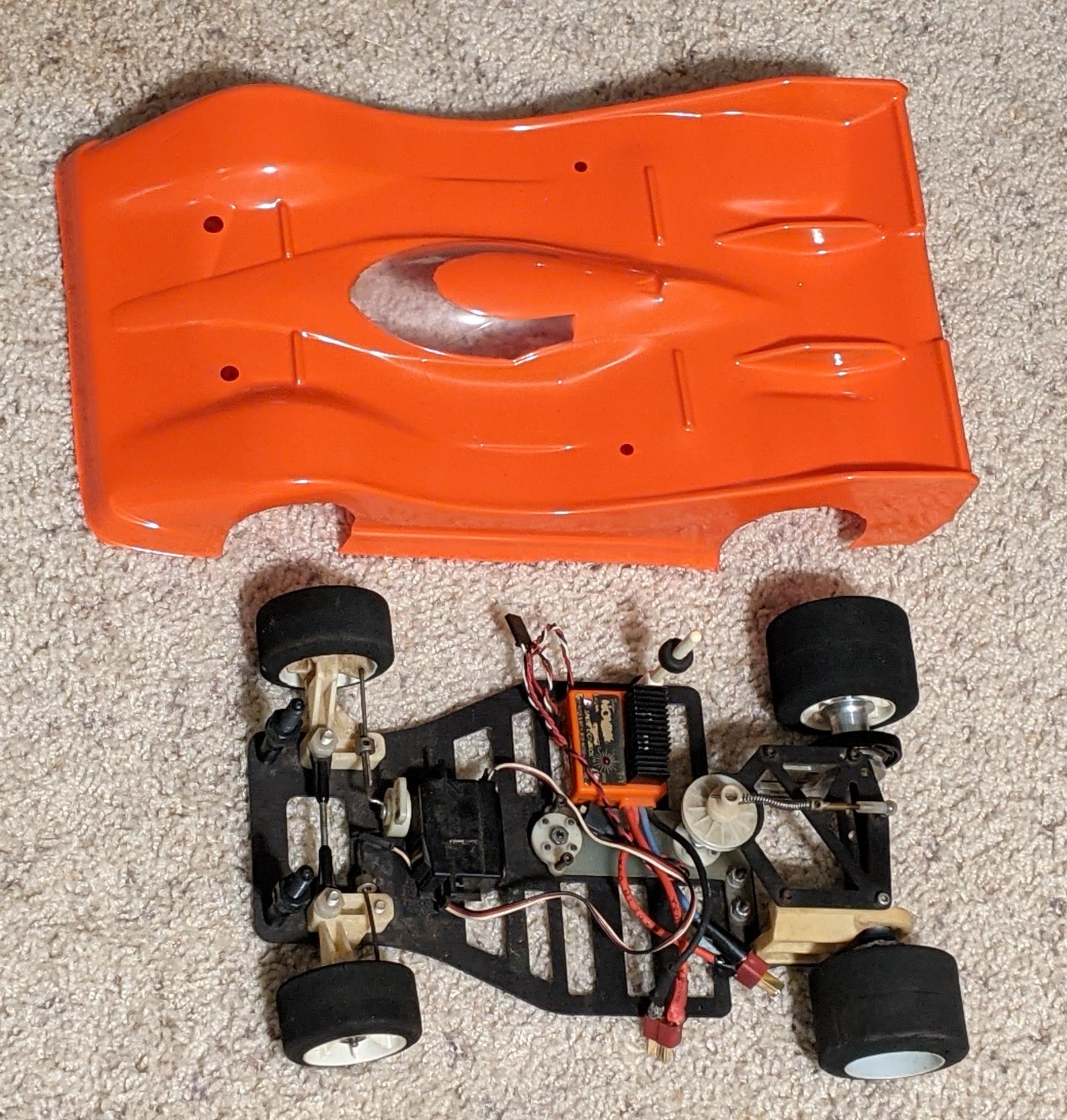

Frankentruck wrote: Wed Nov 10, 2021 4:27 pm How much can a RC12L really be changed from stock? It's like 2 front suspension arms with a motor pod on a pan chassis.
You'd be surprised... :lol:
https://www.rc10talk.com/viewtopic.php?f=37&t=35541&start=108
This is a 12L3 resto-modded to take brushless and 1S LiPo, but similar enough to a vanilla RC12L when it started out.

Oooo! I like the GNX body!

I picked up some 1/4" aluminum rod, polished it to size, threaded one end, put some green loctite 638 on to lock the diff gear holder in place, and now I have an ok axle.

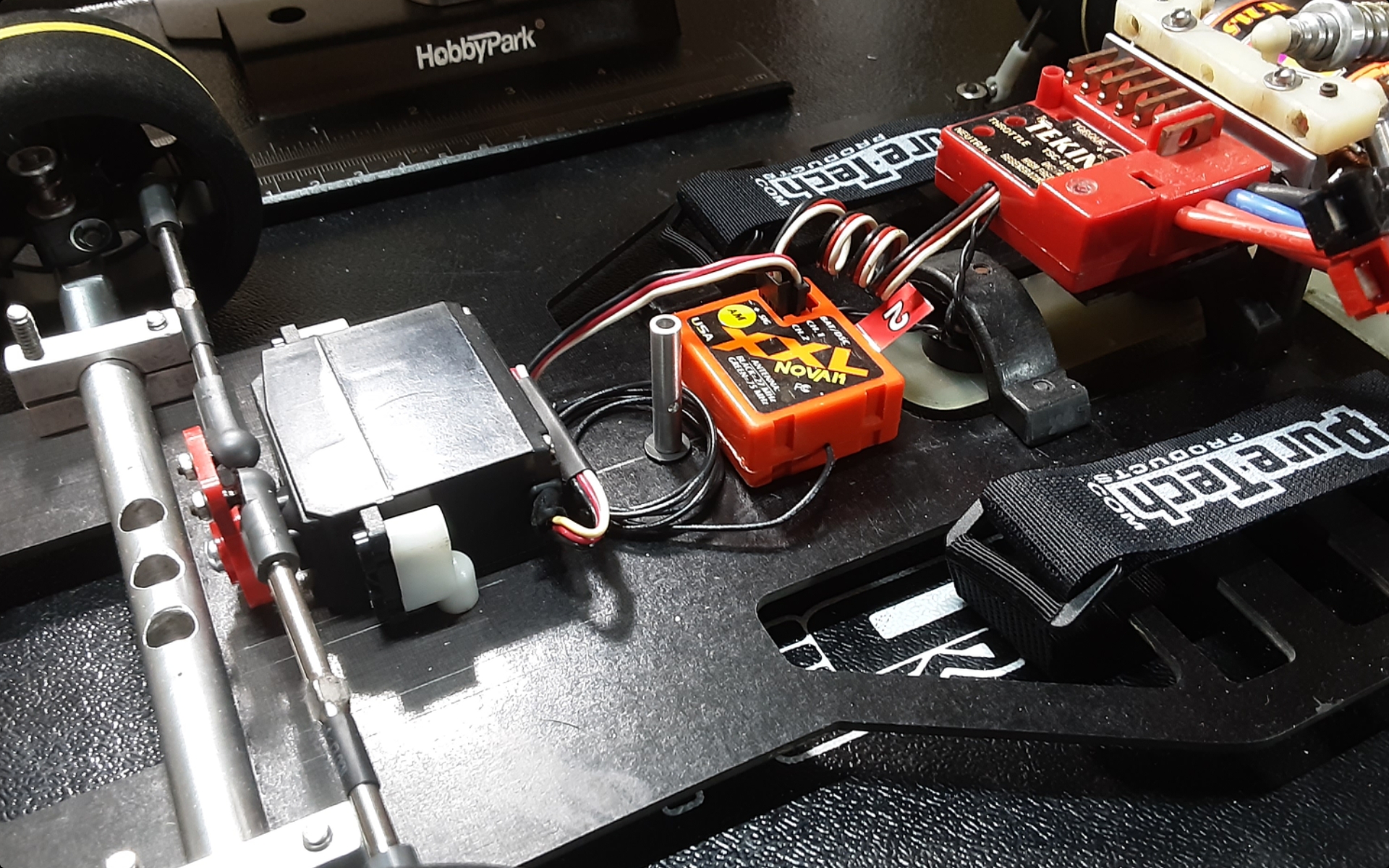

It looks like RJ Speed might have something better that might be compatible, but this is good enough for a little around the kitchen trial, especially since my newly acquired Novak XRS showed up today. Put some connectors on the XRS, throw in a no label 15T double, and almost ready to go.
Unfortunately my ESC operation was way too glitchy. It turns out it was the receiver. I might have to ditch the Dean's antenna and wire in a correct length antenna to see if that makes the old NER 2S usable. So the maiden voyage ended up getting a Futaba R162JE receiver thrown into the mix. Strap in a 6 cell stick pack (will be running 4 cells normally), and wow this thing is overpowered! 🤣 There's no traction compound on the tires, but creeping around at minimum throttle is the only way to keep this mean little sucker from hooligan drifting all over the place. The wife is not impressed, but the son is. 😁
The XRS looks to be small enough to mount on the T-plate between the halves of the 4 cell pack. It should end up a tidy little package, not like what was cobbled together for the trial run.

A new antenna wire made the difference. Now I just need to come up with an antenna mount. I have a fiberglass anti-tip antenna mast that I think I may use.

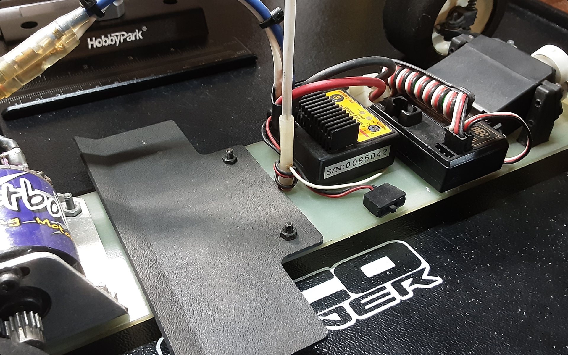

The antenna mount seems to have worked out ok, although I won't really know for sure until after a few racing tip overs. I do like the AE 4510 fiberglass mast rod and antenna wrap setup. I remember the fast guys used to have this setup so they didn't have to wait for track marshals to flip their cars back over.
