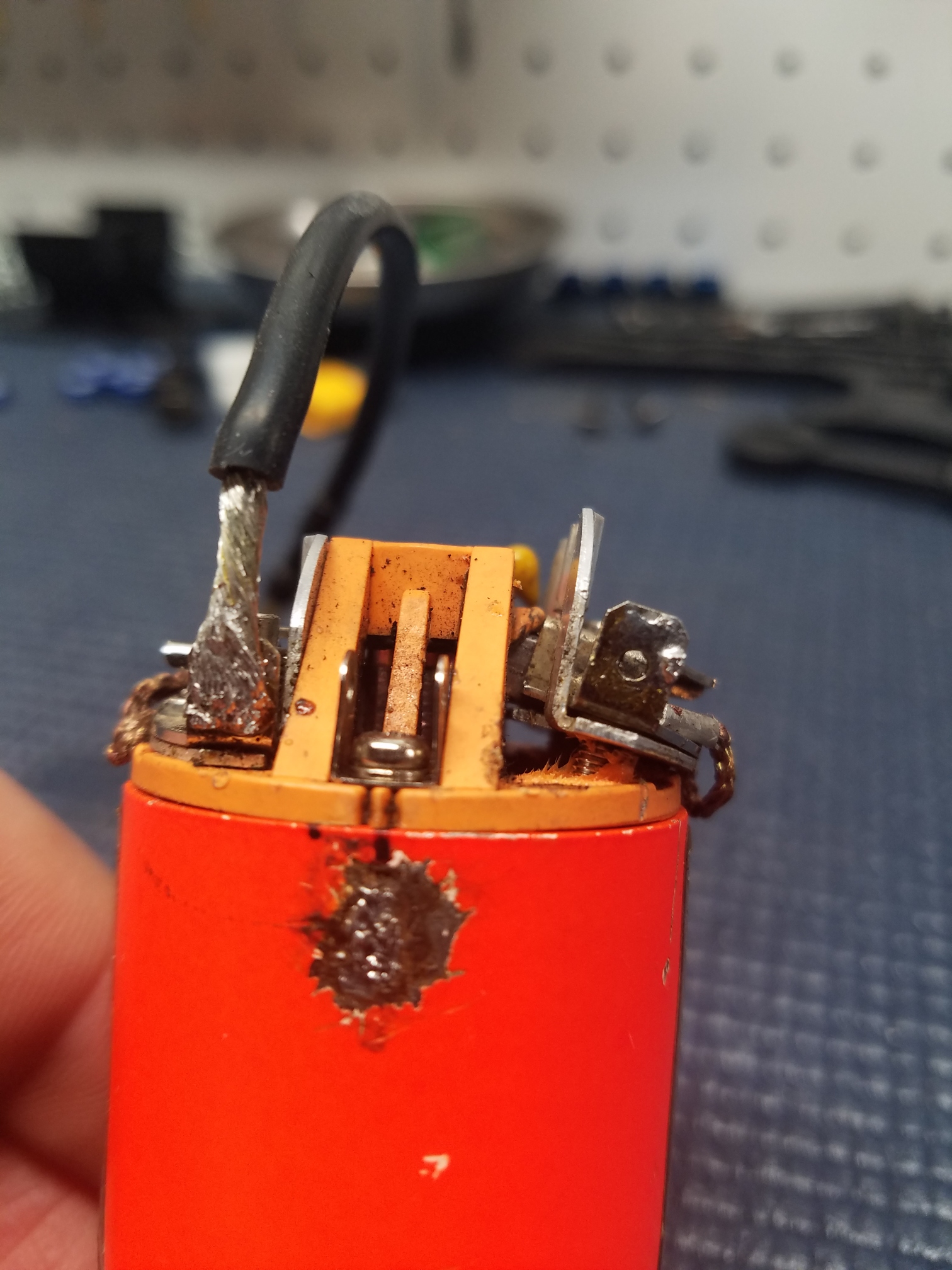

Just be careful/mindful with todays high capacity and high discharge rate batteries, especially Lipos. You can very easily, unintentionally put your brushed motor(s) thru a nuclear meltdown. As my brother and I did to a helpless Speed Gems Topaz motor over the weekend.

As above the modern lipo's last way longer so heat builds more in the motors plus they maintain their voltage much better under load so it's very like an 8.4v nicad that lasts for 30+ minutes driving = roasted brushed motor :(

Stuff happens when you get carried away putting a whoopin' on your brother's brushless truck with your 4200mah Lipo powered, 30 yr old school 40k rpm brushed motor setup.... oops :shock:
This motor was freshly rebuilt with brand new 11x3 armature, bearings, brushes and springs. Freaking thing ripped though for a good 15-20 minutes... :lol:

Is the armature ok? If you only need an endbell, that motor might be recoverable.

Frankentruck wrote: Tue Apr 12, 2022 1:42 pm That'll buff out. 😁
Yes sir, it's salvageable except for the endbell and one brush that had a significant piece of real estate removed during the meltdown process. Comm on the brand new armature is a bit on the blueish side now-a-days, but I'll indeed buff that out with the comm lathe and see how goes.

R6cowboy wrote: Tue Apr 12, 2022 3:02 pm
At least that endbell has removable brush hoods. They can be salvaged as well.
That is one of my favorite things about Epic based motors, the removable hoods. Most of my Yokos and early Trinitys have sweaged spring posts.
