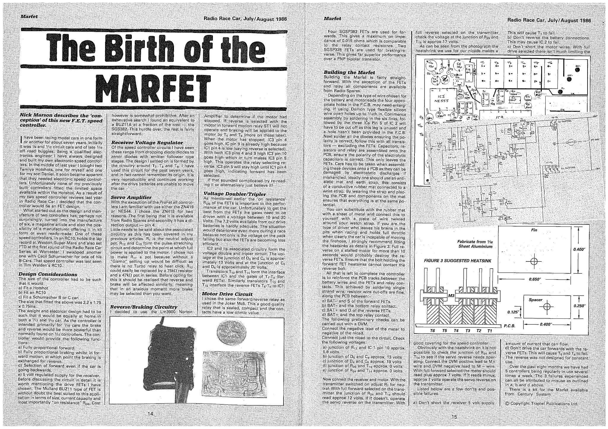

Another cool bit of Marfet technical info.

I don't suppose you have a circuit diagram ? After replacing all the FETs it's still dead but now the relay clicks and the break FETs warm up , I found a short across the main drive FETs and assumed one of the new ones was a dud so removed them again only to find the short is on the board still . The original owner applied a waterproofing resin to both sides of the board and I can't remove it without removing the part numbers of the smaller transistors so a circuit diagram would be a good send .
Re: 1985 Marfet ESC (Pre-Nosram)
Posted: Mon Jul 11, 2022 10:18 am
by dinglem
All I have is what is shown in the above article. I will pass your comments on to Nick Marson who might have some suggestions also.
