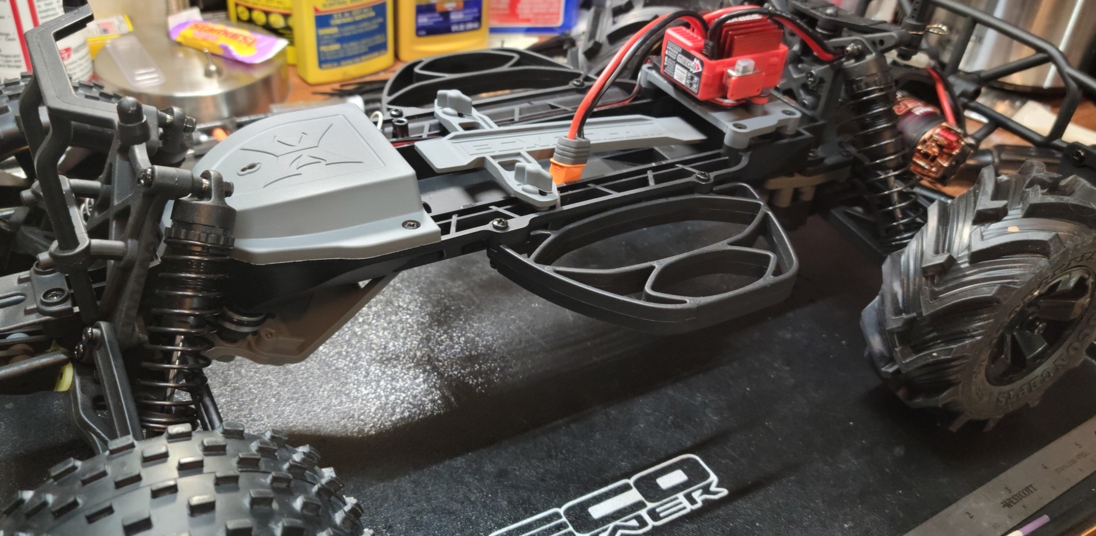

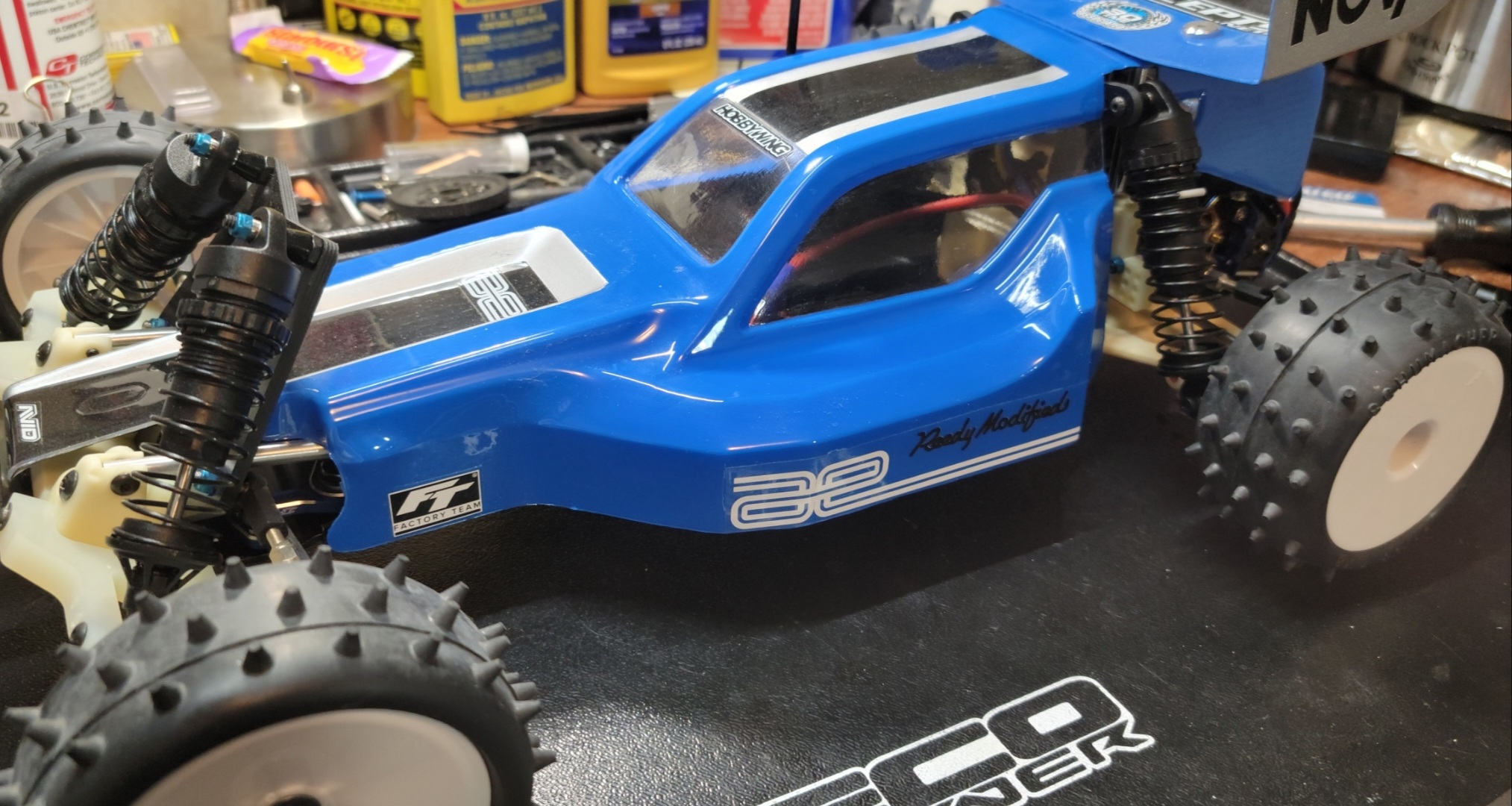

Here are a couple sets of these that I've built. Depending on the exact parts you choose, these can be built for ~$40 a set.
RC10 with the RPM Worlds style front. This set was probably closer to $50, as they used higher quality shafts, springs, and cups.
This set is on a ECX Torment. They were under $40, with Traxxas shafts and the rest are MT10 parts.
