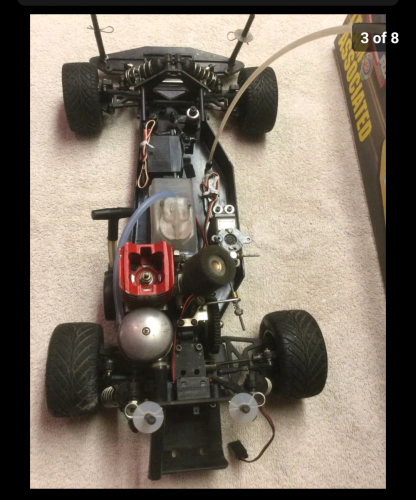

My search skills might be failing me, but what is involved in converting a nitro RC10DS into an electric DS?
Maybe need:
B or C stamp chassis
Buggy stealth gearbox
Motor plate
Rear shock tower
Rear bulkhead
battery cup
Anything else?
Maybe need:
Motor plate
Rear shock tower
Rear bulkhead
battery cup
Anything else?

I'm not going to cut anything up, but I prefer electric and I had a build plan. I just couldn't pass on this one though.

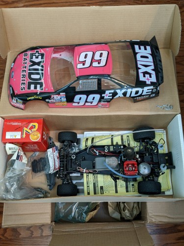

Moo ahh, ah ah ahhh.... The future electric DS has arrived. The Exide Batteries decals seem like fitting foreshadowing of the future.
