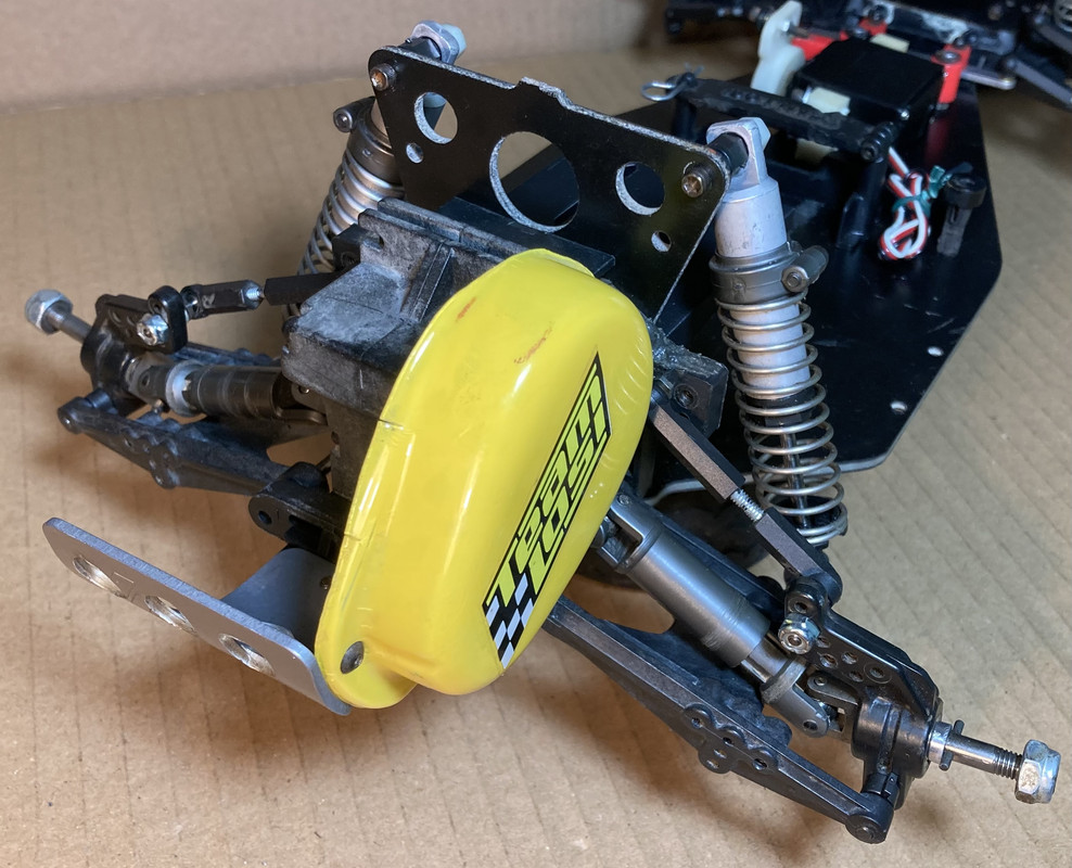

Moving along quickly since I am doing minimal cleaning. The 30 year old servo tape came off rather easily with a razor blade and goo gone…looks nicer than I thought it would!
Crusty! Flirting with disaster on this steering setup..but I have more parts if they break.
Yep… someone JB Welded the wing tube holes up on the rear bulkhead for some reason..? Don’t miss the speed holes in the motor plate and front body mount! :lol:

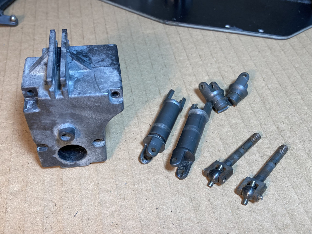

Transmission complete. Pro top shaft and gears..a used ball diff and bearings that didn’t feel too bad, so in they went. I don’t have many of the Jrx2 outdrive spacers left, so I installed LXT outdrives that don’t need them. (The LXT outdrives are basically a copy of the #7321 RPM outdrives)
Ready for tie rods and shocks.

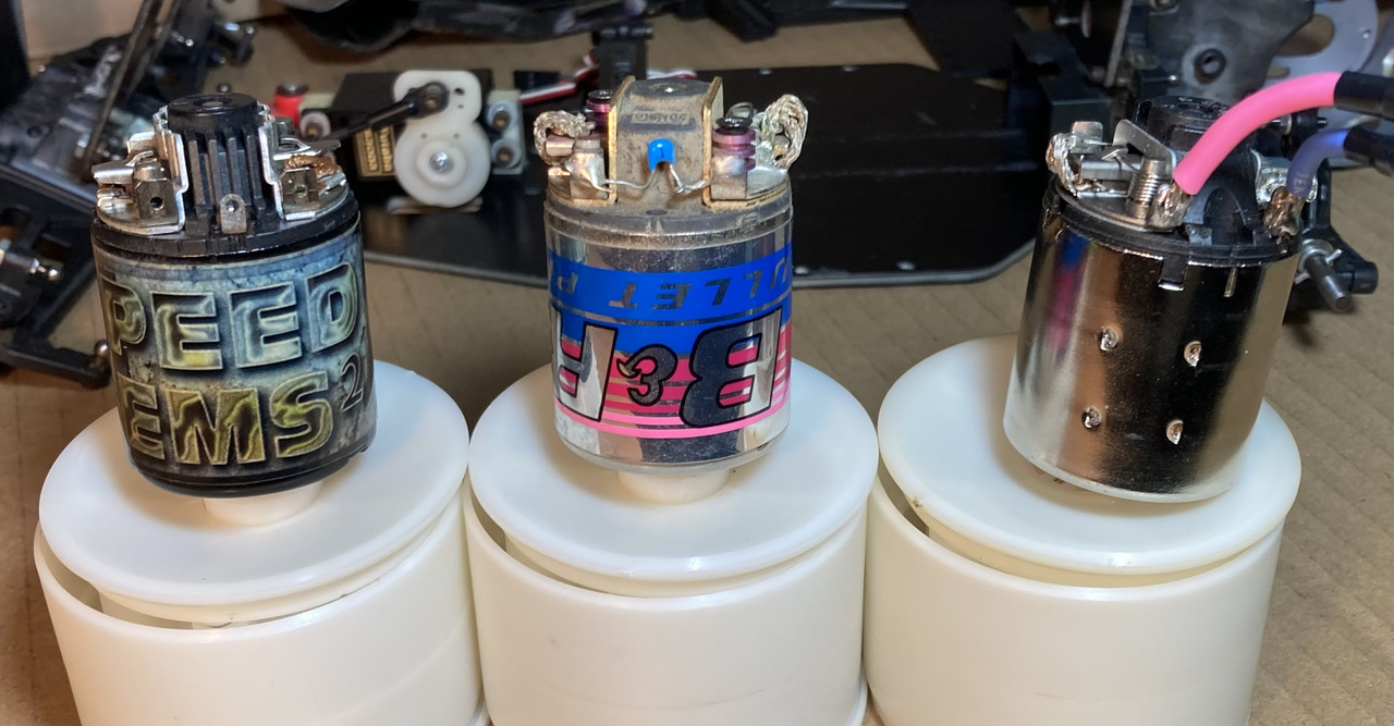

That motor is a Slot Machine 1. My other choices are a B&R Bullet Pro or a Speed Gems 2 Onyx.
Re: The Ugly Truckling JRXT
Posted: Sat Sep 17, 2022 9:01 am
by Frankentruck
Oh there are options? The SG2 Onyx seems like the choice to make. More power, has bearings, can be disassembled for cleaning, has more power...

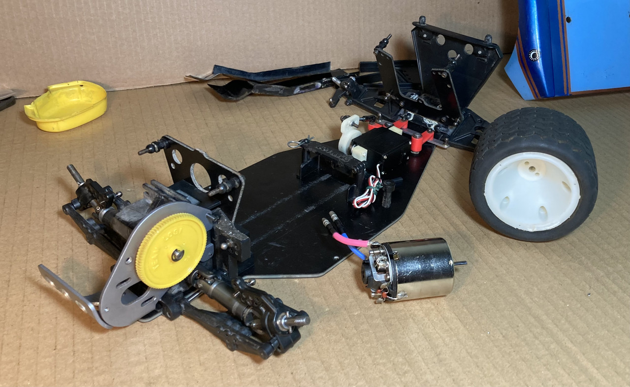

The chassis is complete now. Shocks look rough on the outside, but have polished shafts, used Teflon pistons inside, and used cartridges that still had a nice drag/seal..no leaks so far. The camber and tie rods are proudly total cheese though!…used long & short RPM rod ends with scrap 4-40 rod bits..but they solid!
Despite how ugly I want to make this thing look.. I’m also trying to beef it up to take some bashing and abuse. Upper shock mounts changed to the later design..ball studs reinforced with locking nuts..also used a 7/8” screw for the lower rear shock to make sure it goes all the way into the H arm.
