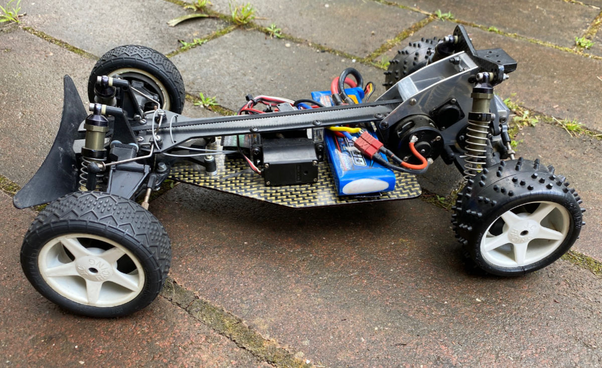

Well it's coming together (how nice to be building a Schui again!)
I had in stock (HTF did that happen!?) a correct later front trans casing so with that now fitted I can now adjust the belt tension.
Bitsa of course, -homemade carbon/Kevlar chassis plates, fabricated alloy rear diff housing plates and acrylic casings (ooh transparent- see those whizzing belts!)
Ready for a test drive, but it's too wet at the mo, but it goes... seemingly nicely -the cat will affirm that.
Next - an order to Schumacher to get a few parts (re-re- great! some parts I could not get 'back in the day - but better now hopefully) - def' front upper wishbones, I probably will splash out on a new body kit, plus rear susp/wing mount.
I hope unzud Craig enjoys my 2 Procats (in the mail), sad to part with those, but I feel very lucky to have got the parts together years ago to build this ol' bitza.

Well that’s different for sure. Never seen anyone use the cougar steering levers on a cat before :shock:
Would love to see more pics👍🏼

Right that makes sense Choco- (though it's a bit of a 'klutzy' solution compared with other pretty sophisticated Schui engineering solutions eh?)
Yes Retro... as I said it's very much a bitsa! Made from all sorts of miscellaneous parts left over from 2 Procat and 2 Cougar restos plus a fair bit of fabrication.
Seems to work though, mind you I haven't used it 'in anger' yet.

Any updates on this one? How did it run? Cougar steering work out ok? Did you add a belt cover or run it exposed? With my luck I would not get very far with an exposed belt.
