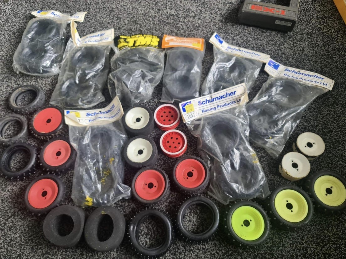

In the box was also a pile of rims and tyres, and quite a few pairs of early Schumacher CAT spikes (lovely) as well as some TMS and SRM foams. Also included were a few well-used brushed motors, the MG Power Mick Goddard mod and a Checkpoint (etched 13 II) look pretty good though, as does the gold label Twister. One of the Revolutions has a K etching on the base so a 'Killer.' There are also several complete diffs, a pair of gearbox upper caps and some Andy's steering hubs, new ball races, 870c steering bell cranks and lots of odds and sods.
