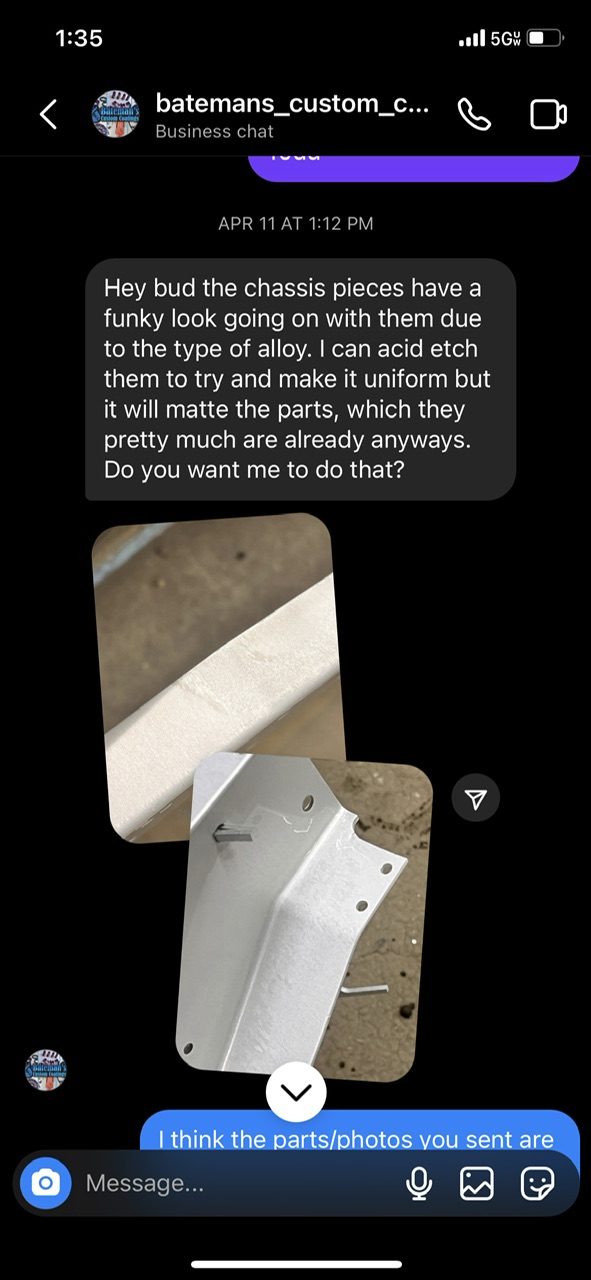

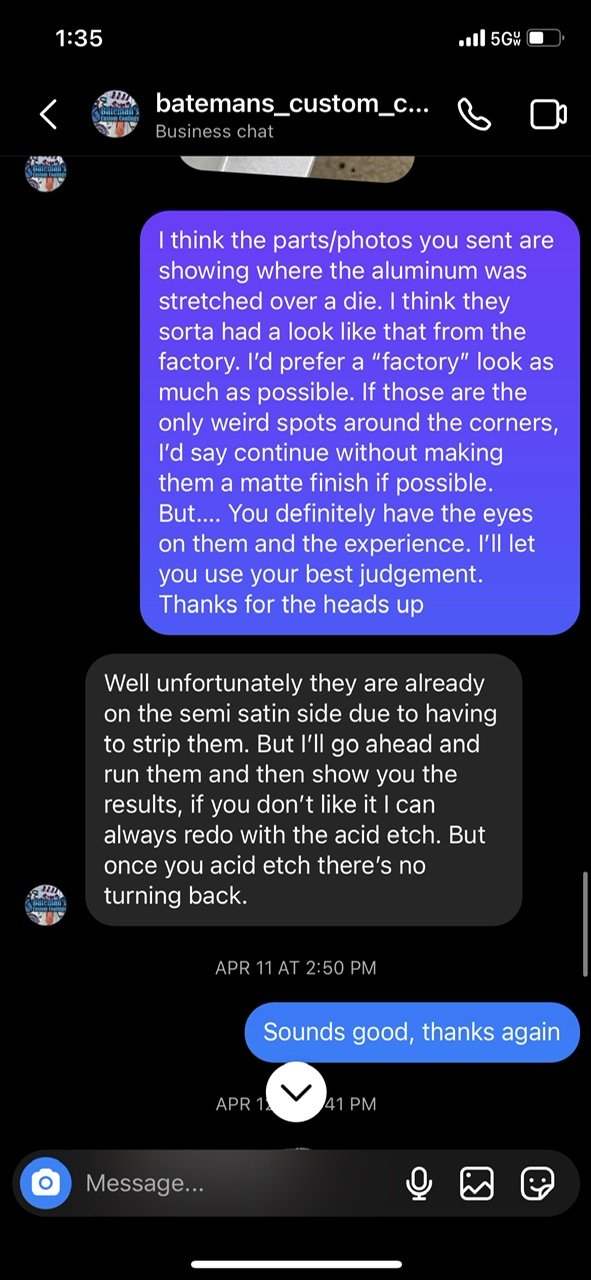

I used Batemans and the service and price was great. The gold color he used is a pretty good match (edit: some of the later darker chassis) but unfortunately he had to strip my chassis from black. Because of this the chassis has a sorta dull color to it instead of a slight sheen. Maybe there is more to prep the chassis to get the factory finish back but I wasn’t too pressed for it to research. I will edit my post with a picture when I get home. Just wanted to comment on the great service and communication I got using his service. That alone goes a long way with me.

I had similar results and worked with the anodizing service to identify the issues. The dullness has nothing to do with the starting color. I sent gold chassis for processing. It has to do with the post stripping polishing step.
When the chassis is stripped the surface is 'fuzzed '. The get the crisp finish the chassis need to be polished, either a process called 'bright dip' or sent to metal polishing before anodizing. How well the metal is polished will effect the color as well as the surface. This seems to be the difference between 'ok' and 'wow' on the final result.

Batemans stripped the ano for me so all I did was send him the chassis. He also has an acid etch he could’ve done to make the surface more uniform but he informed me it would make them even more dull.
