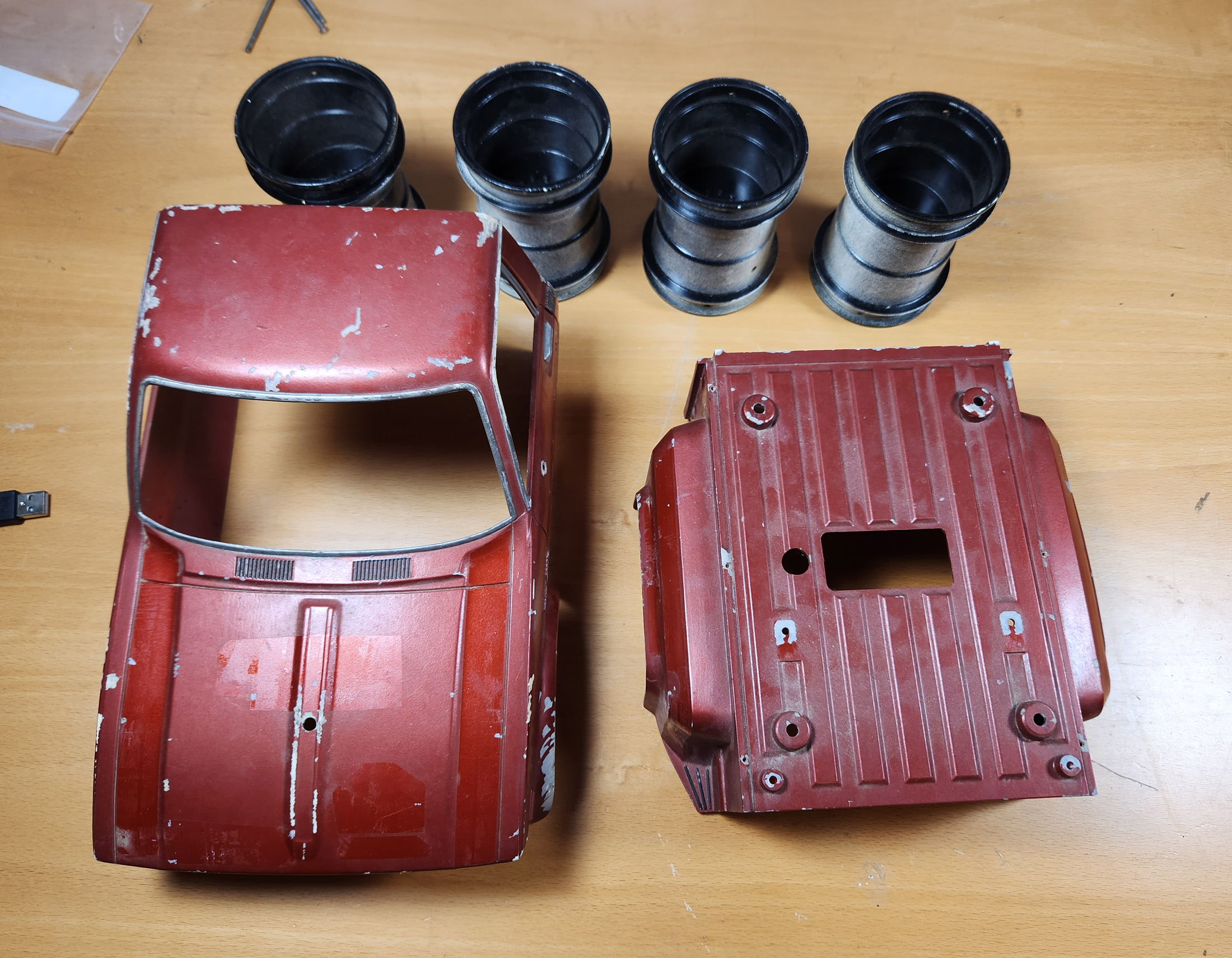

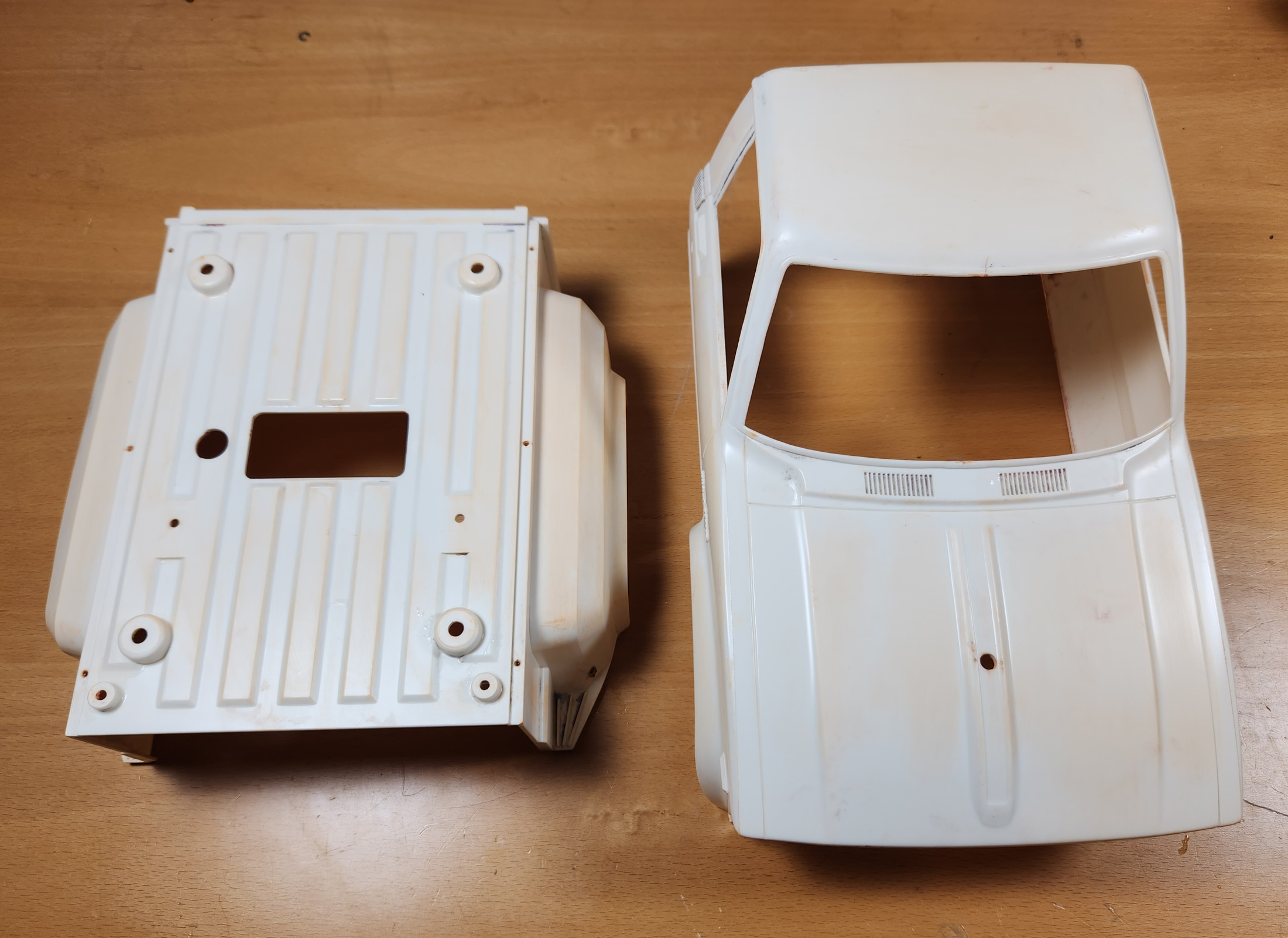

Then the part I was (am?) dreading the most, and that is the body. The old body was missing clips, scratched all over the place, and just looked like garbage. But, with Easy Off, brake fluid, printed and glued clips, filler, primer, and lots of sanding, it is getting close at this point. And of course, printed parts!!! I did not have a rear light bar for this rig at all, and it was hard to determine real scale and measurements with nothing to start with. I ended up finding simensays on Shapeways (who I randomly conversed with previously on TC), who had a design out there, but it was not available at the time. I made contact with him through TC, and he unlocked the design long enough for me to make an order, and that was now on the way. I also did not have side rails for the bed (why would anyone remove these????), and it wasn't until later that I realized simensays had these also on shapeways, but it was easier to just design and print myself. So that is where it stands today, still priming and filling and priming and filling and priming and filling. I am hoping to start actually laying some base coats in the next week or so.
