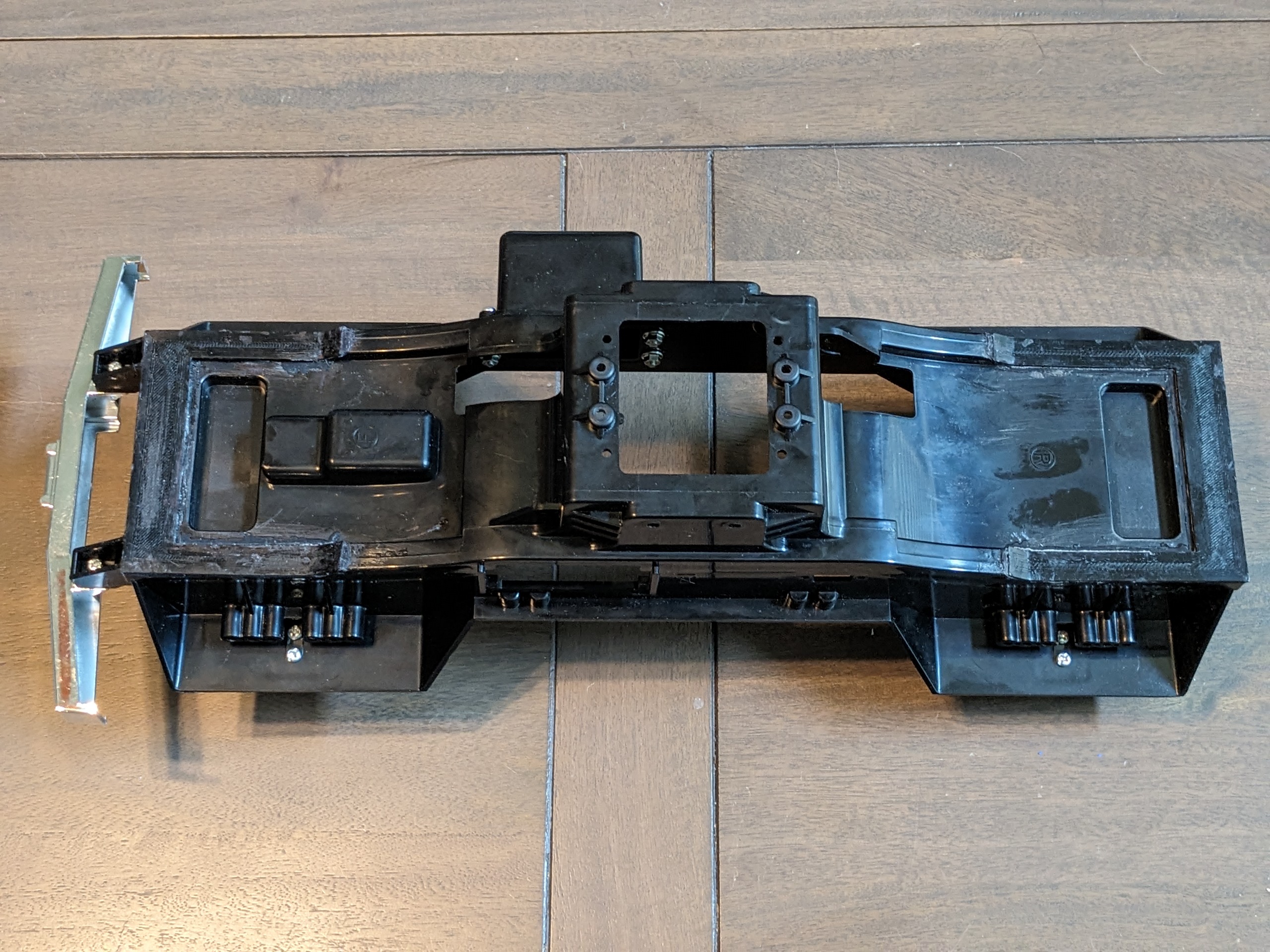

This is really terrible chassis clearance. Definitely time for a chassis hatchet job. That Time Warp chassis does look tempting, now that I've gotten a look at the lack of clearance. Tamiya really didn't do the Clod any favors with this chassis design.
I'm pretty sure stretching the wheelbase has created some of my chassis clearance issue.

Finished trimming the chassis and made some ABS blanking plugs.
Then added some gearbox servo mounts.
