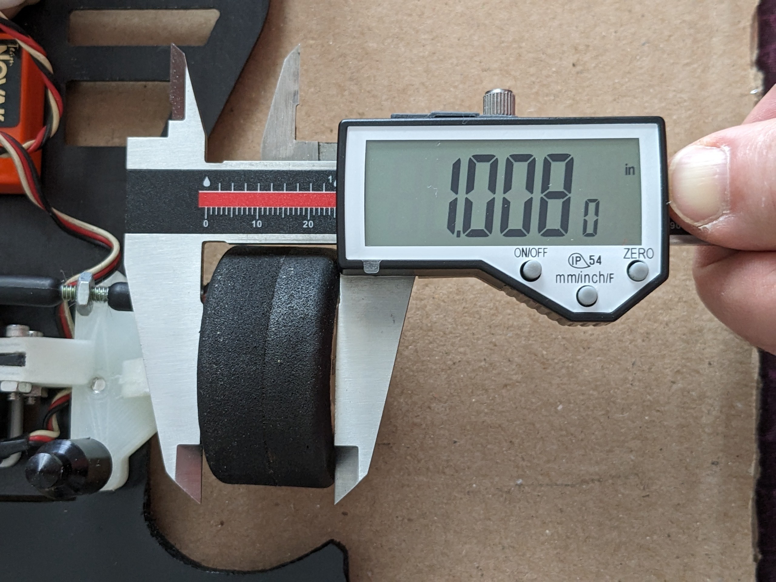

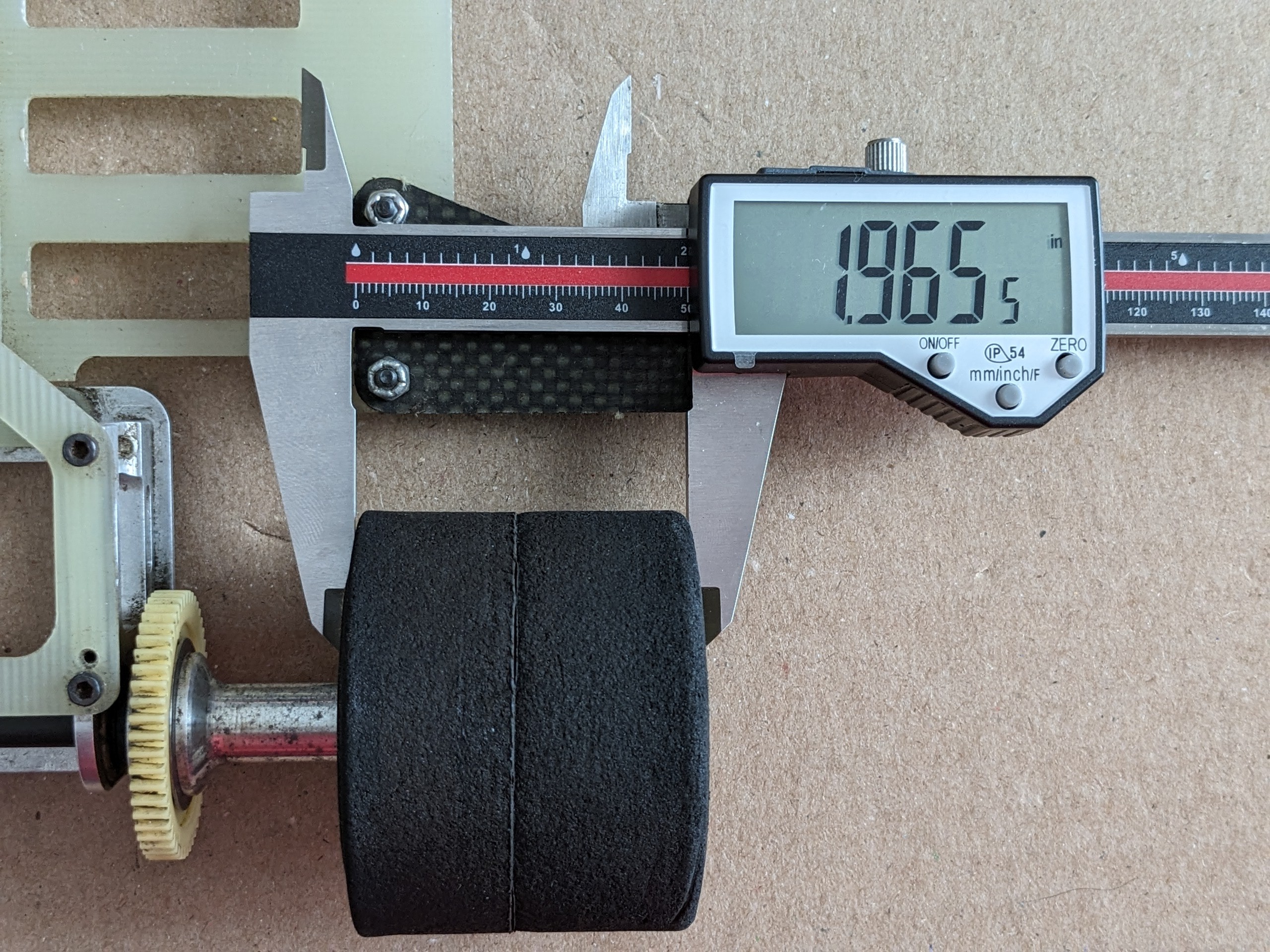

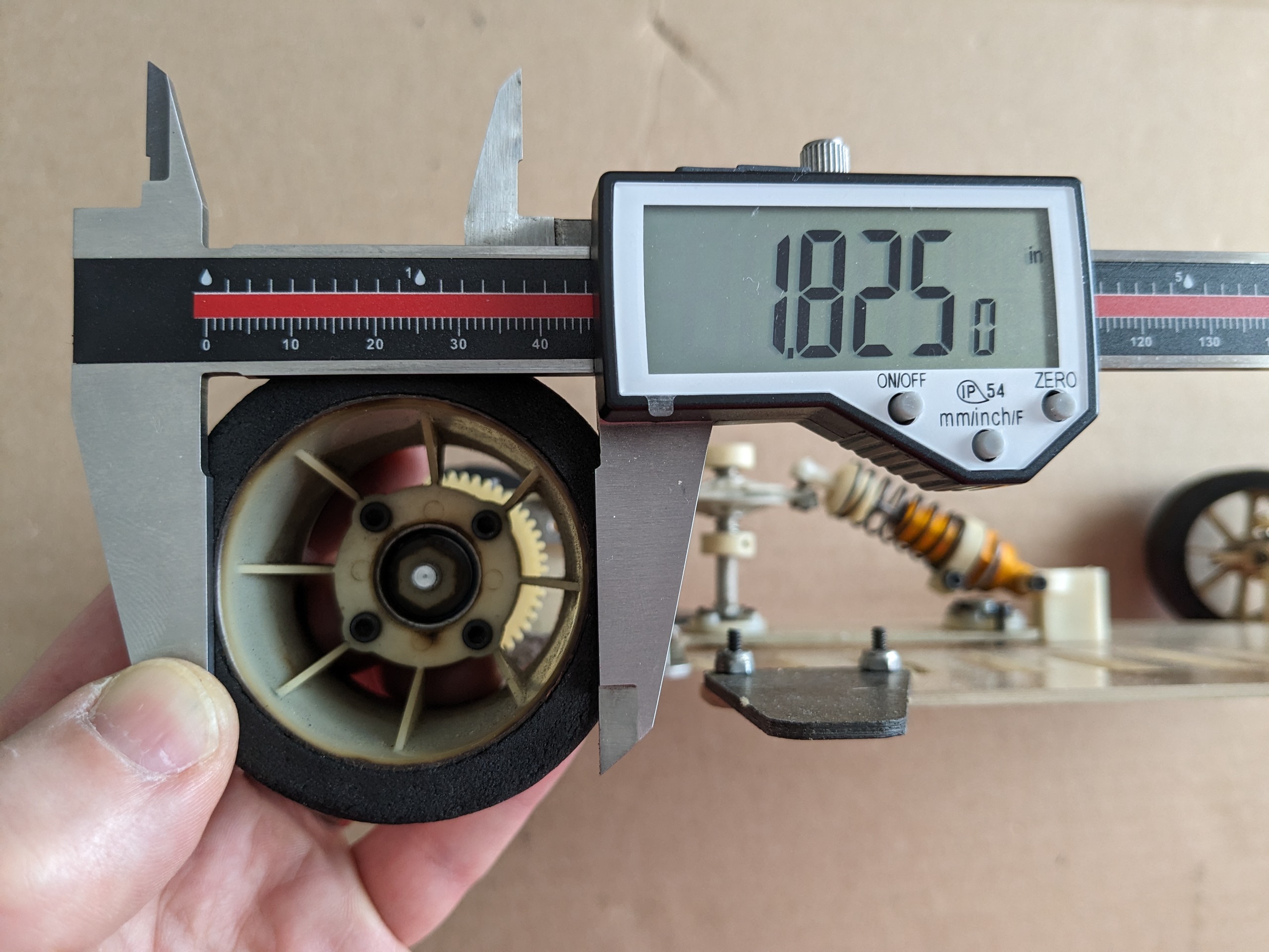

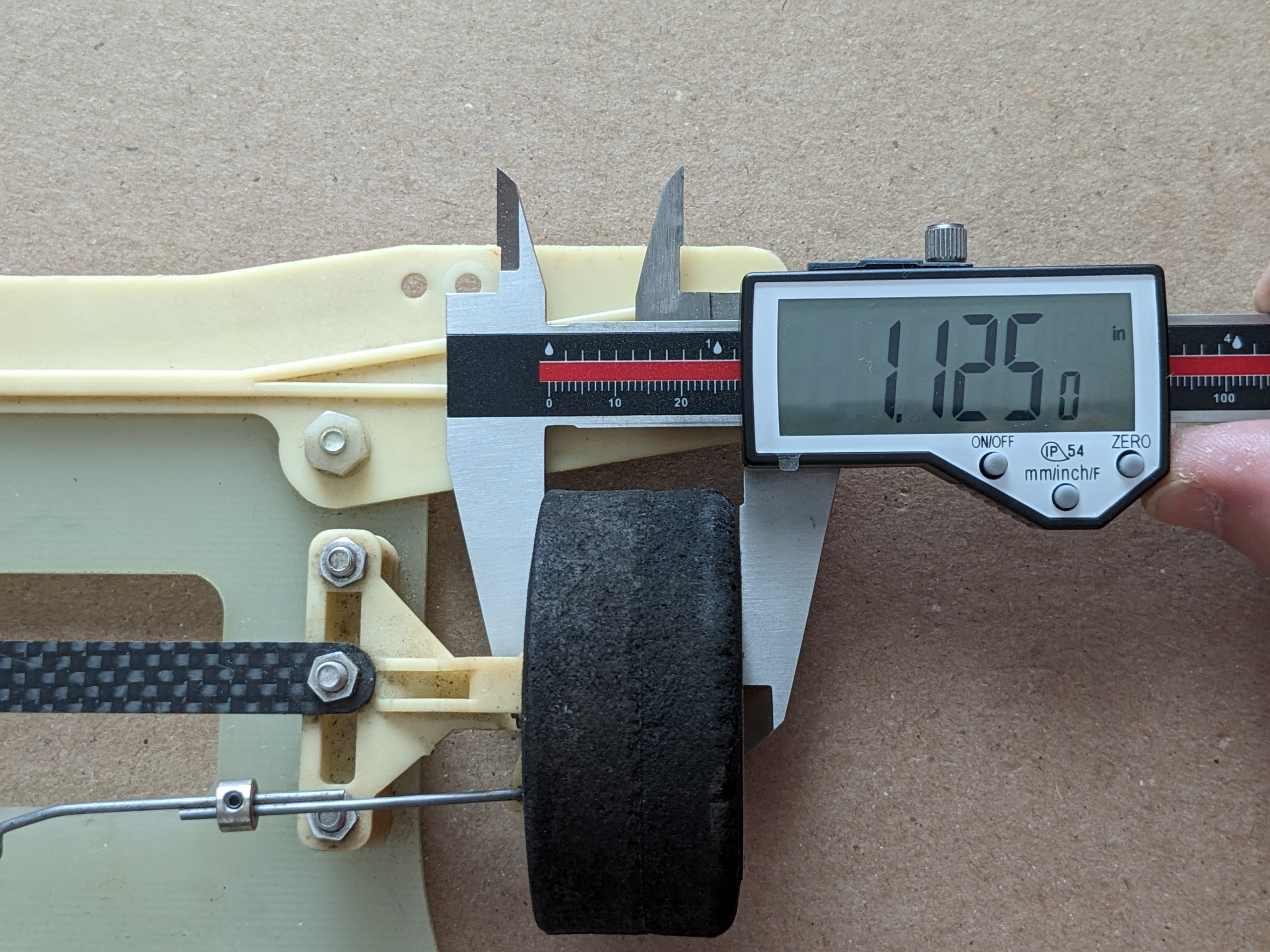

Posted: Mon Mar 18, 2024 3:46 pm
by Frankentruck
RC10L
RC12L (also RC12i)
