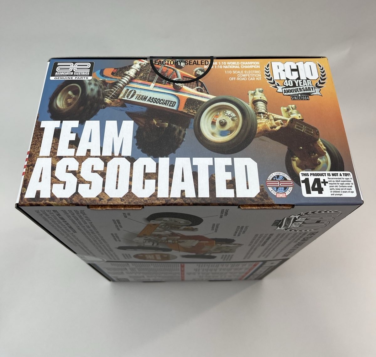

Box looks amazing, I really like how they did a matte finish to give it the classic vintage look.
#6007 RC10 40th Classic Kit
Made in Taiwan
Standard 'Factory Sealed' stickers (3)
Re: #6007 RC10 40th Classic Kit
Posted: Thu May 02, 2024 12:51 pm
by duckhead
"Genuine Parts" this is a new logo and indicative of AE's recognition of the vibrant aftermarket that has spawned in the wake of their absence :mrgreen:
Very cool embossed '40th Anniversary' logo. Obligatory 'Designed in the U.S.A.'
There is NO serial number present on the outside of the box...

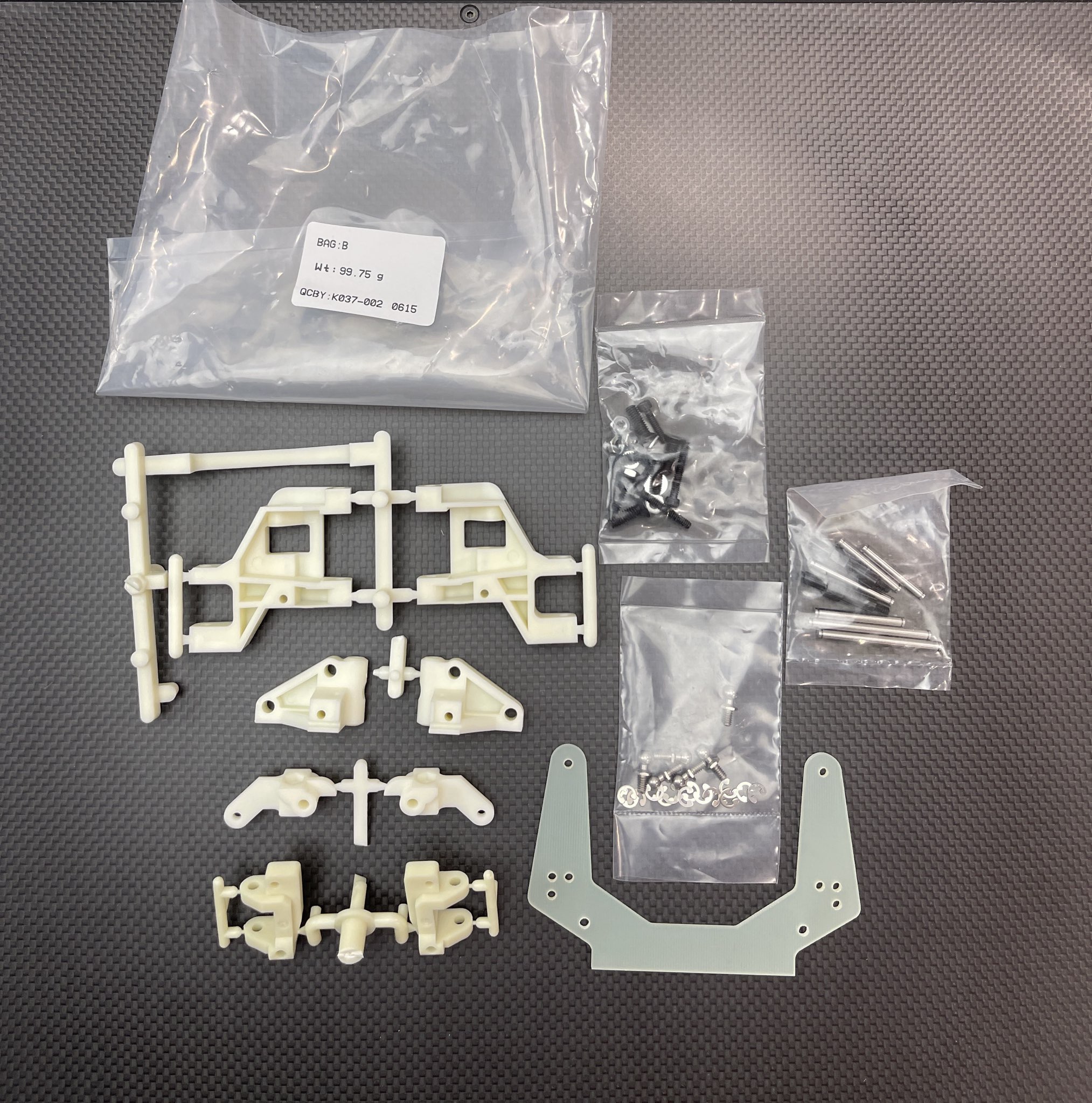

Bag 'B'
Contents of Bag 'B'

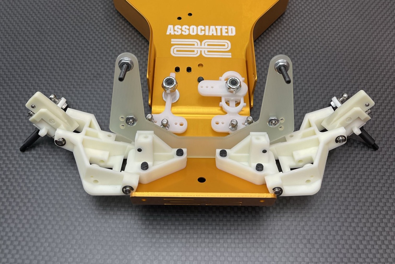

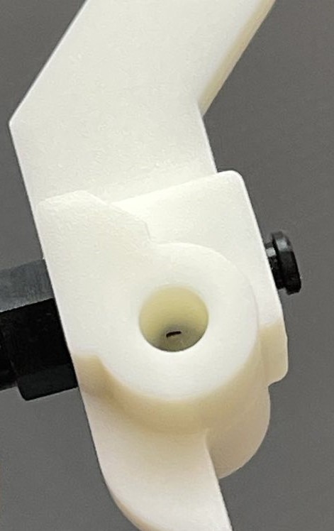

** Distinct color difference in front block carriers
Upon inspecting front block carriers they appear to be glass filled nylon where all other front parts are plain nylon. No idea if this is intentional for strength, but definitely does not look aesthetically appealing. The inside of the block carriers look to be a bit more relieved and thinner, curious if this was the driver for making them glassed filled. For a 'shelf queen' I would have liked to see consistency in the materials for all external nylon pieces. Frankly, this is a potential lost opportunity for AE to release 'hard' versions of these parts. Who knows, maybe that is on the radar 8)
Thin mold wall on steering blocks where axles intersect
Unique relieved chamfer on leading edge of front a-arms

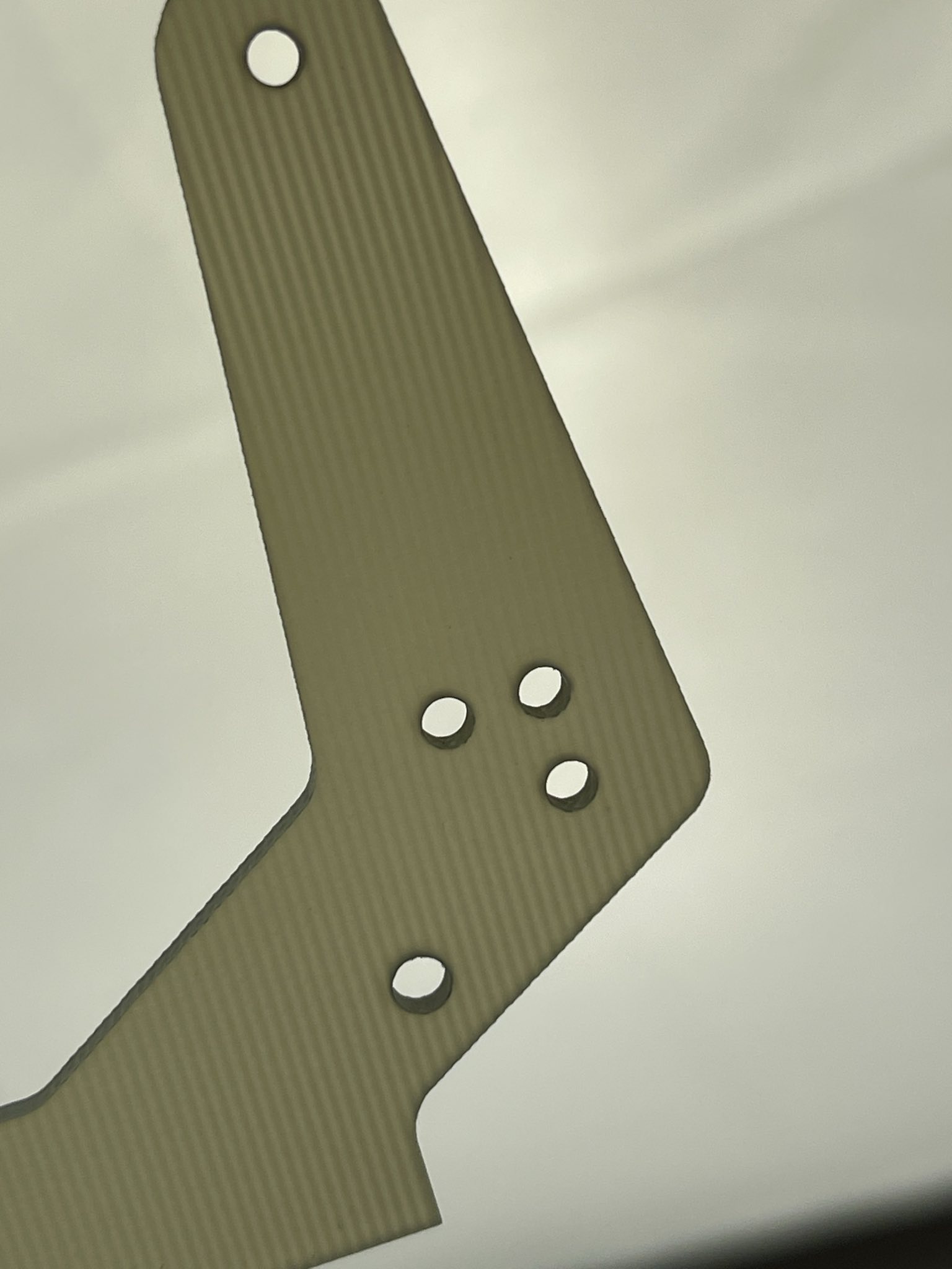

Good quality fiberglass with vintage looking weave, much better than the 2013 re-release.
Fit and finish is actually exceptionally nice, everything went together well and moves free but without excess slop. I am impressed :D
Stamped front nose plate!!! Absolutely wonderful!!!

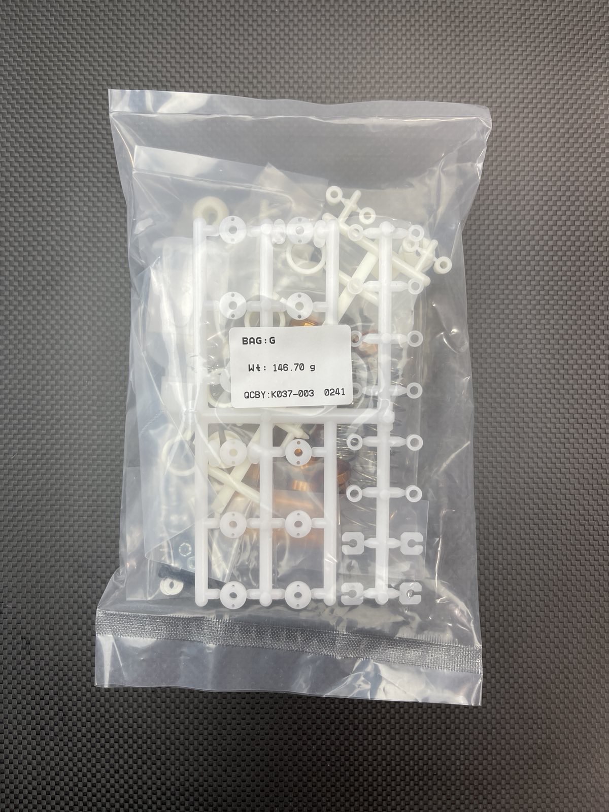

Bag 'G'
Contents of Bag 'G'
Completed shocks, fit and finish on the shocks is quite nice.

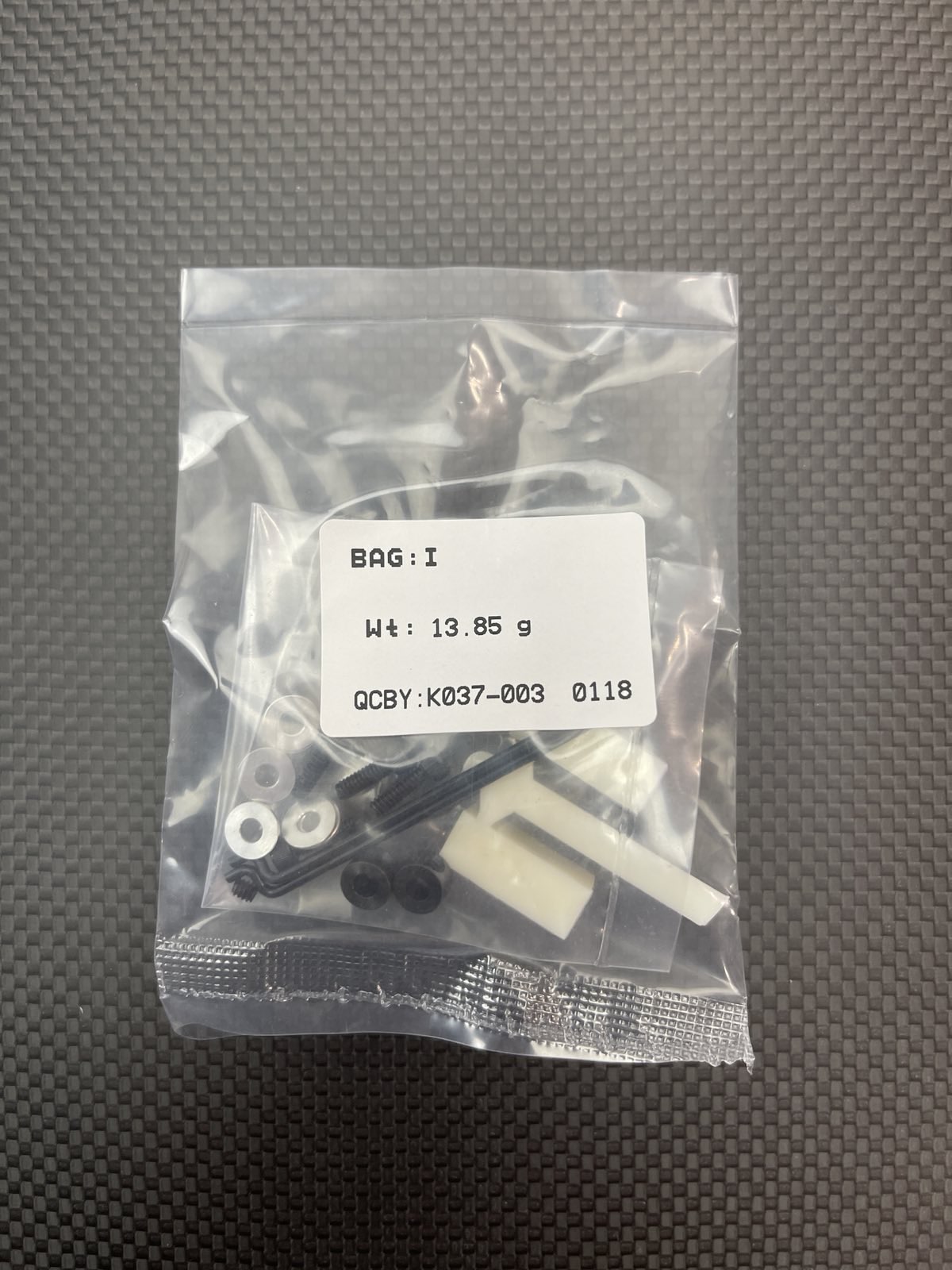

Bag 'I'
Contents of Bag 'I'
Similar gripe as Bag 'H', in my opinion AE should have included two (2) sets of servo mounts. In fact, just as a nod to the heritage and vintage nature of the kit a mechanical speed control would have been really neat.

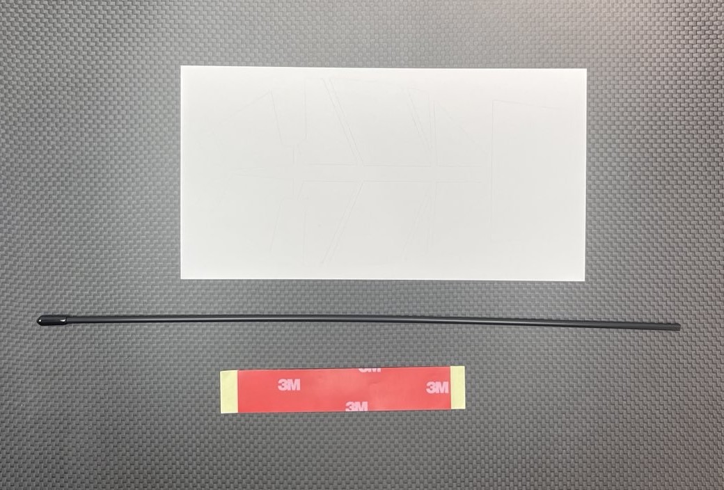

Unique 'RC10 40yr Classic Decal Sheet's
- Body window masks
- Antenna tube and cap (wish it was translucent white like the original)
- 3M double-sided tape
- Commemorative 'post card'.
Again, a missed opportunity. In my opinion this could have made a great candidate to pair with the chassis serial number. It could have been a 'Certificate of Authenticity' of sorts.

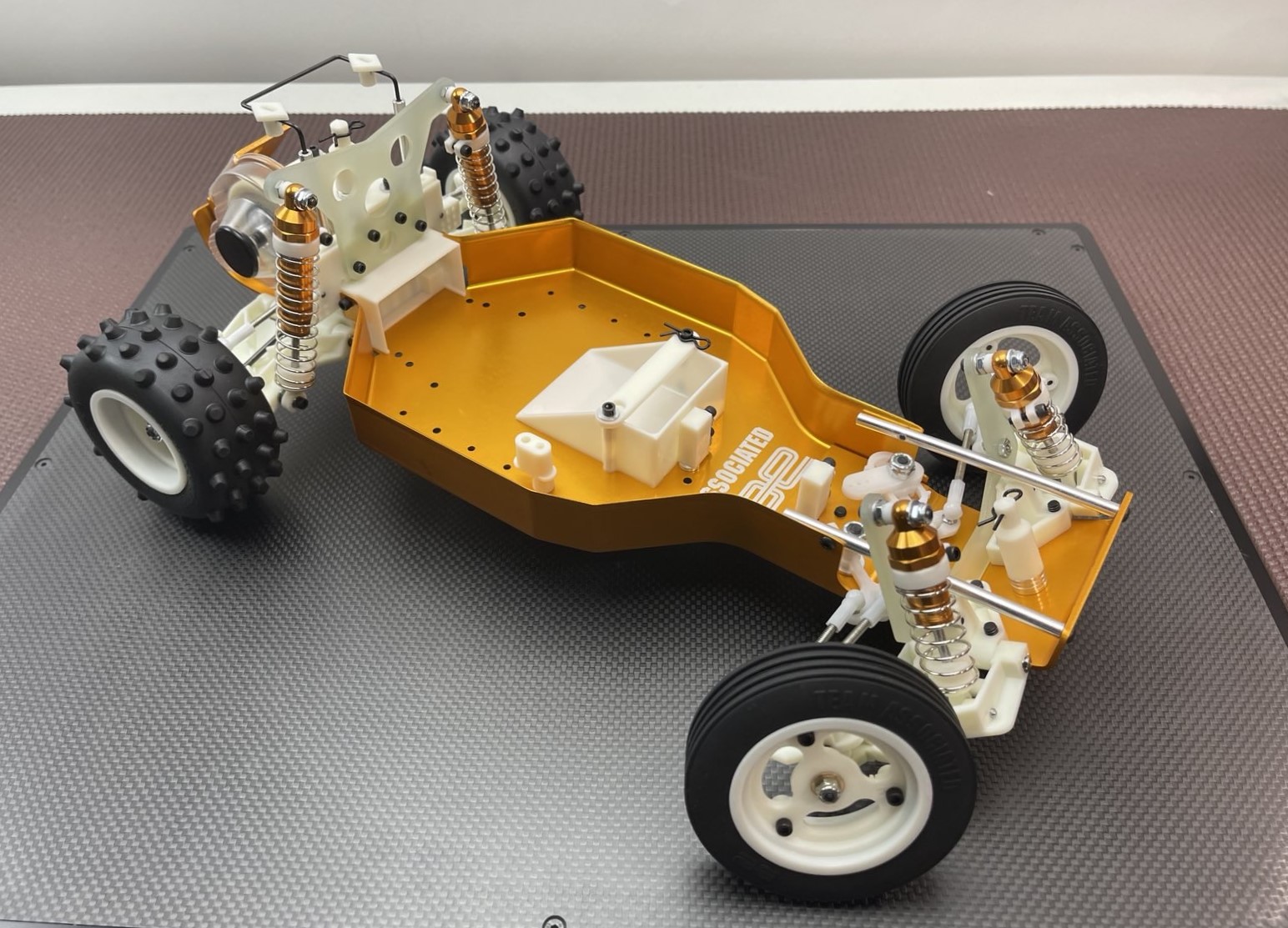

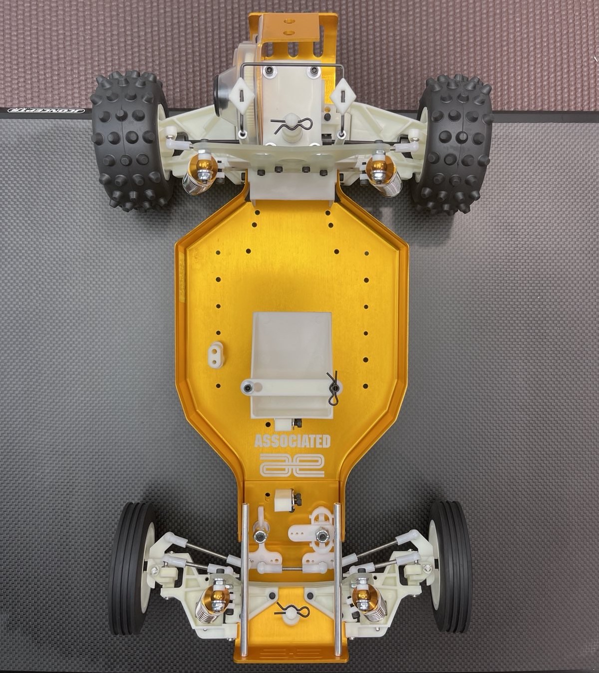

Chassis build complete! 8)
Initial thoughts about the build are extremely positive. Fit and finish on all the parts are exceptional, molding is nice, parts move freely but do not have excessive slop. I'd hazard to say this is the best re-release kit yet, not saying perfect by any means, but the best kit yet :mrgreen:

- Much better G10 fiberglass weave on the shock towers. The 2013 series of re-release kits and parts were junk.
