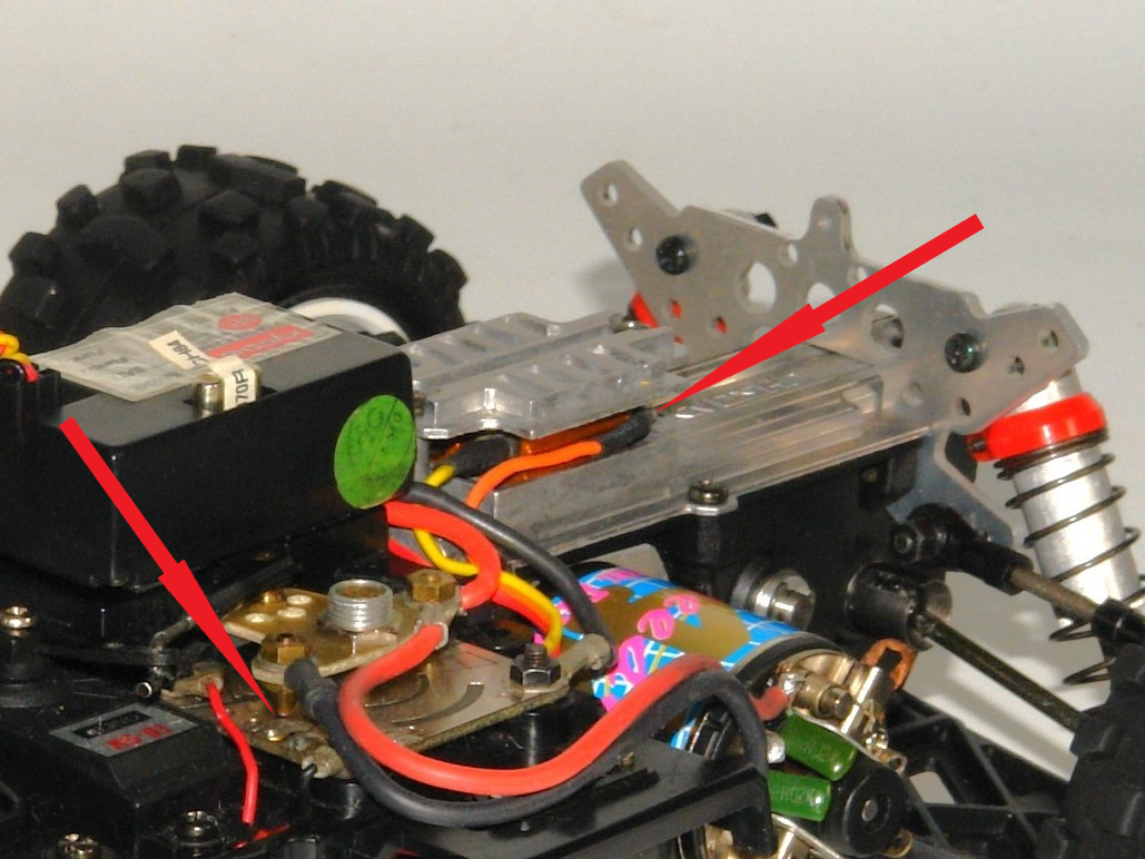

The motor's heat questions can be partially addressed by gearing.
I inexpensively modified 3 items on my Rocky.
1. I cleaned and polished the MSC printed circuit board with McGuire's polish.
2. I replaced the contacts on the MSC wiper arm.
3. I replaced the old broken ceramic resistors with higher wattage (10watt) aluminum resistors. Mounting tabs were removed.
I did use small pieces of heat sink thermal pads on top and bottom of resistors, any heat sink grease will work too.
The fit of the resistors was almost perfect, much better than the original ceramic resistors.
Chuck

Nice! Thanks! And thanks for the pics!
