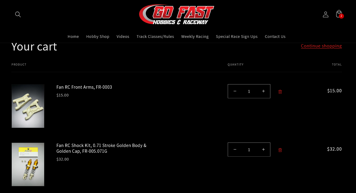

Honestly I would rather see someone buy the FanRC shocks and arms, they are cheap and work great.

Our shock tower for the front...
https://factoryworks.com/shop/ols/products/asc6231

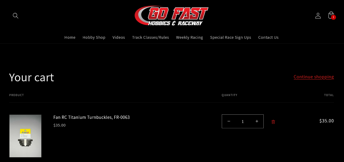

and the longer turnbuckles..
fanrc titanium are $35, a very nice upgrade but you could use anything from fully threaded rod cut to length to the AE part numbers listed if you want.
This would be IMO the cheapest and easiest way to go, and readily available.
